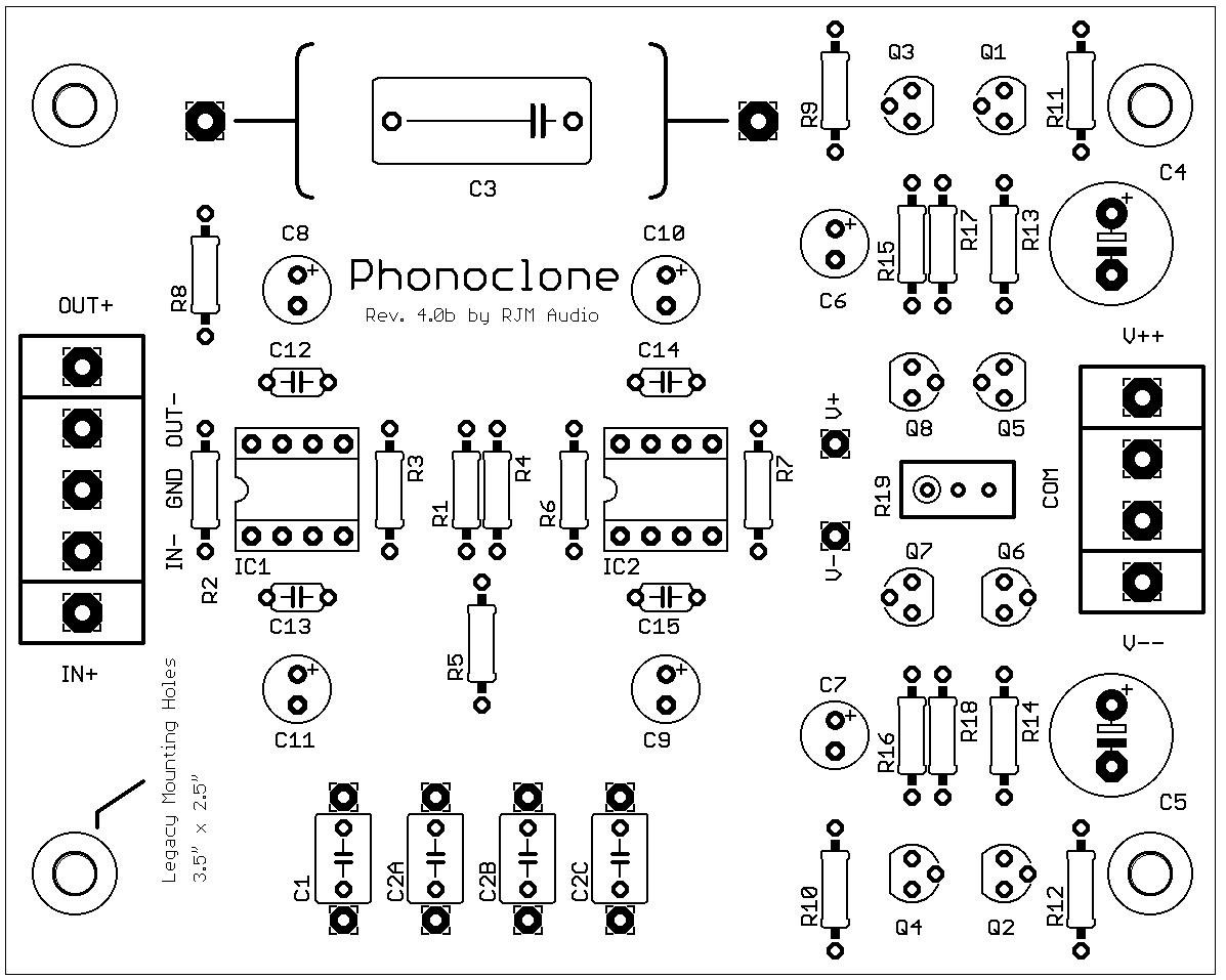

Quick report on the 4.0b hum issue:
I fixed it, but it required a fair bit of surgery on the grounding layout to get there. While it is no longer audible at normal volume levels the noise is present in measurements whereas the phonoclone3 had none. So there is still work to be done, and to be honest I don't have a 100% understanding of exactly what is going on. Yes the grounding connection is slightly less rigorous than the 3.5h boards - I made more use of the ground plane rather than separate connections - but I don't understand why such large noise currents are flowing though that particular small section of ground plane that a small ground loop into the output signal section should cause such a large amount of interference.
I'll have more to say in a bit, but if you read this and signed up for the 4.0b evaluation boards please come talk to me before you start building.

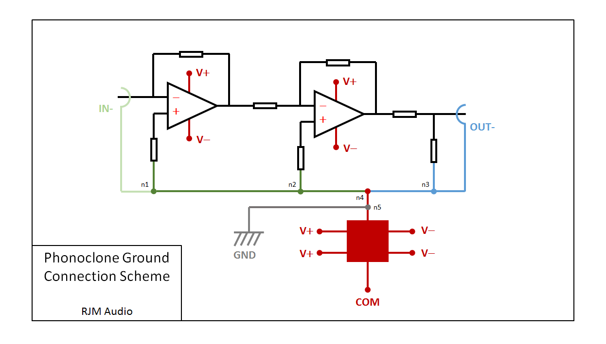

FYI this is how I have it connected up now, and how the phonoclone 3 is also wired. With the 4.0 boards as received, nodes n1~n5 were grouped into a small cluster and connected directly to the ground plane instead daisy-chained one to each other in order.
To my way of thinking the only point up for discussion is the connection n5 to the chassis GND. According to most textbooks it should be close to n1 instead, while in the phonoclone3 is was closer to COM.

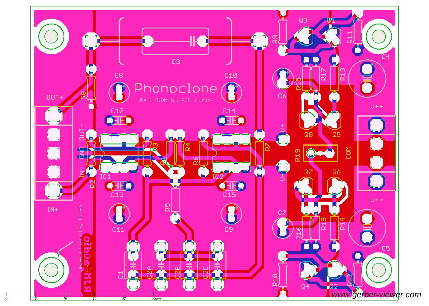

I think the loop areas may be your PCB problem.
Looking at n1 and the loop area to it's left.
That input loop area can be made very small by bringing the TWO WIRE input to the opamp as a twisted pair that becomes a pair of overlaid traces.
If instead you take n1 to some remote location you have INCREASED the loop area because you have SEPARATED the two wires of the input connection.
Move onto n2. Again the loop area of the two wire connection to it's left must be minimised. taking n2 to some remote location INCREASES loop area.
You must think through each two wire connection and minimise the loop area.

If that were true ... I'd I'm not suggesting it isn't, I'm just trying to think things through here ... if that were true wouldn't the original design where the IN- signal dropped directly into a ground plane which covered the IN+ trace right up to the op amp input have worked nicely, since it had minimal loop area?
Instead I'm getting a better result with all the ground traces pulled out of the ground plane, connected back into it at a single point.
I mean I think you are basically on to something here: the residual problem seems to be over-air pickup into the input from the power supply, and therefore relates to shielding, length, placement, and loop area of the input wires and input traces... I'm just at a loss to explain why it's such a mess this time around where the Phonoclone 3 worked nicely in the same case etc. with no great concern for loop area etc.

So where we are currently:
Output noise is about 2.5 mV p-p in one channel, 4 mV p-p in the other. The larger noise is associated with the board furthest away from the I/O, with longer internal connecting wires. The noise is 120 Hz fundamental, with a triangular shape characteristic of the shunt/charging currents flowing through most sections of the S-Reg circuit. (confirmed via LTSpice.)
The V+ and V- voltages are noise free. Galling as it is to admit, the power rails of the phonoclone 4 have less noise on them than the output, I kid you not. In itself the S-Reg works just fine.
Changing the gain of the phonoclone changes the output noise in proportion. No surprise there, but it proves that the noise pickup is in the input stage.
All my tinkering about with the ground layout and connections has not made a great difference, to be honest, though I would say it's a definite improvement the order is about 2~3x rather than order of magnitude level.
So my operating theory is that while the input section is a nice little receiver, the main problem is the S-Reg I've put together is an unusually nice little noise generator. Why that might be is what I will be looking at next.
From what I can see the placement of R9,10 are less than ideal. The should be the other side of the transistors next to R11,12. Nothing else jumps out. (R9,10 were moved from their original position to ease crowding near the main filter cap, and later mods removed the direct return path of the ground plane. When I moved them I was no longer thinking about why I had put them where I did in the first place. Happens...)
No I haven't. Why do you think it would be a good idea to bring the returns back to the noisy side of the regulator?
I was thinking connecting everything to 0 on a pure star ground to eliminate the possibility of issues with the ground plane connections and holes.
Perhaps on the regulated 0 then.
I also feel a bit weird that the input and output return currents move on the same path on the ground plane (mixing high-low current and voltage returns).

The boards have much less noise sitting on the bench with a 47 ohm resistor across the inputs than they do in the case wired up with a 47 ohm dummy load over the RCA jacks.
I tried moving R9,10 to take the returns directly to the filter caps, but it made no difference.
It's all to do with the chassis.
If the chassis connection is taken at COM where it connects to the XLR jack, the noise is huge. If the connection is made at IN- at the RCA jacks it is lower but still more than when the connection is made at or near n4.
Moving the input and output wires around does not change anything.
In short it behaves more-or-less like I would expect on the assumption of massive amounts of noise currents generated by the voltage regulation section and coupled into the chassis and then back into the board's input stages. I just don't understand why it's become such an issue with these new boards when it wasn't before.

Progress.
Removed the input wires, replaced with a dummy 47 ohm resistor connected at the board input. Ripple noise drops by half, almost invisible in the broadband noise now.
RMS value of the output noise is 0.4 - 0.5 mV, the outer board still being very slight more noisy. Just twisting the dummy load 90 degrees changes the amount of output noise slightly. The position of the chassis ground connection no longer has a big influence. As configured I calculate the broadband noise from the op amps should total about 0.3 mV. So we are really close now to being home free.
Of course I don't have the boards connected to the input RCA anymore, so that's a problem... but after working though a couple of dozen mods and changes the boards are pretty much wrecked anyway. So what I want to do is strip the case and start over from scratch using shielded wiring and fastidious construction.
For those of you with boards ... as far as I can tell the boards as shipped are not flawed. None of my mods that supposedly "improved" on the grounding layout did anything substantial, only removing the input wires drastically changed the situation. I suggest giving it a shot and see how it goes.
