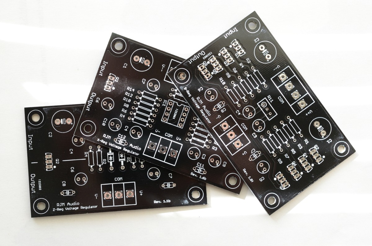

In fairness I thought I should throw out the regulator deal to anyone who might be interested,
1 ea. of the S, X, and Z reg boards for $15 US.
Since almost all my projects have regulators built in to the boards already these regulators are expected to be used for other things, though you can defeat the on board regulation on the VSPS and Phonoclone boards to try these out - its not too hard if you know what you are doing.

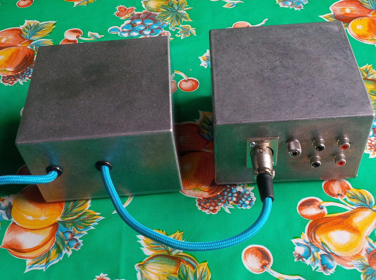

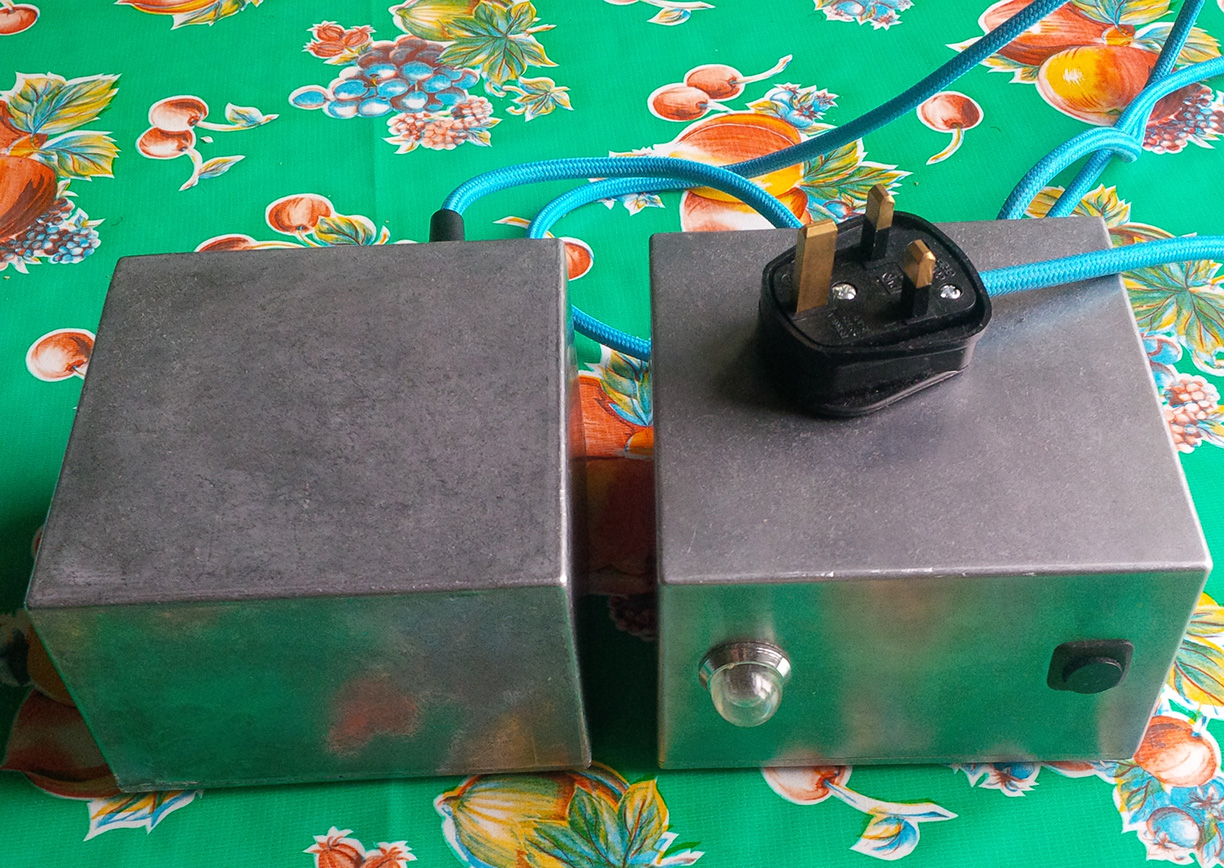

I had some fun with my VSPS by putting it in some industrial looking boxes with a big lamp and a cable that matches the blue amplifier I repaired for a friend.
Sweet! I love the steam-punk styling.
I thought "steampunk" involved hot-glueing screws and watch parts to the outer surfaces?
Kaidanovsky's construction methods - minus the blue cable - is what almost all my builds look like, thanks to the Hammondmfg 1590 series.
