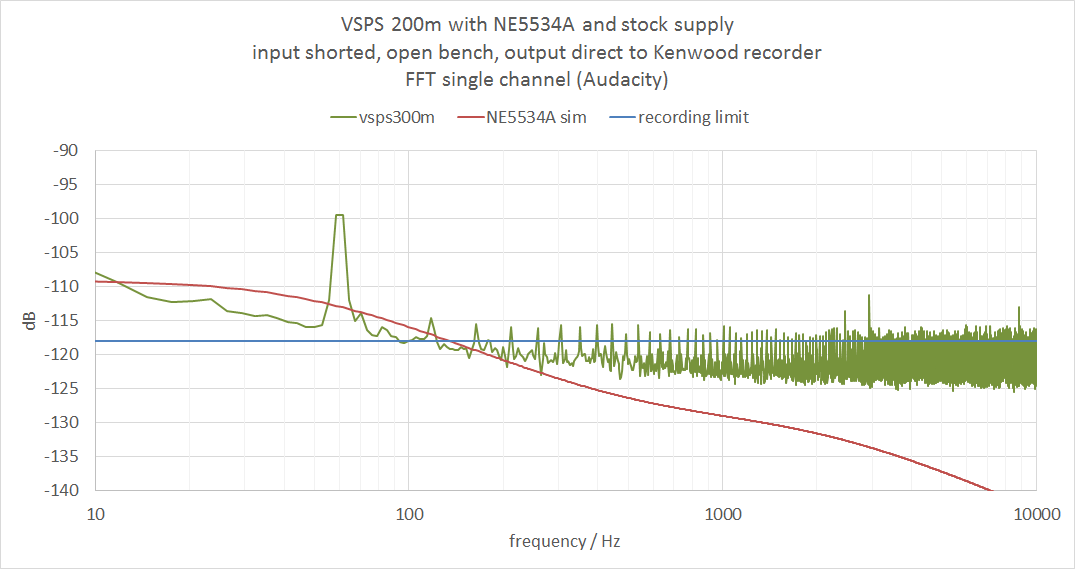

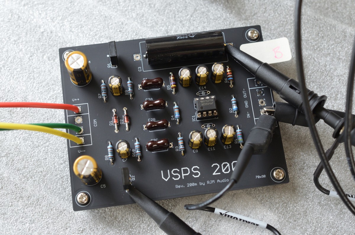

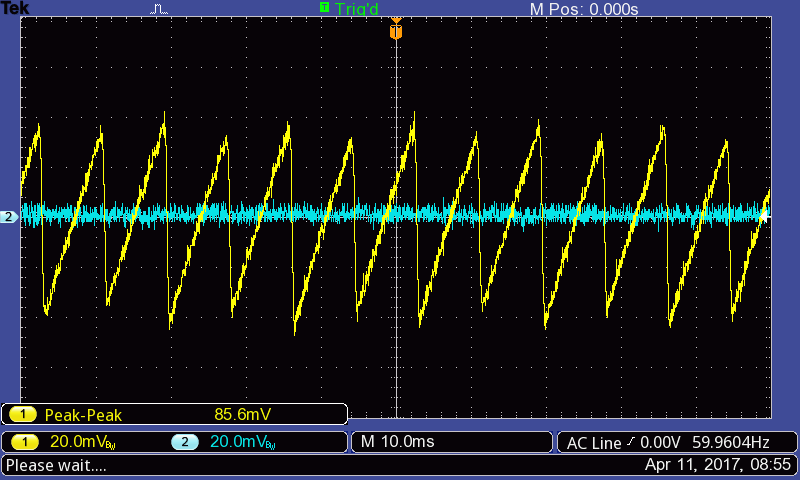

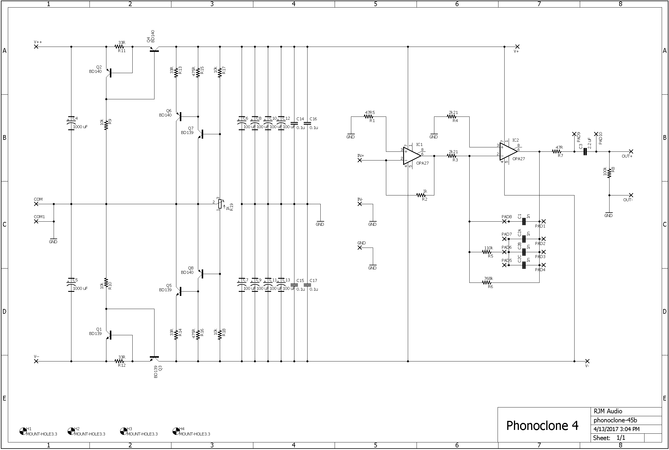

vsps200m passes the usual tests with no issues
the Z-reg works properly with no ripple detected in the output or on the voltage rails
(The measurement sensitivity is not as high as with the phonoclone measurements earlier, this is just a open bench test, but the absence of 120 Hz ripple as was seen with the phonoclone 4 can be confirmed)
scope trace screencap shows V-- in yellow with the expected 80 mV p-p ripple and clean V- in blue.

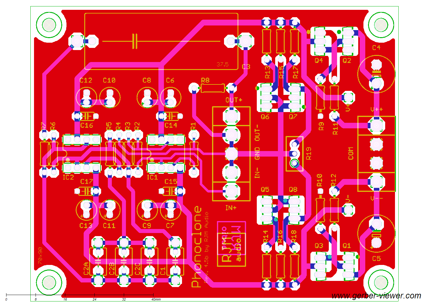

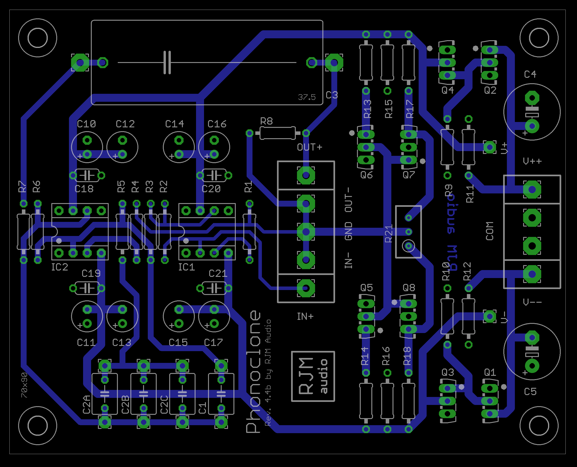

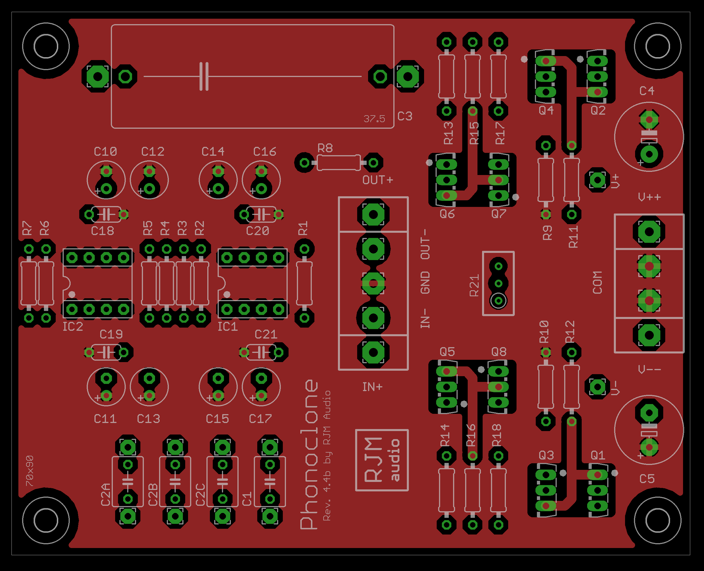

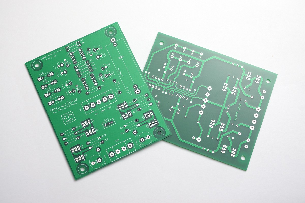

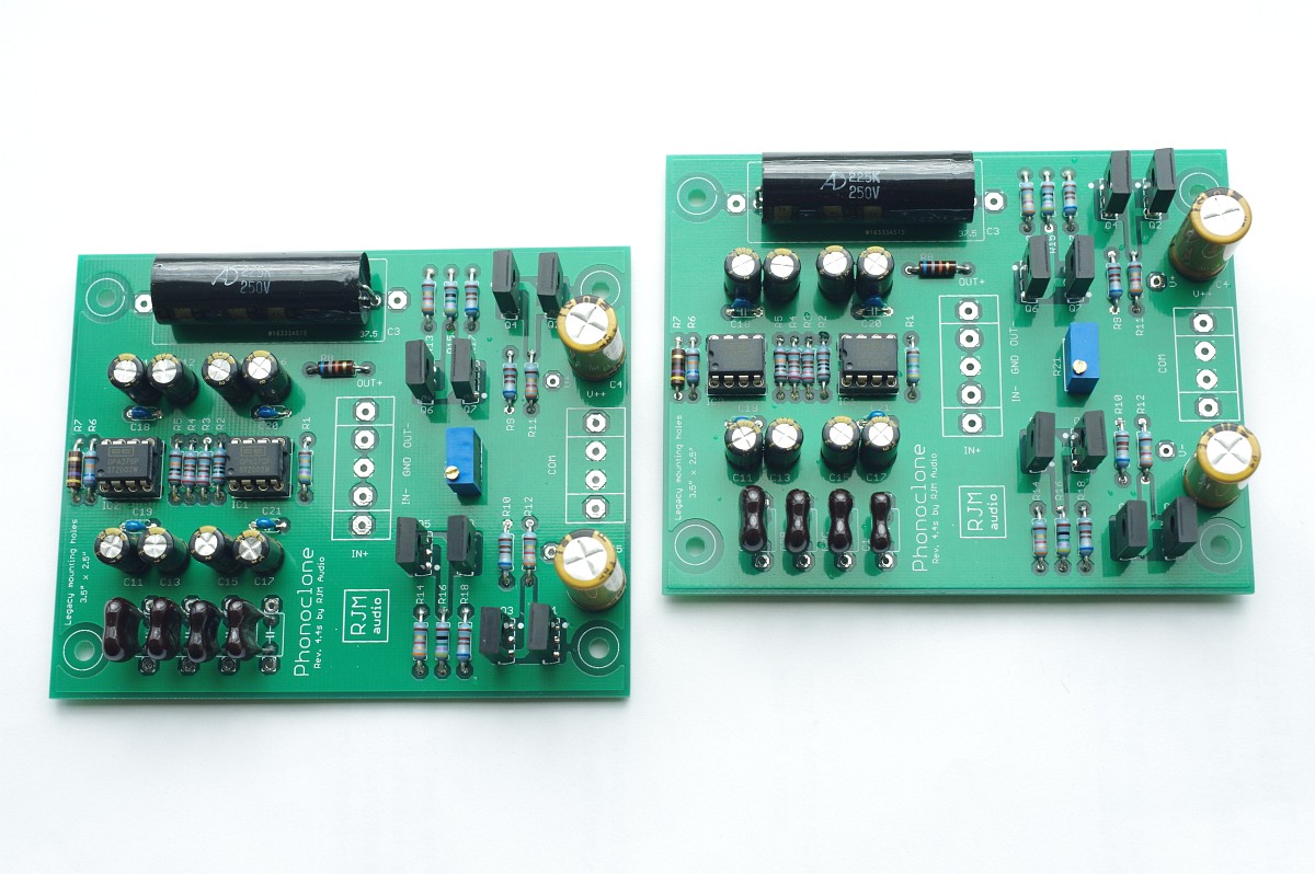

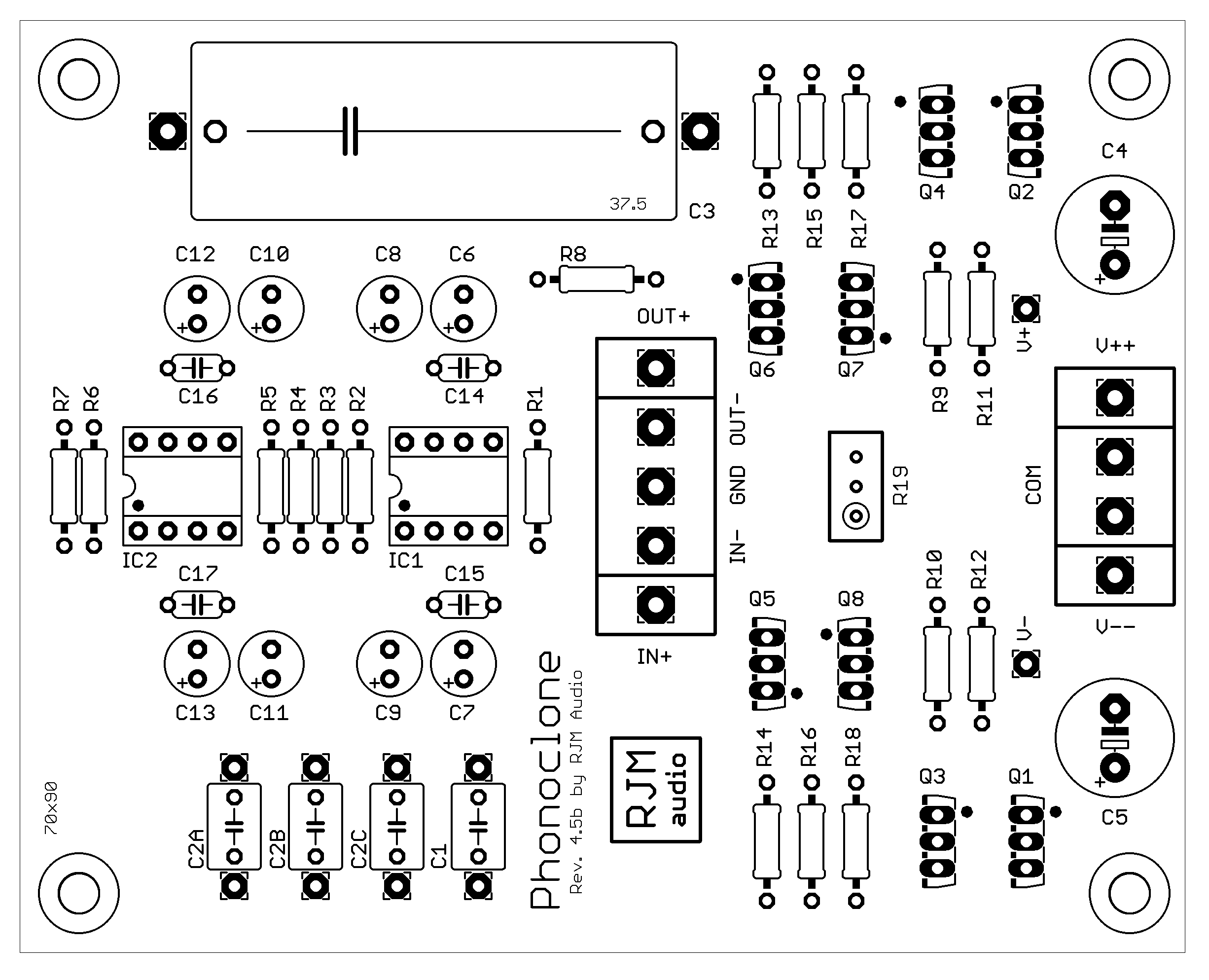

continuing my Quixotic quest for a better phonoclone 4 layout...
4.4b brings all the signal traces to the bottom, all protected by a ground plane.
I had to reduce the trace width to fit everything under the IC however.

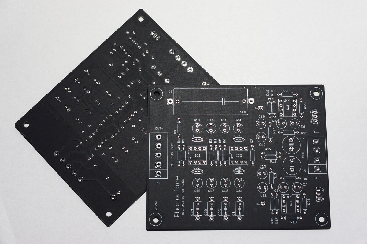

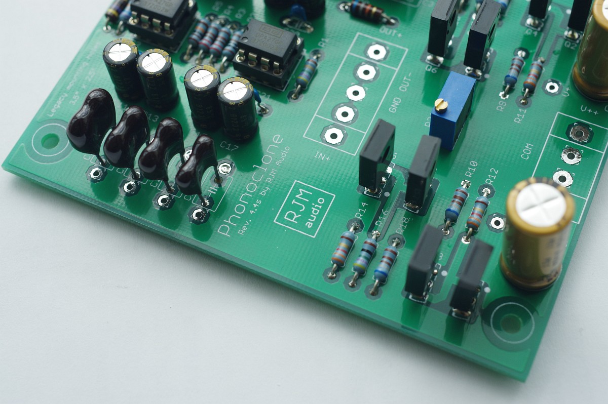

Phonoclone 4.4s
"s" denotes an out-of-series, once-off version. This is basically a big vanity project / moonshot / experiment to see if the board layout has any influence on the ripple component in the output signal.
I got 10 boards made at pcbway for all of $21 shipped so not a huge investment on my part. Crazy I know... it's actually cheaper to order 10 pcs twice than 20 pcs at once which doesn't make a whole lot of sense to me but whatever they feel works for them I guess. Quality somewhat behind e.g. the usual black ones like the PC3.8a above but for prototypes or for personal-use projects like this it's great!
Moonshot - achieved! 😀😀😀
I don't what was wrong with the 4.0b layout, but whatever was wrong there was righted on phonoclone 4.4s. I guess I got careless... somewhere. Being 100% rigorous on the ground connection order and keeping the power rails located as far away from sensitive signal traces paid off at any rate.
I have 4 sets of 4.4s prototypes left which I will send to the people who ordered 4.0b from me. If there are any unclaimed they will be available to anyone curious.
I posted all the 4.4s boards today, to earsandeyes, rsritchey and a couple of other people. The Phonoclone 4 will continue however as 4.5b with the 70x90 mounting holes. Details attached. (its barely changed from 4.4, mounting holes moved and some parts got renumbered...)

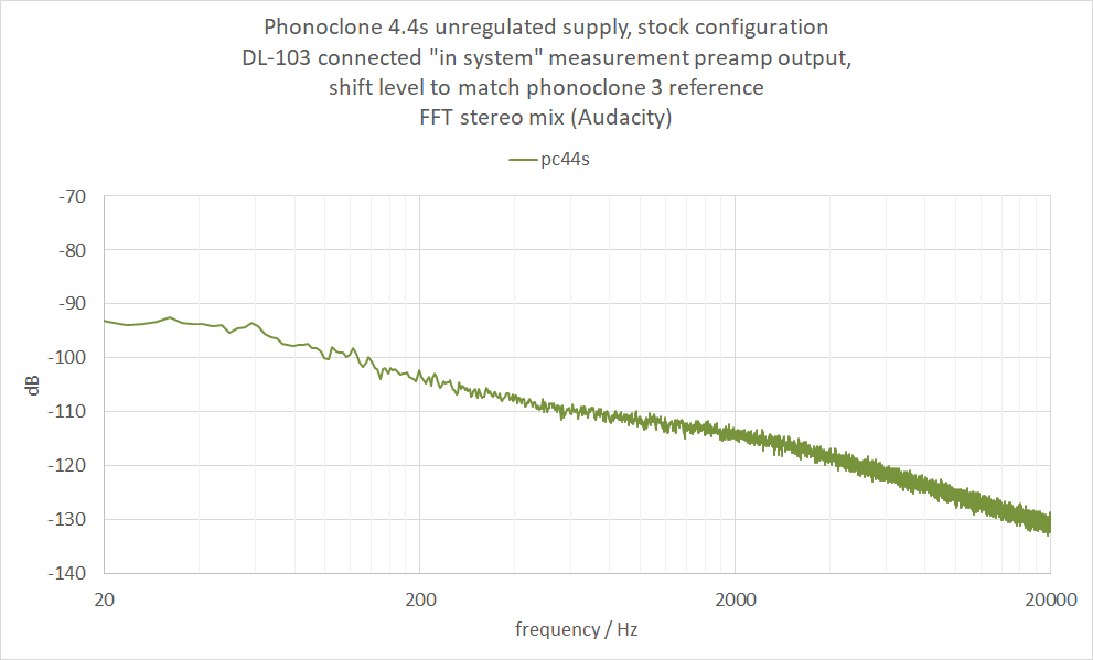

My 4.4s does not sound very different, if at all, from the 4.0b build, which in itself very near to the CrystalFET. It might seem weird that the JFET stage and the IC circuit should sound similar, but remember they have pretty much identical shunt-source voltage regulation so that might likely have something to do with it. Maybe the CrystalFET is smoother and rounder, the phonoclone 4 a tad more dynamic, but its anyways close.
Compared to the Phonoclone 3 the 4 sounds quieter and more deliberate. Less sparkly and more solid. I prefer it, personally, as I like that lower midrange weight. Others might prefer an emphasis elsewhere.

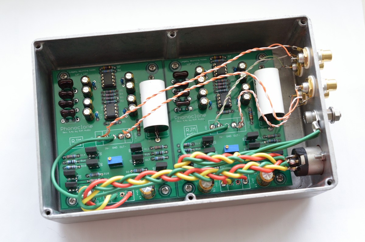

PhonoClone 3.5h again
Thanks Richard,
Got a nice surprise in the post today! A 4.4s Limited Edition 😉
Just recently finished a second 3.5h using LCR capacitors for C1,2 and 3, also tried the IC2 with AD797's, image seemed a bit indistinct to me, so return the OPA27 and things fell back into place. Only my view of course and may have been due to build issues etc.
Not much, if any difference but preferred the original.
I had thought I was finished 'messing about' 🙂 .....

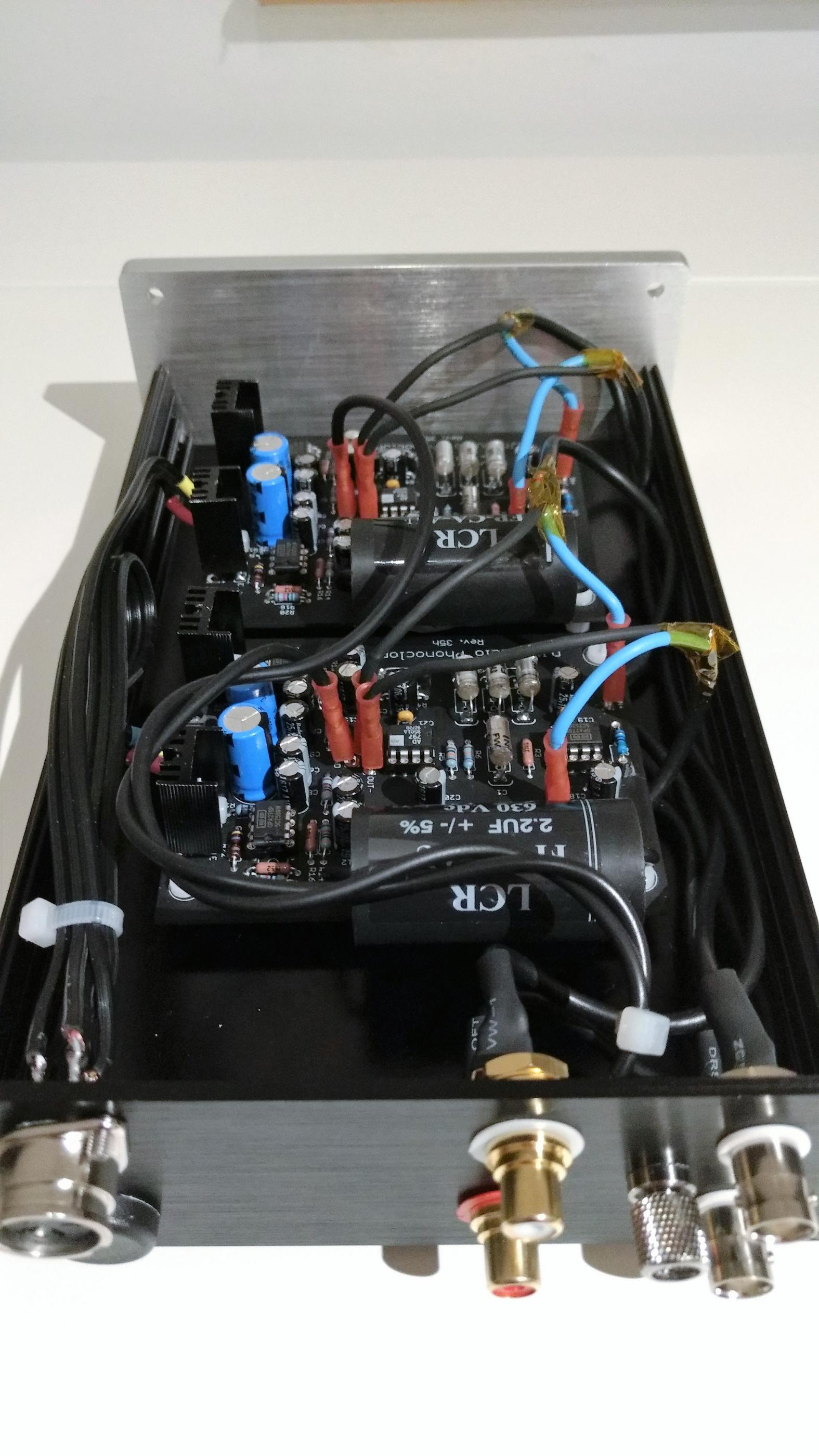

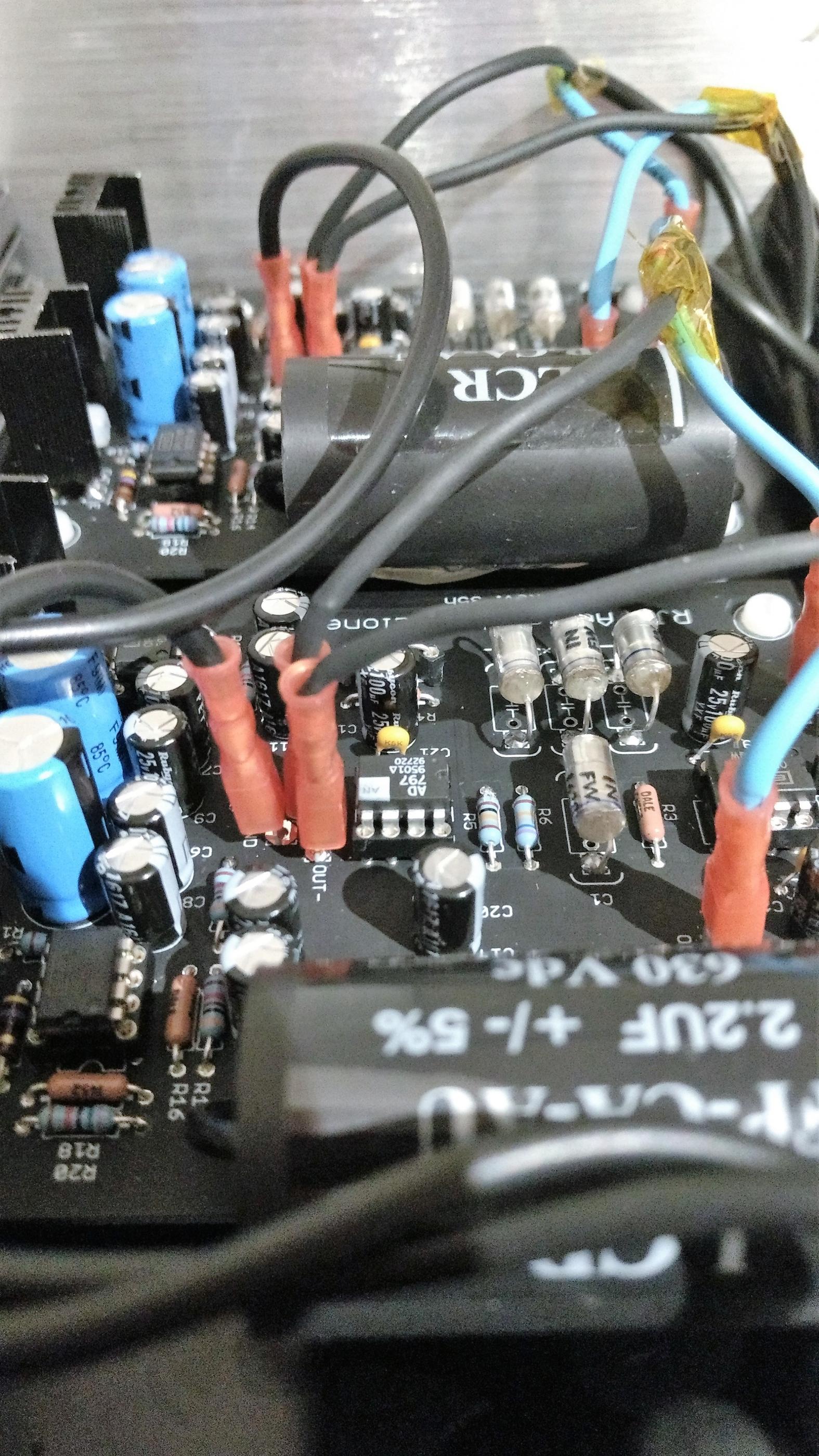

Attached are pictures of the second build - soon to be decommissioned!

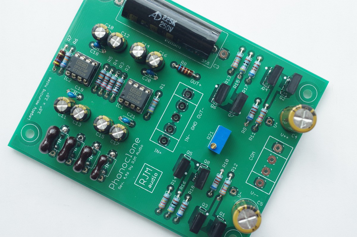

When complete they should look something like this:
(please take care to notice the electrolytics are flipped 180 degrees with the negative terminal pointing notional "up")
