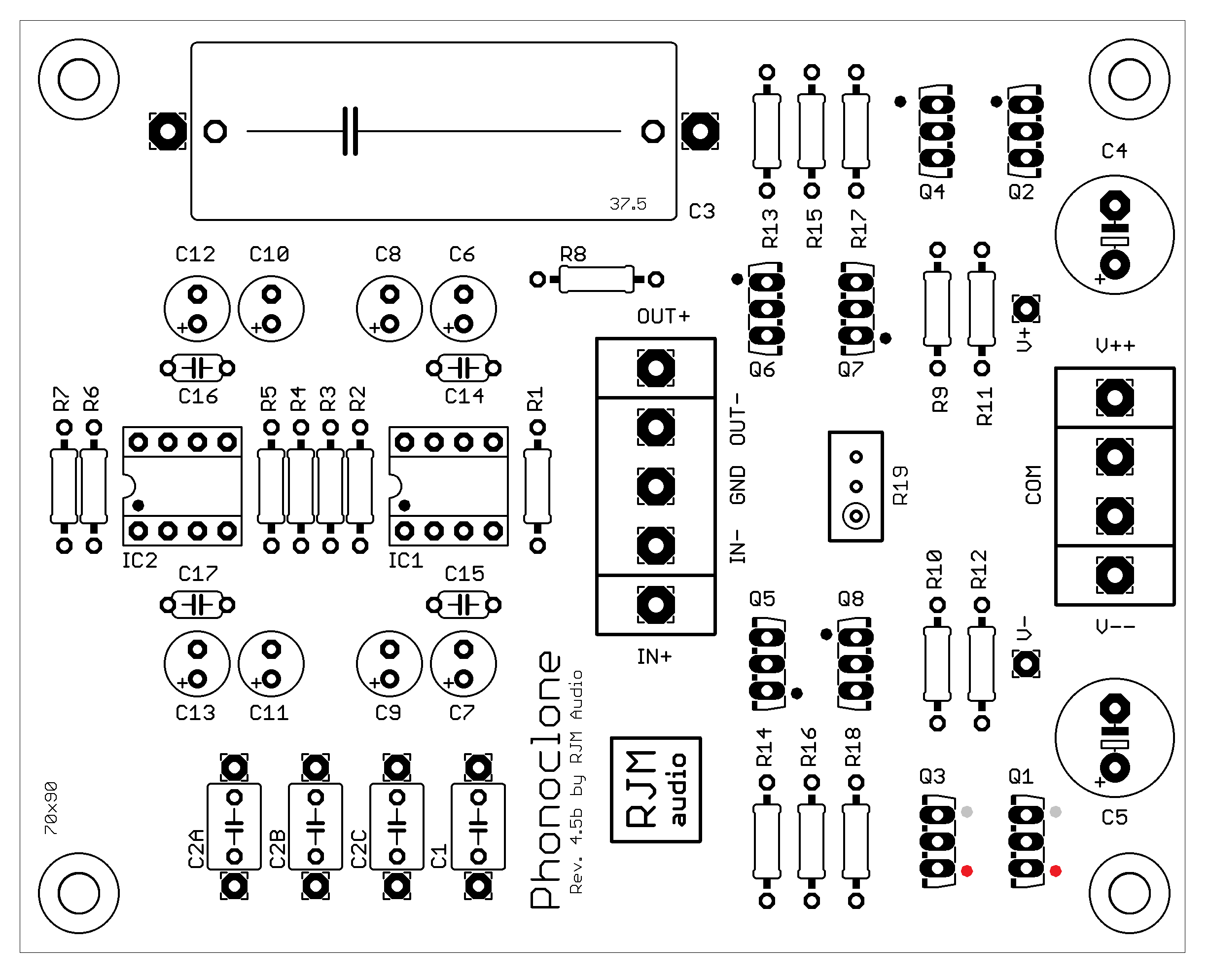

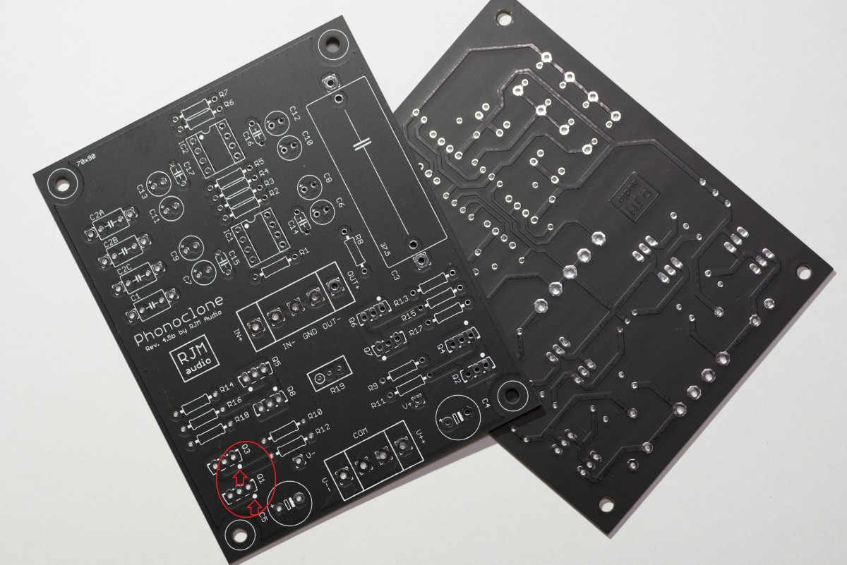

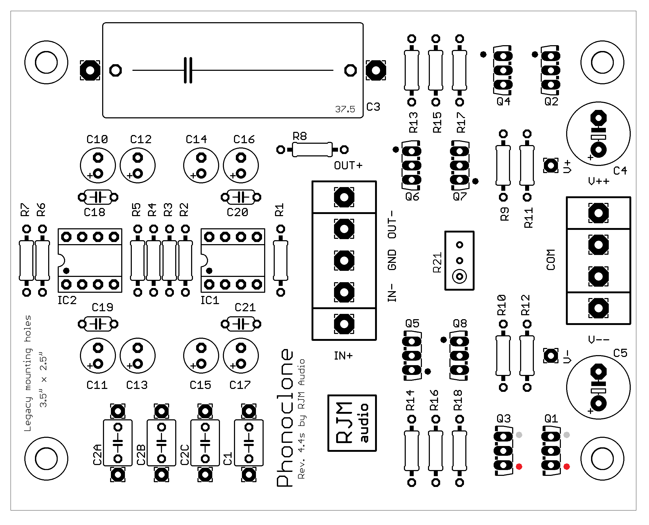

On phonoclone 4.4s and 4.5b board the white dots of Q1 and Q3 are incorrectly placed next to pin 3 instead of pin 1. BOM and board images have been edited to show the error and correct position.

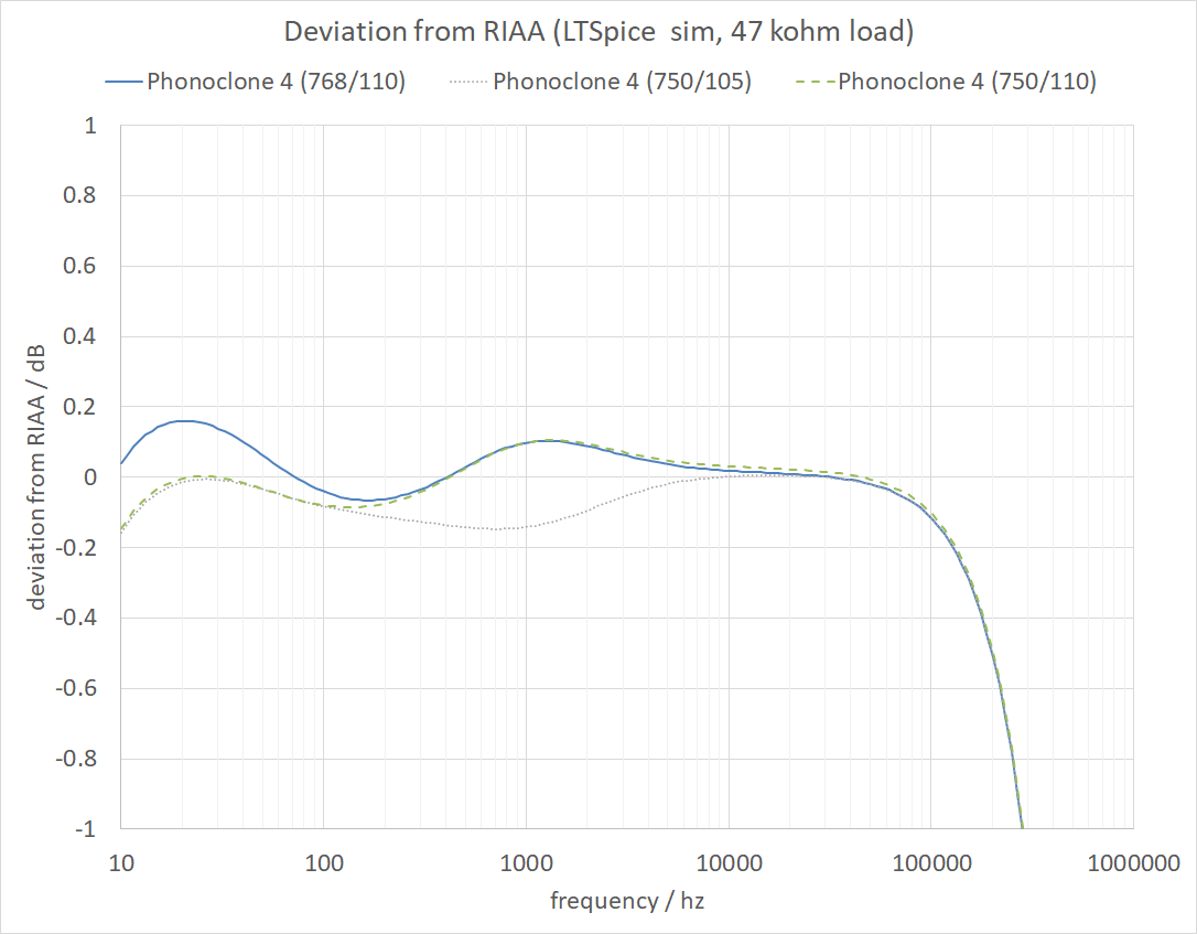

I'm currently putting together the 4.4s phonoclone. For the RIAA resistors R5 and R6. Are the values critical ? From your website, R6 = 750k, however, in BOM and schematic, R6 = 768k. Would you be kindly let me know which values should I use for R6? I want to match them as close as possible to your simulation.
Thanks,
Tom
rjm
Joined 2004
Short answer: use the BOM values of 768k and 110k.
Longer answer:
So what's going on here is the web page values are tabled as 5% tolerance values, hence 750k and 110k. 2k2 ohm resistors etc. That's just a "ok you want to build a phonoclone here you go" list of values for the circuit.
The BOM files are for the boards specifically, rather than the circuit generally, listing specific parts. They are 1% tolerance resistors, so the values are chosen from the 1% list. There are two options for R5 and R6: 110k/768k or 105k/750k. Both are acceptable but I chose 110k/768k for the BOM.
Not that 750/110 is bad or anything. They are all close enough.

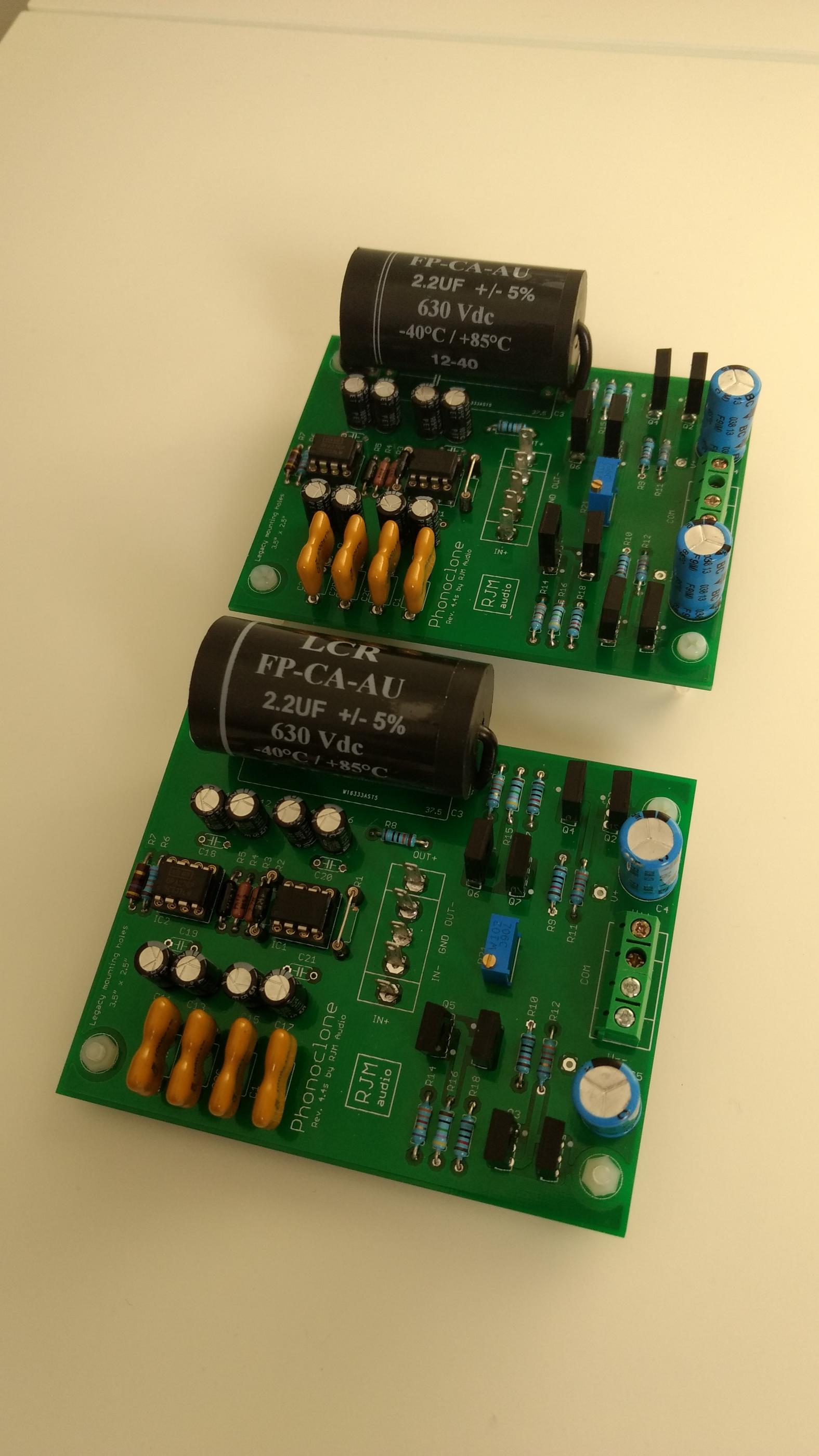

Hi, got round to completing the 4.4S last week.
I've built the boards into a similar case to the one I use for my 3.5h, using the same values for R2 to try and keep the volume levels the same or similar!
I have to confess that for me reworking the wiring etc is a pain - because I don't think I'm any good at it :), but somehow I eventually got the same or slightly lower hiss levels.
All sorts of factors may be at play but general feeling is that there is a little more but tighter bass, maybe a bit more than I'm used to. Nice natural sound to stringed instuments and lots of clean defined music but perhaps to me not as balanced overall as the 3.5h. Early days.
