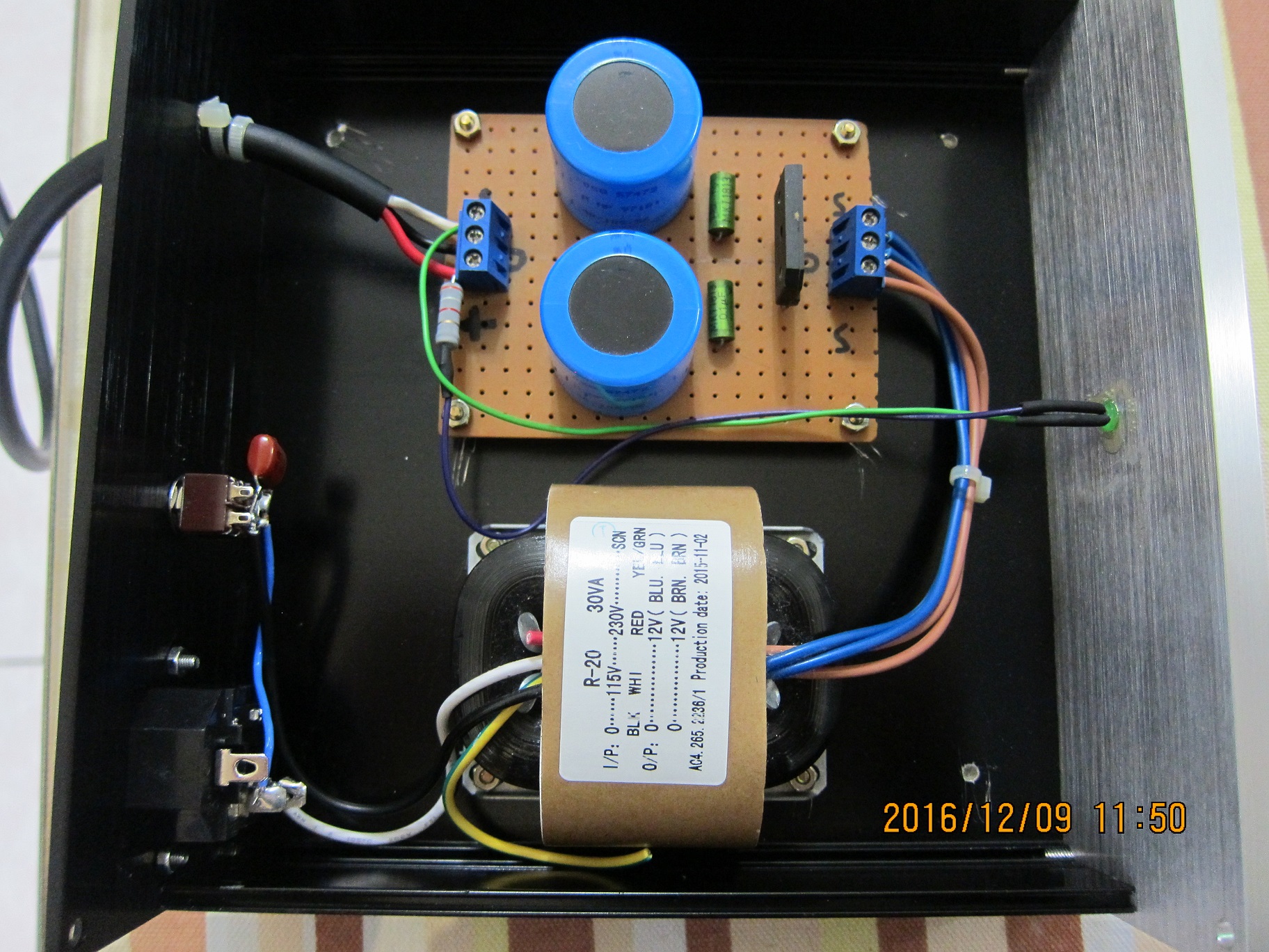

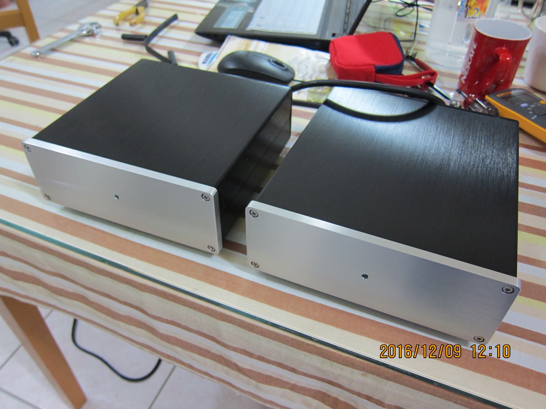

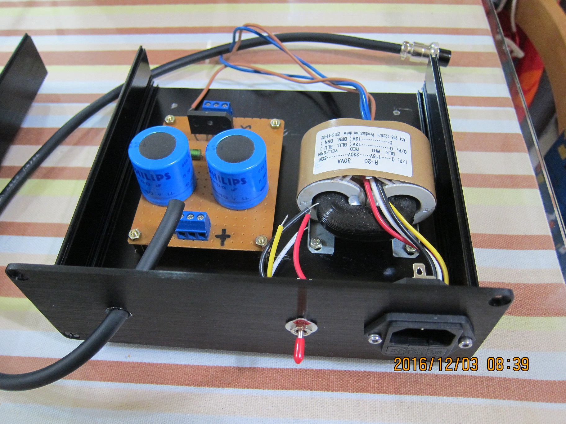

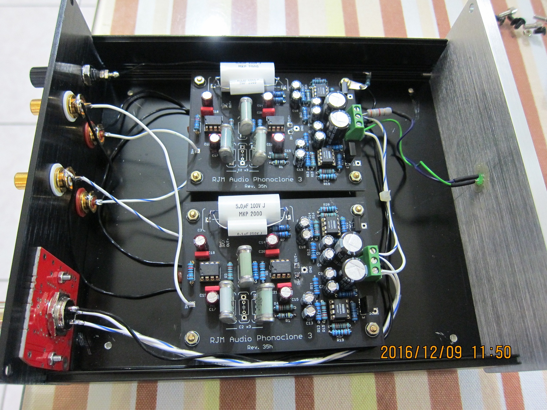

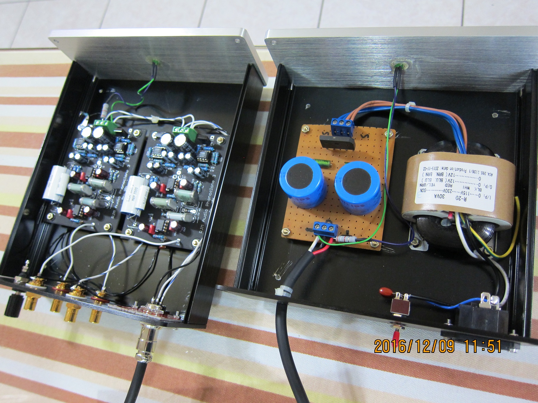

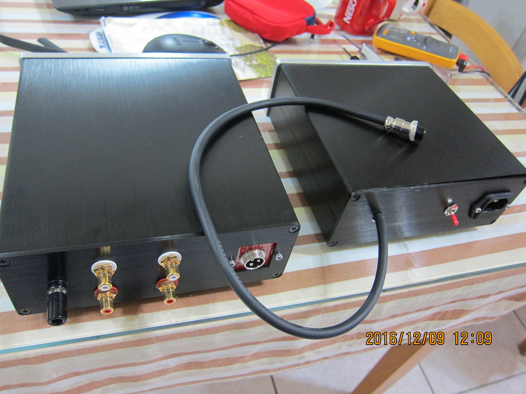

just finished my Phonoclone this morning.
What an amazing sound !
And I see you are using my favorite connector for the power umbilical too. Great job, really professional.
Sure I can't interest you in a pair of buffer boards to go with that?
Why or Why not?
Regarding the build (s) in general, I see some where all the wires both input and output are twisted but the power in wires are not, some where just the power ones are twisted and some where just the inputs/outputs are twisted. Is there a consensus on this? Why or why not to twist?
Good question.Regarding the build (s) in general, I see some where all the wires both input and output are twisted but the power in wires are not, some where just the power ones are twisted and some where just the inputs/outputs are twisted. Is there a consensus on this? Why or why not to twist?
But the glaring error that is Dangerous is the omission of the PE to Chassis Safety connection.
Is there a mains fuse in that IEC input socket?
It is my view that ALL Flow and Return pairs should be twisted to minimise emi.Regarding the build (s) in general, I see some where all the wires both input and output are twisted but the power in wires are not, some where just the power ones are twisted and some where just the inputs/outputs are twisted. Is there a consensus on this? Why or why not to twist?
