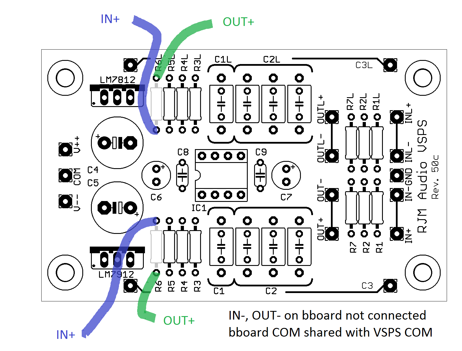

Thanks for your answer. I didn't have any 10k resistors around so I tried sticking 3k resistors at the bboards inputs. That reduced the offset to about 10 and 70 mV, much better but still a bit high for my taste...
How low a value can I go with those resistors? Would it be preferable to just go for coupling caps at the bboards outputs? Or both?

Since the resistor is also the load for the op amp, you probably don't want to go below 5k.
I recommend 10k-25k, and expect the offset to be about 100-200 mV. It is high but inevitable from the design choices at play in this particular config. What you can do, however, is move the bboard circuit to insert it into the circuit in place of R6 on the VSPS. That's the best way to do it, but since it is application specific it's not part of the default instruction set.
Remove R6, and connect wires off-board from the pads to and back from the bboard.
The output offset will of course be zero. Internally it will also be quite small since the DC impedance seen by the bboard input is now directly the output Z of the op amp, so zero ohms essentially.

Thanks Richard, that is really helpful, now I understand fully what was going on.
I did finally try a 10k resistor in place of R7 (still about 200-300 mV DC), and a coupling cap (+ discharche resistor) at the bboard's output, and that did the trick. That is my config right now, it sounds fine, but it looks very temporary and messy (coupling cap and resistor soldered on the outputs RCAs haha!...).
Your suggestion is clearly the most elegant way to solve the problem, and would also make things tidier as far as cable routing is concerned. It will be next weekend's project!

So... I did get an hour to kill, so I did the suggested "re-arrangement", and I'm glad to report everything is fine, offset's gone!Should go something like this.
As long as the COM is in electrical contact with COM on the VSPS there is no need to connect the bboards IN- and OUT- terminals. The bboard GND would not normally be connected.
That did really clear the wiring a bit, since I could loose the minus polarity wires back and forth from the b-boards. And I could shorten the output wires since it all comes from the VSPS now, which is located closer to the connectors.
If anything, i seem to hear a tiny bit less of hum, when listening to the background noise with phones. Not that it was any audible before at listening volumes...
All in all, a really nice project as it turned out!

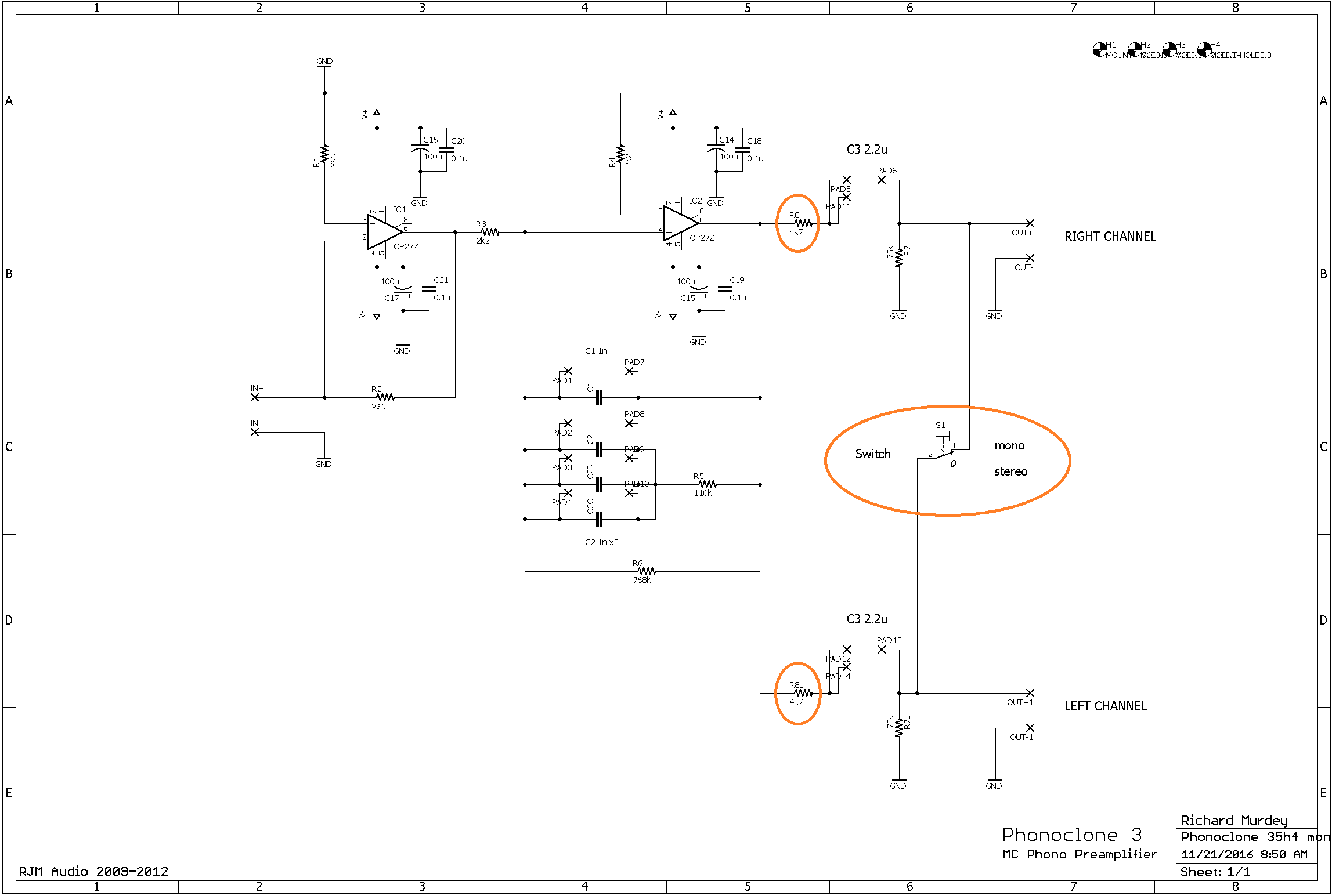

My preamp with a mono setting is having issues. The replacement I'm considering does not have a mono setting. Any suggestions as to adding a mono switch to my Phonoclone3? Thanks in advance.
Dave

Increase R8 from 47 ohms to 4k7 ohms and then add a switch to connect OUT+ of R and L channels together.
The price you pay is slightly higher output impedance (4k7 ohms) even when the MONO switch is open, but there are no free lunches... that's why it's usually implemented in the preamp input section.

Sounds doable, should that circuit be at the input or output of the phono stage? Any chance of a sketch? I assume 4k7 ohms is the same as 47k ohms?
Thanks in advance.
the k is used instead of a decimal point.
so 4k7 = 4700ohms
47k = 47000ohms
0r2 1/5th of an ohm
2r2 = 2 and 2/10ths of an ohm.
Fit the mono switch after the 47k at the output. that's where you have to swap the two 47r to 4700r
But you must use a very short cable and very low value of RF filter at the input to the next stage.
Far better to fit the mono inside the line level pre-amp.

1m interconnects should be fine, and input stages often don't have an RF filter or if they do have 10k in series with it anyways, so the 2k~ this mod adds to the output impedance shouldn't make much difference.

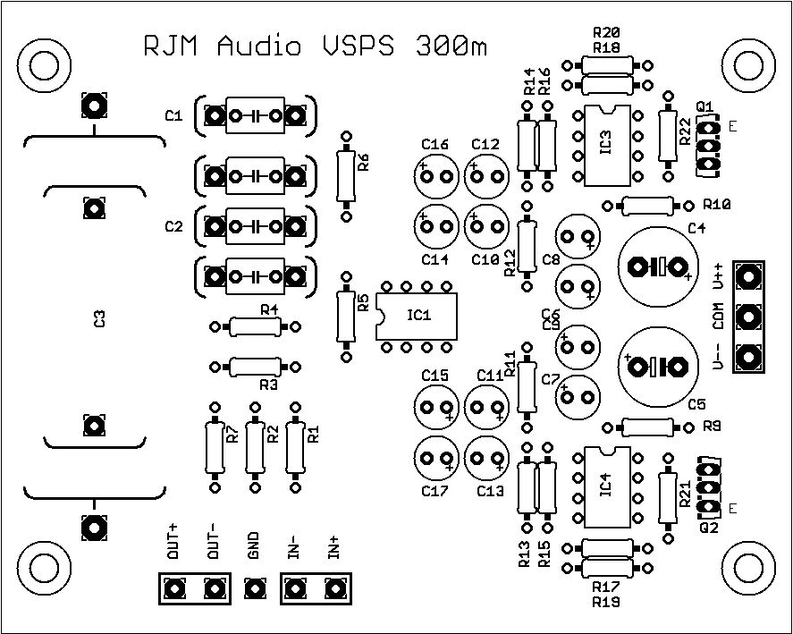

Hello Richard
After a loooooong time I have some spare time and I wanted to play with the VSPS a bit.
However my boards are really tired. I have already lifted 3 or 4 pads.
I wanted to build a pair with some more beefy pads to try different capacitors, resistors and different regulation.
I remember you mentioning that you have a version of the pcb that includes the bypassing ceramic caps.
Are those files available somewhere? The ones on your site are the 300m version that does not include those caps.
Thanks again

You are probably thinking about the phonoclone3 boards, which I redid with optional bypass caps C17-20 and extra pads to tap off the X-reg output V+, V-. The VSPS never got that treatment...
If you want to use bypass caps though just use C14,15 for that purpose. C16, C17 can still be used for 100 uF electrolytics. Functionally it amounts to exactly the same thing as the arrangement on the phonoclone boards.
