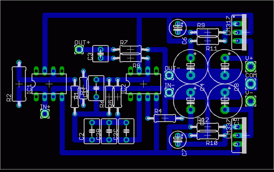

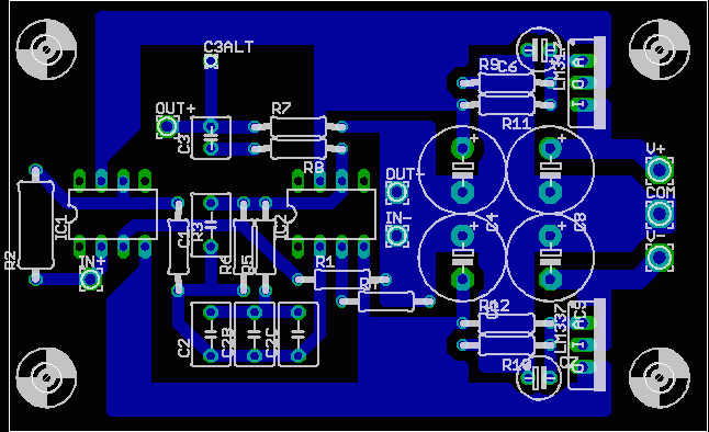

I've been working on the LM317 version of the phonoclone PCB. I'm happy with the arrangement of the regulator components and grounding, but the position of the RIAA components etc is still uncertain along with a number of other things, such as whether its going to be a 'mini' version on the same 1/4 Eurocard size as the VSPS, or whether I'll spread it out in luxury on 1/2 Eurocard as before, with space for larger parts etc., or even if it will be double sided - though I've done it single sided for now.
Feel free to download the source files, above, and play around with it over the new year. See if you can improve on it.

I am wondering about your latest pcb layout: do you really not use bypass caps nearby pin 4 and 7 of the chips?

What is the problem as long as the project hasn't left the computer? You forgotten proper decoupling, why don't you just squeeze it in. You have lot's of space left.
Sorry Franz, my last reply was directed to jaudio not you. I skipped a post accidentally. The bypass cap issue is something I'm still considering...

Back with the VSPS project, I learnt that the bypass caps should be connected close to the power pins of the op-amp.
BUT
What to do with two op-amps powered by one regulator? Use four bypass caps, two for each op-amp? Or use two bypass caps, reasonably close to both op-amps?
At the moment I've stuck to two bypass caps, to keep to the original 25 parts/channel and because the grounding layout works nicely. With reservations, however. I've tried to migitate against the longish traces by making them as broad as possible and the whole layout as compact as I can.

How much decoupling you'll need is dependent of how for away the regulator is, how much current the opamps consume and how fast they are. So if you want to be sure every IC package should have it's own caps.
