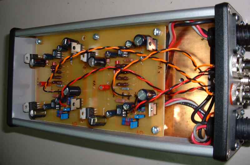

Just completed my PhonoCLone and the sound is just WOW
I was using a NAD PP2 before and the upgrade is just breathtaking. I can hear layers in the music, the different mike technics used. The sound is organic and fluid.
The noise is almost no existent. It is below the LP surface noise.
The supply noise is there because the supply caps are so small, but you hear it only at deafening sound level with no music. In normal use, it is nothing. If the small caps contribute to this speedy and great sound, I take them anytime
It is the best phono preamp that I had built so far. I'm still working of my ONO preamp but this one is much easier to build and much cheaper too.
Very recommended.

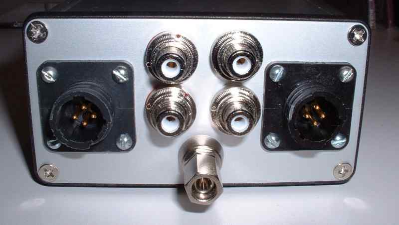

Here a view of the preamp's rear. Both supply connectors on the side. The input and output RCA in the middle.

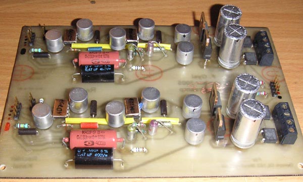

Here the assembled board. The black MKP 4 coupling caps 0.47uF will be replaced by 1uF Audyn Cap after christmas holidays.
