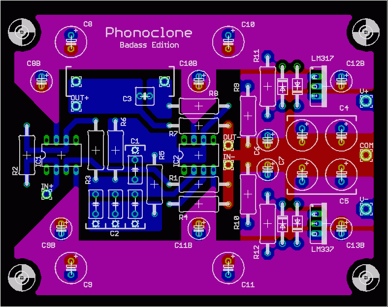

Nixed the ground plane, kept the diodes. Kept the caps but shrunk them a little.
Executive power, y'know.

Pretty!
May I suggest to move C12B and C13B, to keep the back of the regulators free for possibly heathsinks?
I know, they are not needed for a tranny with 12-0-12V. But the heathsinks will allow a bigger freedom in choosing a tranny. Even higher voltage will be possible.
Kind regards
Franz

Franz, now you can simply use C12,13 instead of C12B,13B if you wish to add heatsinks at the back. The space around the regs is still fairly tight however.
GredD, I originally erased the full ground plane because I didn't like shielding the signal components using what is in effect the power ground. However, I remembered that by keeping a section of the ground plane isolated and connected independently to the signal ground I can produce a quiet screen. This has been implemented on the PCB.

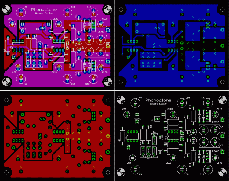

Thanks to everyone who helped with the PCB layout of the Phonoclone .... Badass Edition :skull::skull::skull:
-rjm

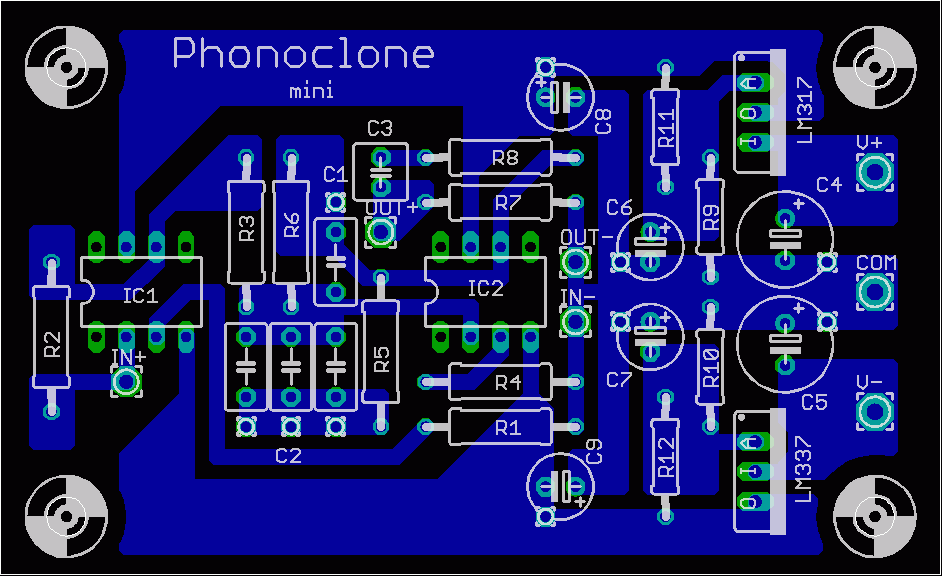

Phonoclone mini
Sorry, that's the only thing to call it that came to mind.
Attached is the final-minus-one version of the VSPS-sized (1/4 Eurocard, 1/2 a normal Phonoclone PCB) Phonoclone.
I'll be ordering it this weekend, so if you want one just yell before then.
Basic limitations are you have to use a Black gate for the output coupling, and no fancy bypass cap options: you are stuck with two placed half way between the regs and the op-amps.
But, it is small. And cheap. Only $20.
/rjm
