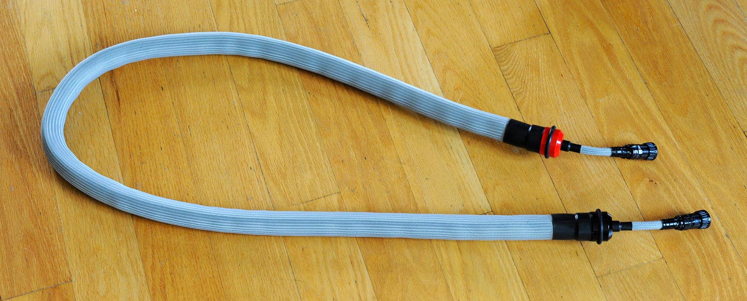

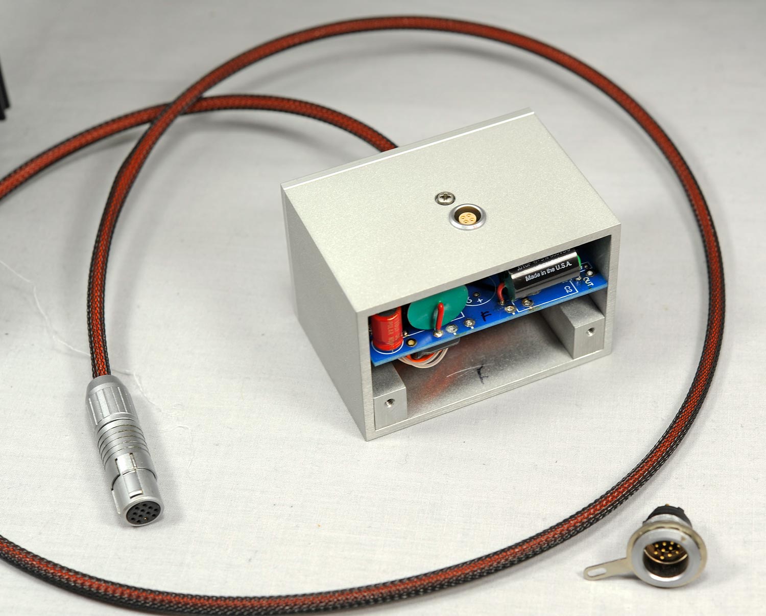

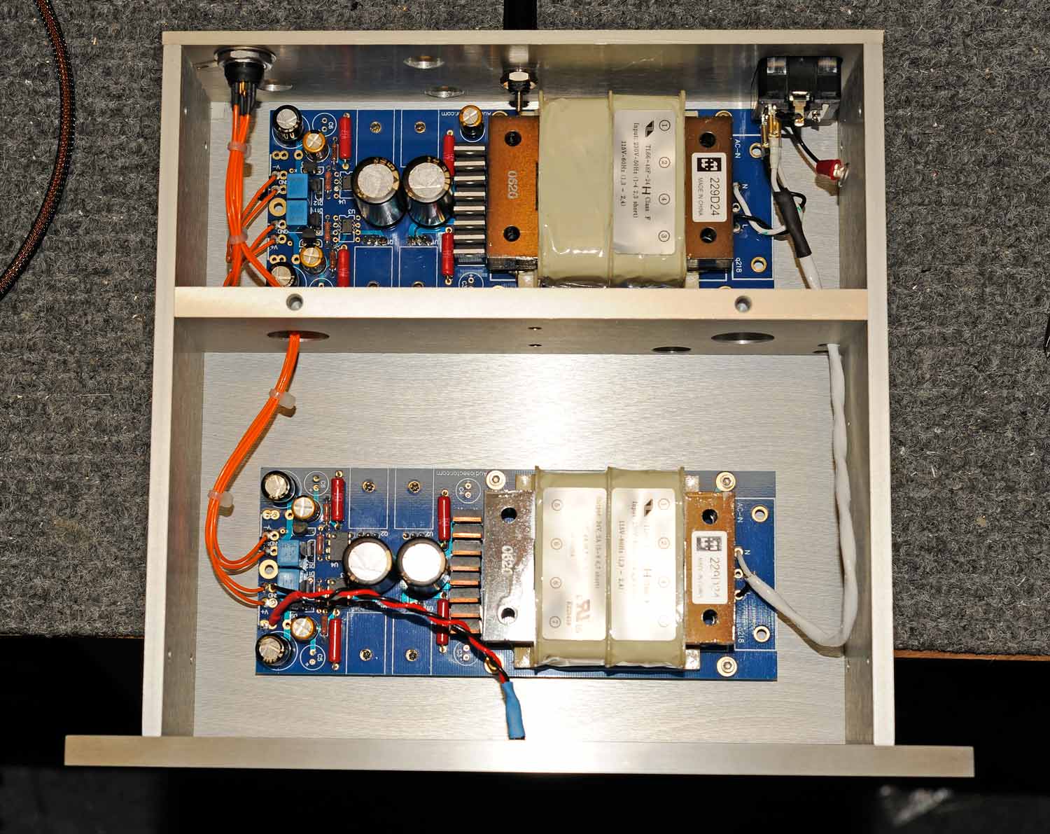

Finally got around to taking a few pictures of the phono stage that Peter put together for me a while back. I had built this circuit in one of the integrated enclosures over a year ago, compared it with a few other phono options in my system and decided that this was the one for me; however, my circuit was not quite as quiet as I would have liked with my Lyra Delos. I asked Peter to rebox it for me in a small enclosure that I could mount right were the interface box is on a VPI table and run the tonearm cable right to the phono circuit. Peter put together a dual mono PS in the integrated enclosure.
Results - phenomenal, can't see myself ever giving this one up, my ears aren't that good to notice an improvement from here!
Thanks Peter!!
Connecting the tone arm cables directly to the INPUT pins of the first OPA without using an intervening RCA cable to join TT and phono-stage is the best way to use this circuit. The currents and voltages involved on the input are so small, that degradation occurs very quickly with RCA sockets, RCA plugs, long cables, etc. Once I removed the RCA plugs between TT and phono-stage, it was as if I moved from row 15 to row 3 of the concert hall.

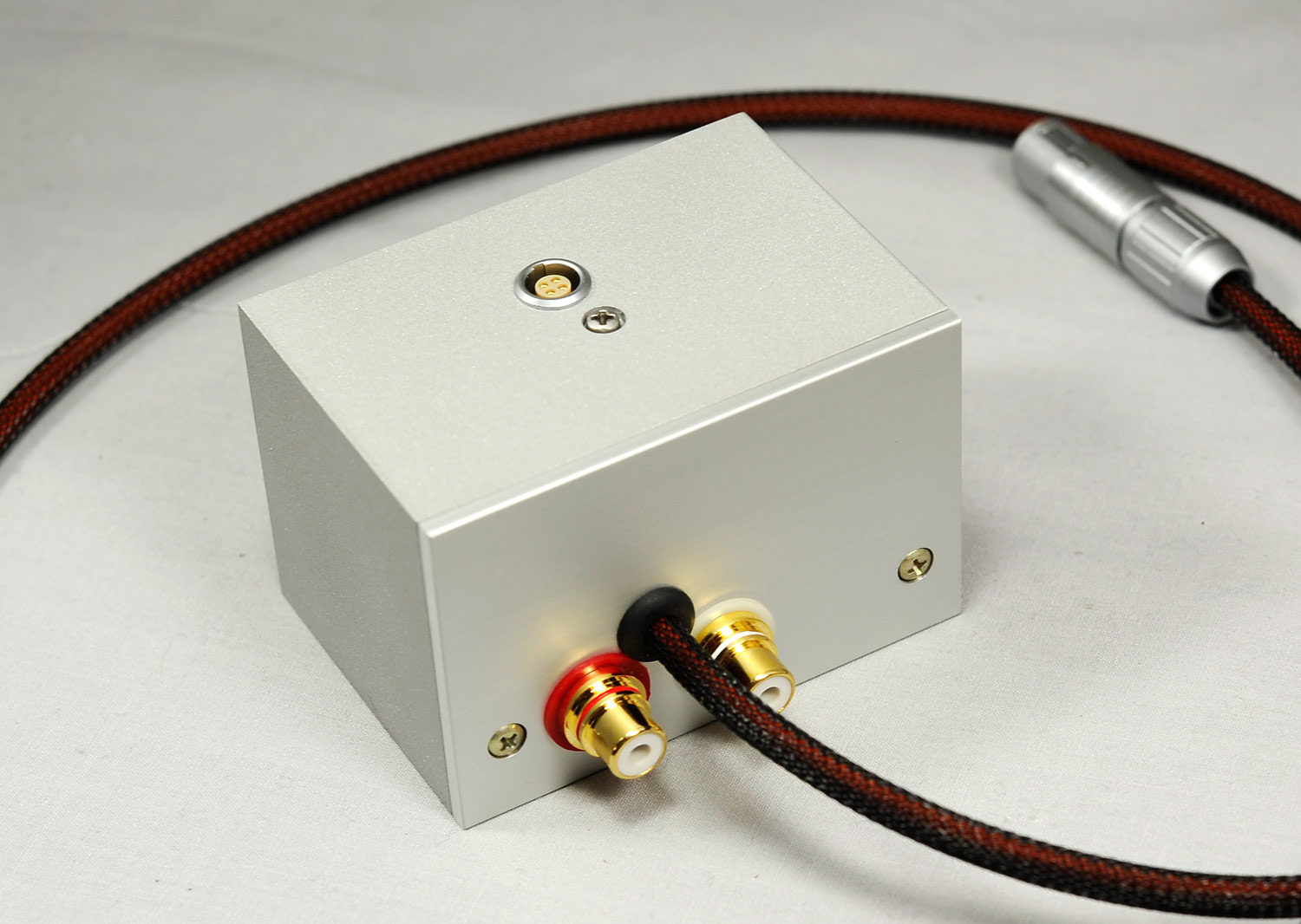

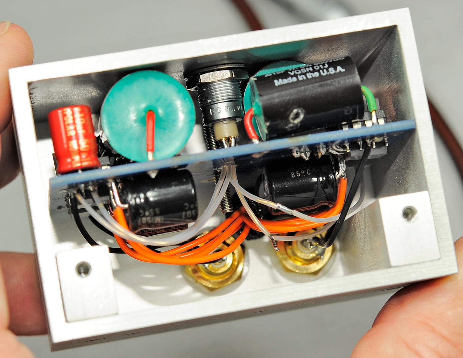

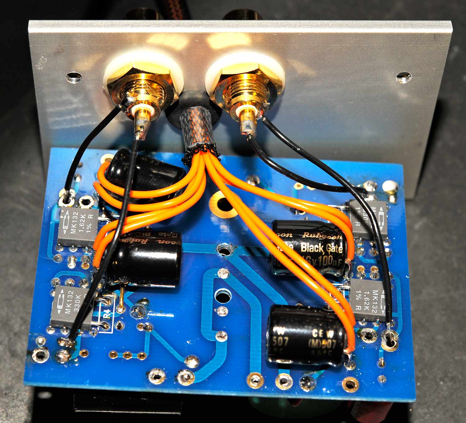

It was s tight fit and a bit tricky to assemble, but I'm glad it worked out fine. Here, some more pics of the inside:

Hi Peter,
this really compacted version of the phono looks
really nice. Connectors are from lomo right?
Is this an upgraded version? Because in the original
circuit there is one 100uF BG for two opamps each
channel, in the picture i see one BG each op.
Greetings ulf

Hi Peter,
looks great, as usual ;-)
BUT i always thought that those high quality constant-current/ shunt
psu´s should be as close to the load as possible... did you do any
measurements or listenings between close to the load and in
different cases?
Greetings ulf
