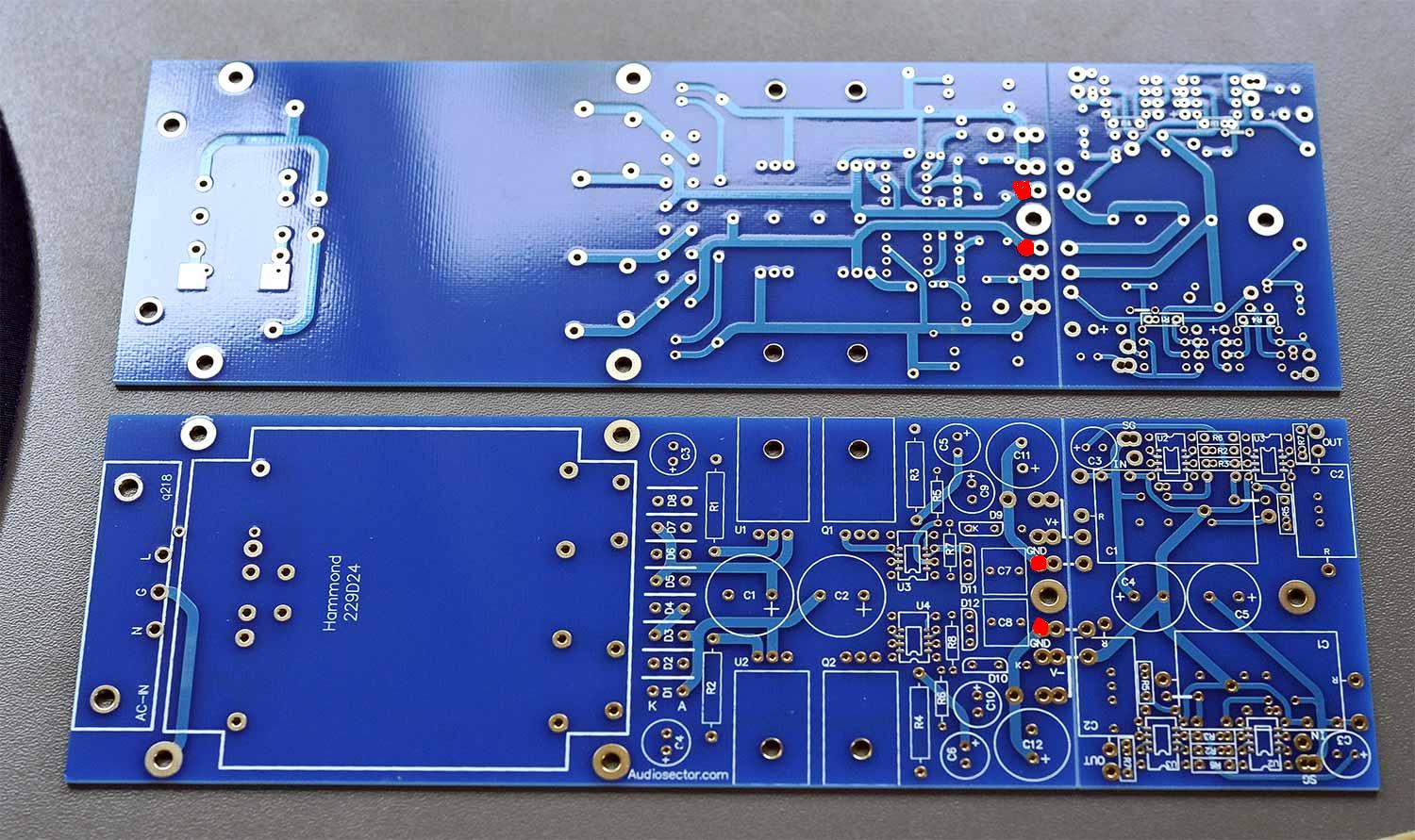

I have a similar problem in that as I turn up the volume I get more hum.
Presently I have the AC-IN and Turntable ground connected to a single ground- post on the chassis. I was wondering if I could connect the GND points I have coloured in red (see attachment photo) to the ground post mentioned above.

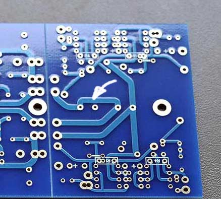

Where in the heck is the common PS ground at C4/C5 on the PCB? Could someone spell it out for this dummy?

Sure. I used a speaker post, but make sure you can solder to it. There is no connection to the chassis.
Also, I connected 3 holes over, to where the capacitors join -- the grounds you have labelled connect to the same place.
It's the trace that connects pins of both caps, as indicated in attached pic.
As to hum, it looks to me like the mains ground leg is tied to one of the mounting posts, which might, depending on the build, also connect to the chassis. If you have another ground point tied to the chassis elsewhere, you've undone any "star" like grounding AND created the possibility of current flowing in the chassis and hum deriving there.
Yes, the ground post should be isolated from the chassis and connected to the point indicated in my previous post.
