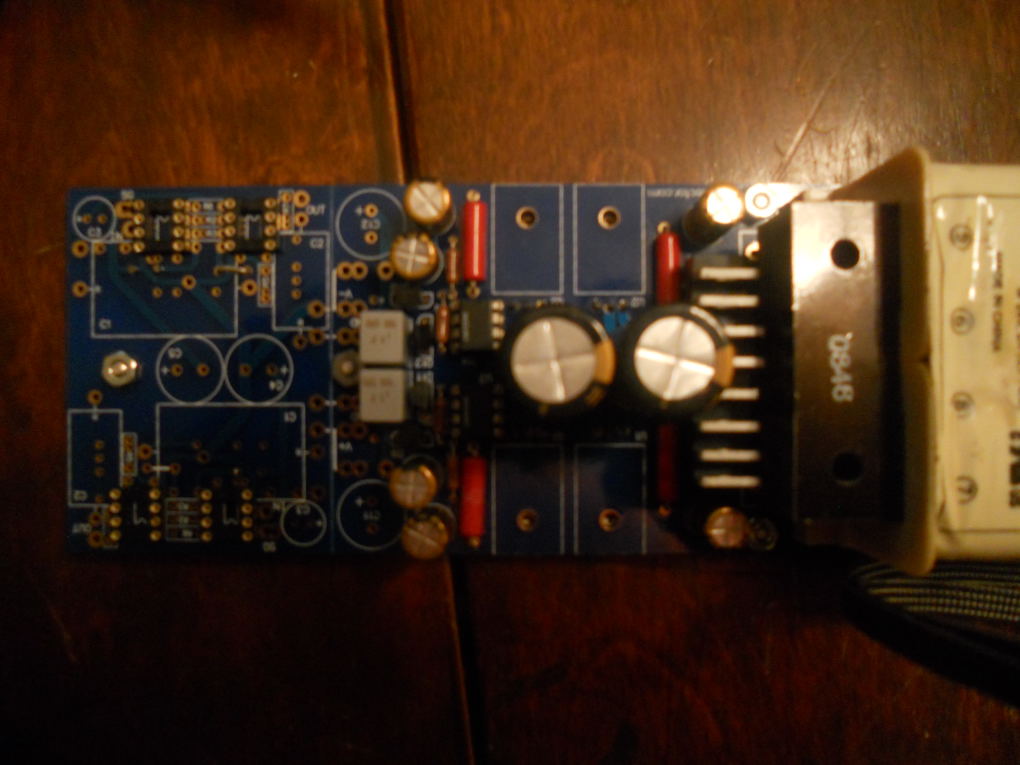

I am hoping to complete mine tomorrow -- it is a dual mono version, and will be stuck into a 2x3 enclosure.
It will be playing a Denon 103D, and replacing a Denon HA-500 (Fully recapped) and the phono section of a Paragon system-e (via tape out) combination. The paragon has had some PS caps replaced, including the heater -- all mundorf.
Tomorrow is a big day. Hopefully, it all comes together.

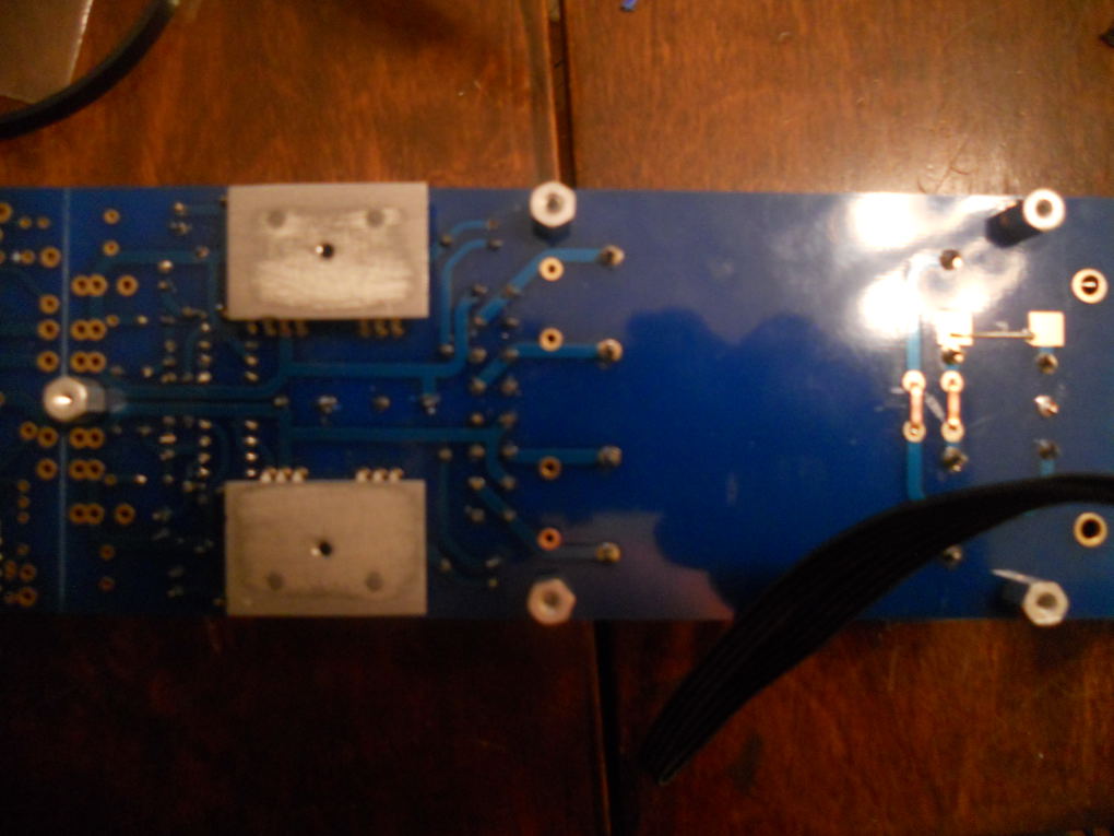

One of the power supplies got powered up today.
The initial voltages were +3.45 and -14.75.
Adding C3 brought the positive voltage up to +15.
Adding C4 brought the negative voltage down to -15.
Both of the regulators are ON semi. There is NO load at this time.
Will adding a load change the need for C3/C4? I will make the other channel without C3/C4, and see if there is need.

I built the other channel, and added load. The positive voltage goes to 15.12, and the negative around -3 or -4 volts. Adding C4 and both voltages are the same. Removing C3 from the original channel and adding load has positive at 15.3 negative at -15.12. Is that ok?
