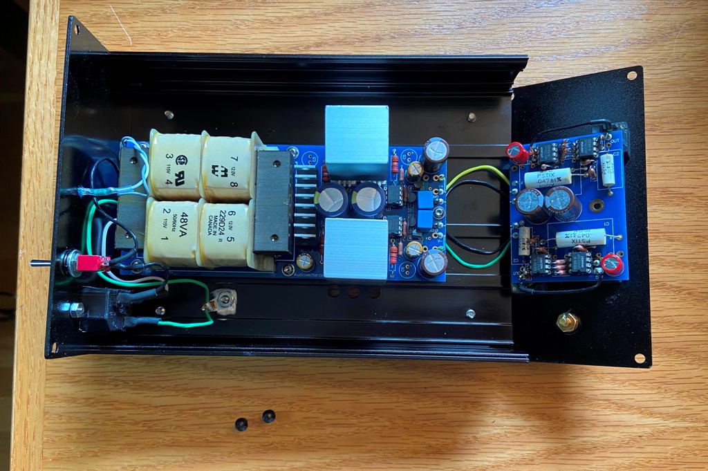

I wanted to revert to stock, and now the power supply is not working.
It showed +18.3 and -17.4 rails, I put in new opamps, it jumped around 0-10v, I turned it off, resoldered U1,Q2 Q1, Q2, and turned on again. Back to an unregulated 18 and 17 volts.
It seems the regulators have failed. The op amps were opez27.... I guess they are dead now too?
Any help getting this going again would be *greatly* appreciated, as this is my only phono section.

I've been taking my stupid changes out of the phono section. Never again will I doubt the skills of the designer. Rookie egotistical mistake. I apologize for that.
I've learned enough to know I don't know very much at all. The power supplies are back to original and have reasonable voltages. One last change is to remove is the added 15 dB gain from a post earlier in this thread....
Can someone tell me please..... how can a circuit with a shunt regulated supply and no ground connection hum? Is this a floating circuit? If this is a floating circuit, a ground loop breaker, (two diodes back to back with resistor and capacitor between the power supply zero volt line and the earth ground), should not be needed. Is that correct?
Also, should the ground lug for the TT be isolated from the chassis and connected to earth ground or should the ground lug be attached directly to the chassis which is already connected to earth?
I see about 3 mV of noise on the output with a scope attached.

fixed!
