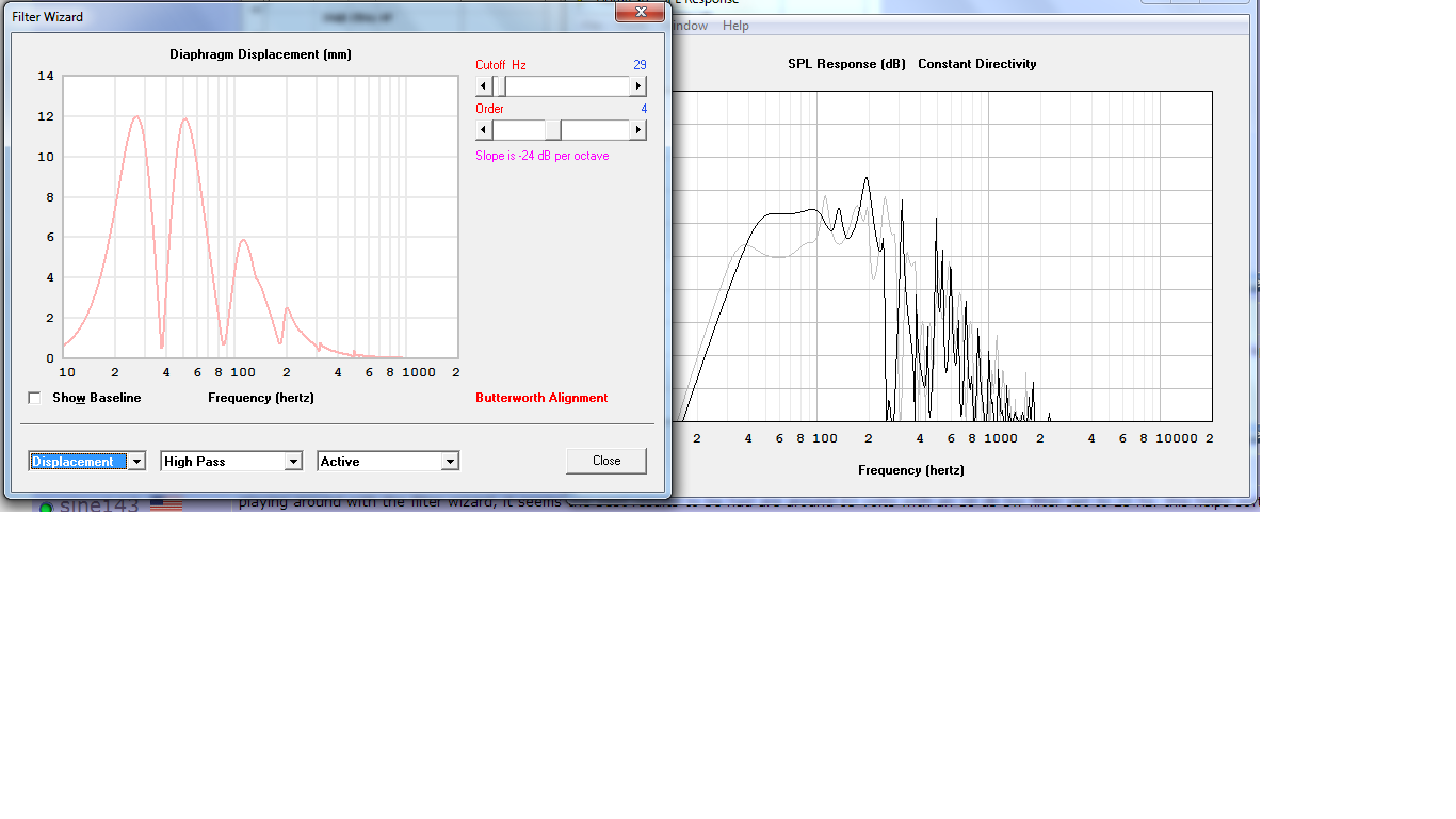

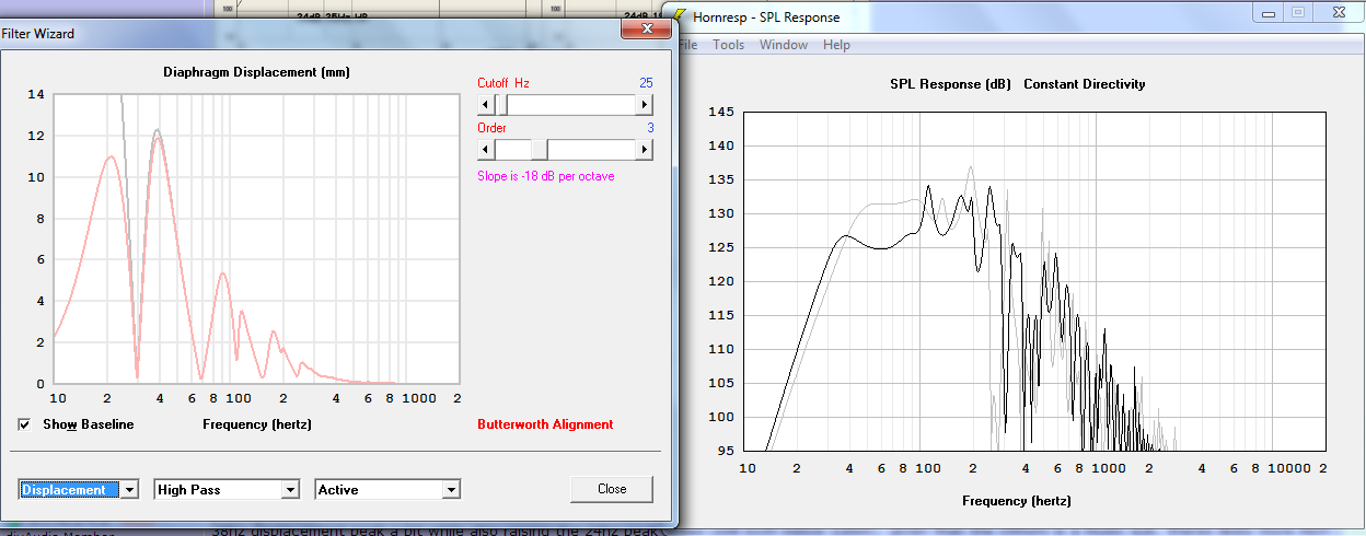

pic one is a tbw100 loaded keystone at 82 volts, 29hz 4th order hipass (xmax limit) vs the othorn tbw100 at 62 volts, 25hz 3rd order hipass. As far as this driver is concerned, I think its more suited for the keystone (although the othorn does still go marginaly lower).

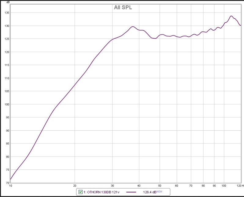

Pic 3 is the othorn 21sw152 4 with 95 volts (theoretically 15mm xmax limit with 24hz 3rd order hipass) grey line, vs the tbw100 keystone with 82 volts and the hipass listed above. With the recomended driver and the amp power behind it, the othorn really flexes its weight imo, making it REALLY nice box for its size.
Oh if only I had the 900 dollars I needed 🙁. looks like it'll be keystones for me for a while until I can afford what it takes to get to 30hz proper (both in amps and in speakers lol)

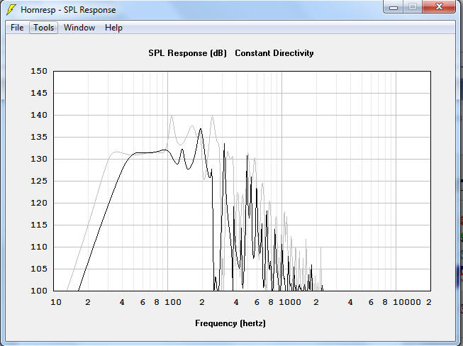

samuel, observe my post. pic 1 is the 18tbw100 in the othorn (grey) at xmax with 62 volts, vs the keystone near xmax at 82 volts. note these are sims. arts keystone mouth helps give a bit back to the 38 to 45 range. The 18tbw10 easily has more "spl" in the keystone.
Fs is not a good indicator of where the HP filter should be set for each driver in a tapped horn. Max excursion usually occors WITHIN the passband when a hipass is employed. As such many people have surmised that an FS of higher value is actually ideal, because it helps control the cone within the passband better due to stiffer suspensioin.

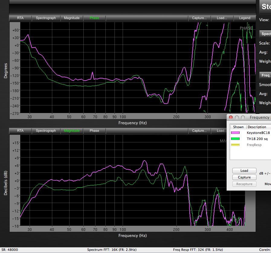

1) Those are actual measurements, not simulations.1)Thanks Art for the simulations. The 18TBW100 has an Fs of 35 Hz, a slightly lower Pe and Xmax rating compared to the 18SW115 which has an Fs of 32 Hz.
2)So in practice I wonder if the HP filter should be set higher than for the latter driver?
3)Max SPL, I guess is higher in the Othorn (with F3 of 40Hz); what would the Max SPL be in the Keystone (with F3 around 34-36 Hz)?
4)Wonder how the 18TBW100 sims in Xoc's TH18?
Simulations are for sissies😉 .
The 18SW115-8 has an FS of 32 Hz, the 18SW115-4 (used in the measurements) has an FS of 34 Hz.
The TBW100-8 has an FS of 35 Hz, the TBW100-4 has an FS of 33 Hz.
2) The HP filter should be set a few Hz below the excursion minimum point, which is determined by the box, not driver Fs.
3) The Othorn F3 is like 27Hz, not 40 Hz. It uses a larger driver in a larger cabinet and goes louder and lower than the Keystone.
4) It would sim similar to the 18SW115.

Tested both Keystone and TH18 with 18NLW9600. Clearly Keystone was the way to go; goes lower, better cone control (weltersys made the fine adjustment to it at mouth), and about 2 dBs louder.
