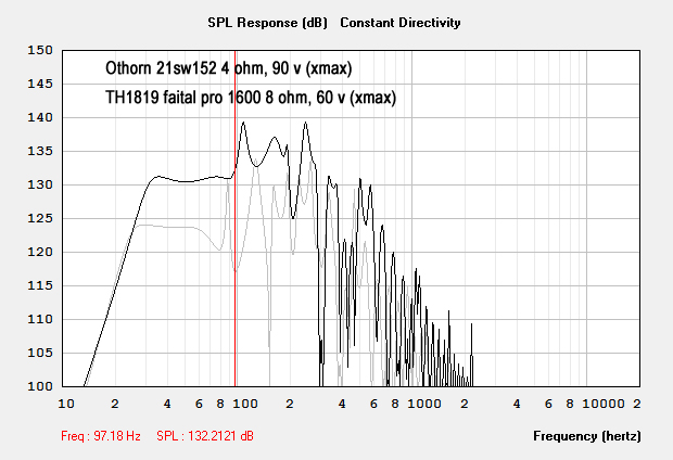

and considering the power handling and xmax of the SW152 in the othorn, I'd expect the driver in the TH1819 to run of of gas quicker (18 with 12.9mm xmax)
I cant find the thread with a search, do you have a link?
thanks for the link. Looks like this is the "sim" output. the th1819 runs out of xmax 6db earlier (in passband).

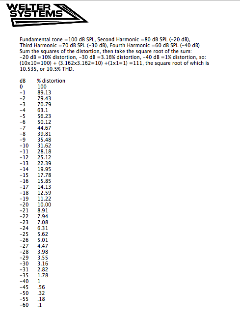

Thank you Art and Josh! It's sad that bfm doesn't declare distortion values... How much distortion does a flh design actually filter out, is there a general rule for a well designed flh cab? Has anybody done any distortion measurements of bfm cabs at full throttle?
