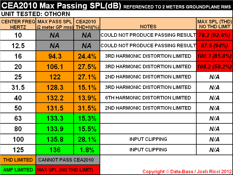

Here is a teaser...I should have all of the measurements public on Data-Bass by the end of the day tomorrow. This is a pants flapper...Output capabilities 25-30Hz are what I hoped they would be and the distortion performance is very good as the distortion sweeps will later show. Dropping the output 3 to 5 dB dramatically drops THD levels. At 100 and 125Hz my sound card input was being clipped a little.
CEA-2010 burst output measured from 2 meters, ground plane, outdoors. (Roughly equivalent to 1m anechoic or full space).

Looks killer Josh!
What voltage was used to achieve those levels?
Art

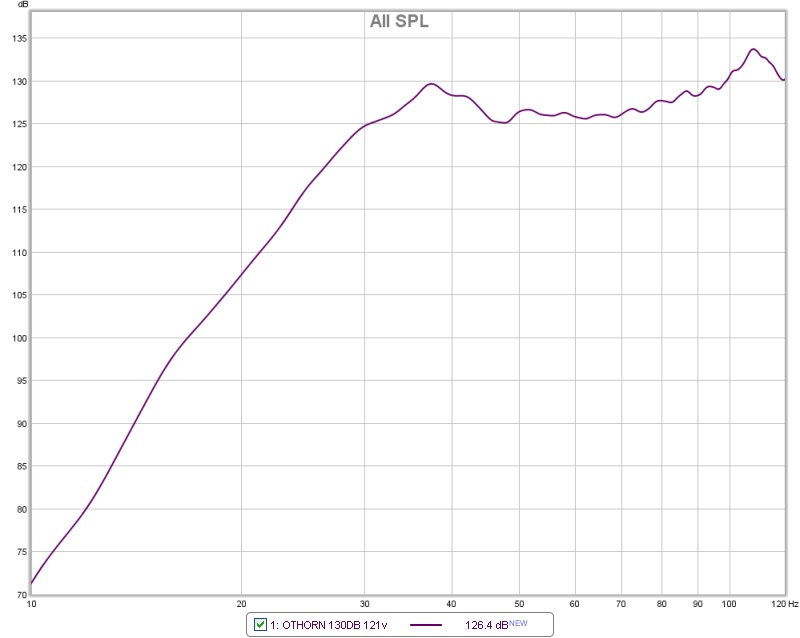

Thanks. The final long term output compression sweep measurement was at 121 volts. There is about 3 to 4 dB of compression at this level.
I do record the voltage for the compression sweeps but I never do for the bursts. I will start if I remember. Near as I can tell the burst outputs involve this much voltage at absolute minimum extrapolating from a 38.3V sweep with no HPF where there is virtually no compression occuring. There is likely to be a good amount of compression involved with the power levels used for the bursts so the voltages levels are probably quite a bit higher in reality.

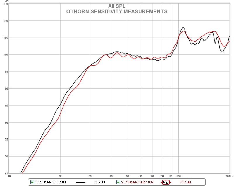

Base sensitivity is presented here.

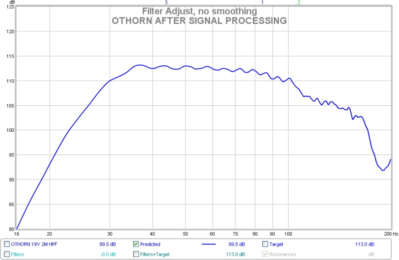

Here is what the FR looks like with 3 bands of EQ a 24Hz BW 3rd order high pass and a 4th order LR 120Hz low pass.

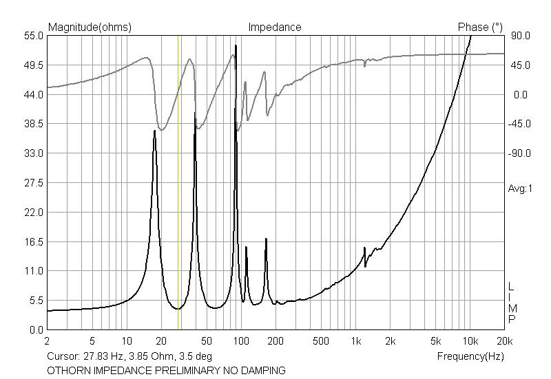

I do have impedance measurements of this cab with about 1.5 volts input. I have not done the high power impedance measurements in some time. I have the LinearX VI box but not the LinearX software and the only program that I currently have that I have been able to get to work is REW but it requires 2 measurements for each voltage input and this results in even more heating of the drivers. Also I find that there are some strange shifting of the measurements that occurs depending on how hot the input level is. The outdoor sweeps may span from 2 volts to 150v in level which is a huge difference in signal strength. This requires adjusting of input gain etc... every couple of sweeps. Additionally this is yet another test rig to setup which requires another day of testing. I may still do the more interesting cabs at some point like this one but I haven't messed with it in a while. :eek:
Thanks Josh,
I saw the high power impedance measurements of the Gjallerhorn a while back (and your surprised notion of the 'shifts' in another post) so I was curious if you had made them of the Othorn. I agree, archiving isn’t the most inspiring job;
If 2V to 150V is giving too much variation in output level measurements why don't you use the 28,3V/10m instead? That usually keeps you within the 40dB range.
