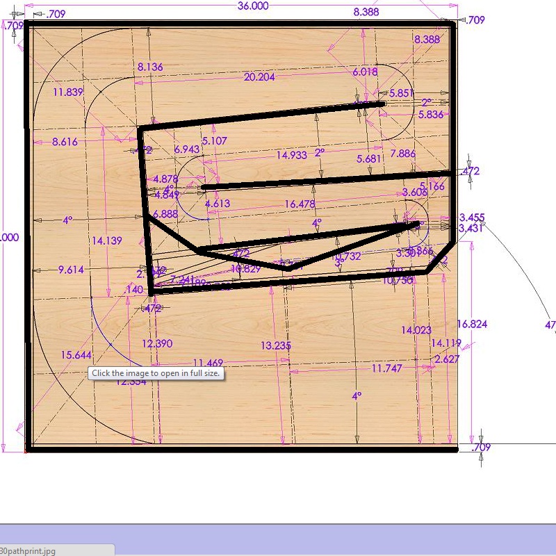

Your model shows a difference with your measurements because this type of folding repositions the S2 of the system out of the centre of the driver. In many of these cases only cone volume correction doesn't help enough for repositioning the S2 point (To correct your model you could enlarge the distance between S1-S2 and take the same amount off from S2-S3. You can also raise the Le value in your model since the inductance raises as frequency drops).
In my view what happens is that the pressure in the first half of the cone (closest to the beginning of the horn) is lowest and the pressure in the second half of the cone (near the correct S2) is the highest. In other words, the first half of the cone no longer has enough pressure (spring effect) to keep the cone under control. This effect together with relative high Fs of the 21SW115 (32Hz, which is very close to the excursion peak of the system in my view), can drive the cone into self resonance. This can end in damaging the cone over periods of time at high excursion.

Not sure I understand? I always assumed pressure on cone closest to S1 was highest and is why cone failures seem to concentrate there, not lowest.
To that end, I've employed a circular compression "plate" to help evenly distribute the pressure on the cone -- or a smaller S2 / much larger S1 "cone correction" to provide additional 'air spring' on the S1 side of the cone.

Hmmm...I had thought that the pressure would be highest near the start of the line where it is tighter as well.
Why would the S2 be shifted that much from cone center when the angled panel ends almost exactly mid cone which is how it is modeled? If anything there should probably an additional horn section accounting for the different expansion under the second half of the cone. The cone volume is what is not accounted for well. There is a fudged vtc and atc value in the simulations but I'm not sure how accurate that is. There is some difference caused by the multitude of bends present as well I'm sure. Still the response and impedance looks pretty darn close all things considered.

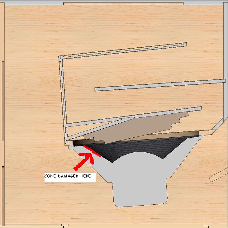

Hi Josh and Jim,
I'll try to explain.
The pressure supposes to be optimal at S2. In our ideal models we position S2 at the centre of the driver. In these models S1 is part of the horn, more exactly the beginning of the horn and represents the high pressure zone. The left picture represents such model.
However, in reality we add extra volume around the S2 area that is introduced by the volume in the cone. This cone volume interrupts the ideal expansion rate of our theoretical models. The right picture represents such model. Because of the extra cone volume, this area starts to work as an independent compression chamber. Therefore S2 shifts towards one edge of the driver (or beyond) as you can see in the right picture. Also S1 no longer is part of the horn but part of the compression chamber. Because it doesn’t represent the beginning of the horn any longer, the pressure at S1 starts to drop in relation to the pressure around S2. S2 now represents the beginning of the horn.
Josh, I am afraid the narrowing panel from S2 to S1 in the Othorn is not part of the horn but part of the compression chamber. Therefore it will make the pressure differences between the two edges even worse.
By using a "compression plate" like Jim described, you introduce a compression chamber between the driver and the horn. In such case S1 is still part of the horn and represents the beginning of the horn (high pressure).

I'm one step ahead of you. I'm trying some rubberized epoxy applied on both sides of the cone in the compromised areas. I will then mount the driver rotated so that the good section of cone is in the area that was caused damage last time. Might work. But I doubt it will hold up to >150 volts 😀
If further testing indicates that additional modification is in order I will probably cut out the angled throat panel. I won't be able to cut in and put the angled piece that you show in the corner of the bend. Things are very tight in there and I won't be able to work that cleanly.

Fig #3 is similar to what the configuration was during testing.
Actual representation shown below with marking of where the cone damage occured...As you can see the added material eats up a lot of volume in the throat area and there is likely an extreme amount of force developed with the power inputs used. I expect at least somewhat lowered forces on the cone with its removal.
The plate was nothing more than the scrap cutout from an 18",15" and 12" driver glued together.
