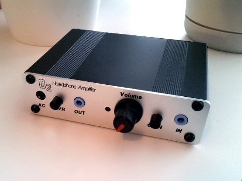

I finished the first of two O2 amps today. All of the initial tests went well and when I was finally able to plug in some "non-throwaway" headphones and listen to some FLAC files I came away very impressed! THANK YOU, RocketScientist, for sharing your design expertise with the community and your many, many hours to test and document the amp every step of the way.
I find the O2's sound to be very transparent and easy to listen to. I've tried some IEMs and Beyer DT-770 80 ohms headphones, but haven't yet plugged in my LCD-2 Rev. 2 headphones (need to get an 1/8" to 1/4" adapter).
BTW, the front panel from FPE is a perfect fit and alignment of all the machined holes is very accurate. They do great work...I look forward to seeing their facility in January at a Seattle Head-Fi enthusiasts meet.

That front panel looks fantastic! Are those the screws that come with the enclosure? They look bigger.

@4nRadio, you're welcome. Your O2 looks great! I hope you bring it to the meet and let others listen to it. That's one nice aspect of a battery powered amp.
Yes, they are the screws that came with the enclosure. They are the T10 Torx bit size. I put these on the front, and kept the supplied Philips head screws for the back panel.
