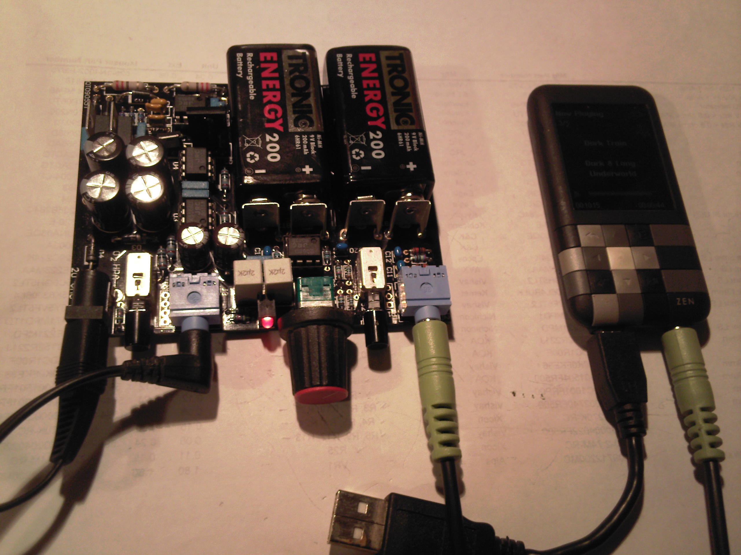

Glad to report a succesful build, with everything checking out and working first time. Many thanks to RocketScientist for sharing his expertise and giving us all this excellent project; thanks also to all those involved in the group buys.
A couple of points - First, my O2 is considerably more powerful when running from the AC supply (15V 1A) than from batteries - Using a pair of HD25 Mk1, rated at 64 ohm, on AC it's possible to make them as loud as I would ever want with the gain switch set to the low position and the level about 2/3 max - however, on battery power, you need to set the gain to the high position and turn the level up almost to maximum to get the same output level. Still more than adequate for portable use, but I wonder if I might be better off investing in some different batteries, as it seems likely that they don't have enough current capacity - has anyone else noticed a similar phenomenon?

@greenalien, the gain of the O2 does not change from battery to AC. In fact, you can listen to the O2 while on battery power, plug in the AC adapter while the music is playing, and the volume will not change (unless perhaps it was badly clipping while on battery). If you're noticing dramatic differences, and have a DMM, check your battery voltages while the amp is playing fairly loudly and running on battery. Or perhaps you have D2 and/or D6 installed backwards, missing, or not soldered correctly?
The maximum output (which requires turning up the volume control while on AC to take advantage of) increases from about 5 Vrms on battery to about 7 Vrms on AC. That's only 3 dB difference.
