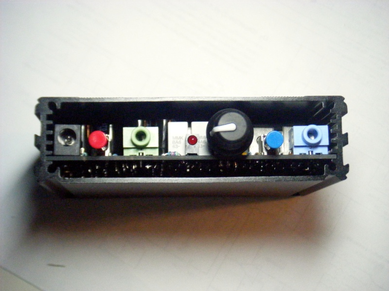

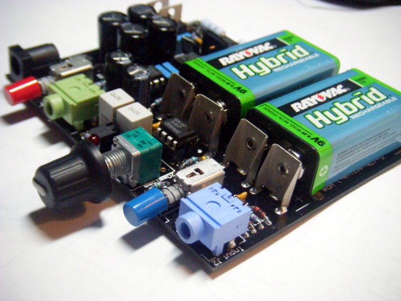

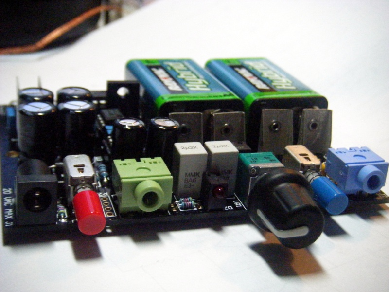

I finished building my O2's (two of them), and am very pleased with the results. The boards are very nice, the build was easy, and the sound is excellent. Definitely way better than my old cmoy. Output offset voltages measured 2.9mV and 2.7mV, so excellent. Just waiting for front panels. I may need to order more boards and parts, as friends now want their own!
Here are a couple of pics:

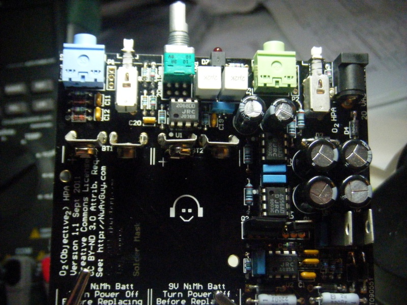

I just finished putting my amp together and testing was going okay.
However, I'm having some issues with the low battery circuit.
With no headphones connected, disconnecting the battery in position Bat1 produces a DC spike up to around 2.5 volts then settles down to around .3 volts. When removing Bat2 the spike hits around 6 volts and settles around .25 volts. I'm assuming I managed to kill one of the components but was wondering which one was the most likely suspect.
I did substitute FK24X7R1E105K TDK Multilayer Ceramic Capacitors (MLCC) - Leaded for C1 as I had some on hand but when reading the data sheets they appeared to be pretty much the same.

How long is the spike? This may be how it actually looks before the low battery circuit kicks in, and since the voltages are down below .5V once it kicks in, it is probably fine.
From disconnection of the battery until it settles down takes one to two seconds.
I plugged in a pair of junk earbuds to see if that made a difference and heard a loud snapping noise each time with them about a foot and a half away from my ears.

Unless you happen to drop the the O2 hard enough to dislodge one of the batteries (in which case you are likely to have other physical problems...) it is unlikely that you are going to see a failure mode that is going to cause this kind of spike. RocketScientist has designed the protection circuit to shut down the amp when the output of the batteries becomes unequal, for whatever reason, and in most cases, the voltage drop is never going to be as immediate as a total disconnection of a battery when its powered on..

Just completed my board tonight. Plugged it in, LED goes on, nothing blew up, so good so far. Plugged it into a source/headphones and no output at all. no static, no anything. Any clues on whats going on?
Hi:
Other than a basic smoke test (LED on, no smoke) have you done the basic tests? What is the measured voltage of your transformer? Transformer plugged in, power off, no batteries installed: what is the voltage across the battery terminals. Power turned on, what is the voltage across pins 4 and 8 on the IC sockets? What is the voltage across the electrolytic caps?

You're saying that it won't turn on at all, using batteries or AC power? No light at the LED? Have you gone through the "post build" testing steps on NwAvGuy's blog? Can you measure voltage at any of the test points he specifies?
It will probably be a long, slow process to find the issue, but it can be done.
@tschuss. Thanks for responding. I went through the complete "post build" testing steps and the amp worked beautifully until, I tried it in the case. I checked all potential chassis contact points before turning it on, but as soon as I did, the LED did not turn on, and I have no sound out of the headphones.
Today I restarted the testing steps and measured the following voltages at the caps listed below:
C10: 10.62 v
C17: 14.45 v
C18: 3.934 v
C8: 14.50 v
C16: 28.82 v
C21: 0.012 v
C1: 3.775 v
The readings clearly indicate that there is an issue in one of the rails. I just don't know what component(s) I should test next to determine what needs to be replaced. Please help.
