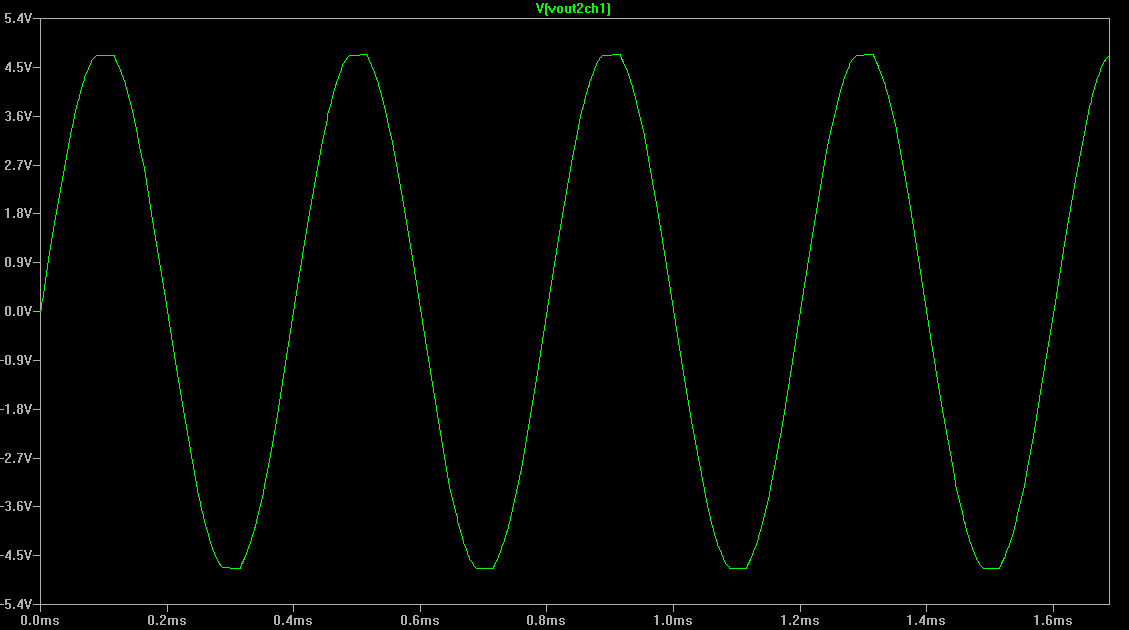

How would I go about modifying the O2 to ensure I can't exceed 200mW into 55Ohms (really 55-125 Ohm according to measurements)?

With +/-9V rails the amp starts to clip around 4.7V, as shown in the sim below into 55R loads. That is 4.7V peak = 3.32Vrms, which would be (3.32V) ^ 2 / 55R = 200mW.
This would mess up the battery charging ability though. 8.4V cells need to charge up to about 10.2V and they can't do that if the rails are only 9V. 🙂 So this would turn the O2 into an ac-only unit.

So I'd basically have to cut the design in half (one 4556) and make sure my gain is under 2x, right? That would keep me way under that level... or am I wrong? My cans need up to 125mW at 55 Ohm to ensure I can listen to some really good classical. My reason for wanting the upper limit is because I have young kids in the house who are starting to like listening to my cans. My son almost blew my cans to pieces with my current amp because it can deliver ~600mW into my AKGs which are rated to 200mW.
This wouldn't work, one 4556 is used per channel (L,R) in parallel to increase the power output. You run one chip and all you do is lose one channel.
Your best bet, if you're really concerned, would be to just use unity gain and leave out the gain resistors entirely. You could try to diy some type of stop to limit the volume pot travel as well.
As has already been suggested, just use 1X gain (or possibly more depending on your source). Very few sources put out much over 2 Vrms. With 1X gain that's only 72 mW into 55 ohms and 32 mW into 125 ohms.
Or, working backwards, 200 mW at 55 ohms is 3.3 Vrms. If you know the highest output source you'll be using, set the gain at 3.3/Vsource. With a typical 2 Vrms home Redbook-compliant source, that's 3.3/2 = 1.6X gain. With an iPod LOD, however, it's 3.3/.5 = 6.6X.
If you're worried about accidents, use the above gain for the High Gain setting and have the Low Gain option be less or the same.
That way, even at full volume, playing a track hitting 0 dBFS, you can't get more than 200 mW out of the O2 into 55 ohms (and less power into higher impedances).
