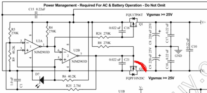

did some upgrades on the O2 and powered it up, was getting no sound. Found a small short over D(rain?) and G(ate?) on Q2. Upon powering back on same deal.
As im not familiar with mosfets is there anything else that may have been affected up/down stream? Im unable to easily remove U1,2,3,4 to test as they dont have sockets.
Thanks!
You should have +12 volts on pin 8 of all the opamps and -12 volts on pin 4 of them all. Every other pin on the opamp should read zero volts DC.
Measure from the main audio ground such as the ground tab of the input sockets. Ground (gnd) is marked at many locations on the 02 circuit diagram. Any of those points are OK to work from.

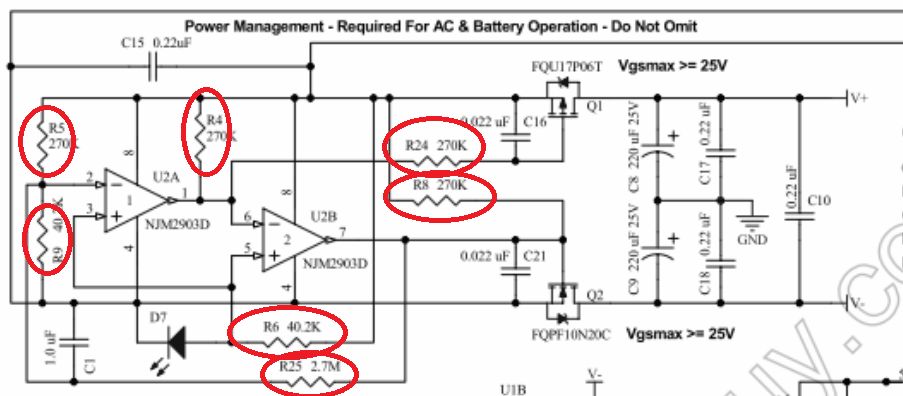

Thanks for the insight Mooly. Only opamp getting +/-12 was over U2. Diagnosed all the resistors in the power management section are open ended.
Ill order the entire power management replacements but any other components downstream damaged do you think?
