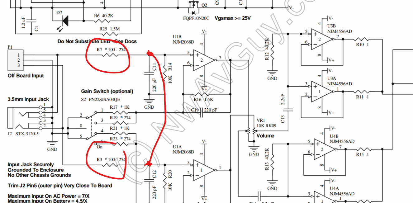

We would have to start again with the process... 12 months ago is a long time to pick up on.
R3 and R7 though. Look at the circuit.
If you link those as I suggested then you are linking L and R channels directly at the input to the circuitry. The result has to be mono if you still can hear normal audio at the output. If both channels are not identical in output (whatever that output may be) after doing this then that would point to a problem further in to the circuitry... but that would be unrelated to any previous work you did around the sockets.
I completely understand, thanks for being wiling nonetheless! I tried shorting with a wire on either side of the legs, with the input soldered to P1, rather than J2. I wasn't sure if the side would matter (for R3/R7) so I tried both sides to each other, from the portion of the legs that is above the PCB. Should I try shorting again from the bottom, where the legs are soldered through?We would have to start again with the process... 12 months ago is a long time to pick up on.
In talking about this with passing, someone suggested, as did you, that something might have died earlier in the chain. Any choice culprits that would be easy enough to test for there? It just seems odd to me that I had no issues before the change in jacks, then they appeared, but it seems completely plausible that something else may have died in the short procedure, especially given the issues. Is there anything else that you would recommend I check? Hopefully I'll have some time after work.
You have to be logical with fault finding 🙂 If we try a quick check like linking the resistors and that doesn't do what we expect then we have to begin with basics and work from the output stage forwards towards the inputs.
Linking those resistors is the same as linking pins 3 and 5 on U1 (always keep looking at the diagram to see it makes it sense). So i would try that, link the pins and see what output you get. Whatever you hear in the headphones should be identical left vs right.
If it is not then we jump further in toward the output stage to see why not.
Try that first though. Link the pins on the IC. You can do that on the underside of the board where the socket is soldered. Double check you have the correct pins linked before powering it up again.
So, I went to test connecting legs 3 and 5 out on U1 with wire, and no dice. However, I did retest connecting R3 and R7 again, and I did in fact get a result! The audio stopped on both channels, which suggests a short, if I'm not mistaken. With that in mind, what should I be looking for?
It could be a short somewhere. With it switched off try a quick resistance check from pin 3 to ground and then pin 5 to ground. Does either pin read short circuit to ground?
With it on also check that the DC voltage on each pin of the chip (apart from pins 4 and 8 which are the supplies) is zero.
Tested resistance from pin 3/5 to ground on J2, both measured at around 11ohm. When powered on, get 11.8x volts on pins 4 and 8, everything else measured at 1-1.5mv.
The voltages are good
Pins 3 and 5 resistance checks suggest a problem. 11 ohms is very low. Look at the circuit and try and follow this...
You are using J2 ground (that is OK to use) but only seeing 11 ohms to pins 3 and 5. So a couple of things to check are:
1/ That you still read 11 ohms to the relevant IC socket pins with the IC removed. That's an important check because I don't know how your meter responds to the presence of other in circuit parts like the chip that may appear in parallel to what we want to measure.
2/ We also need to be sure your meter is reading correctly and that you are interpreting the results correctly. So as a quick check your meter should read 1 ohm if you quickly measure those resistors at the output IC's.
3/ Assuming the 11 ohms is a real result you now need to check the resistance between ground and pins 1 and 3 of plug P1.
Keep looking at the circuit.
If you have 11 ohms at pin 3 and 5 you should see 11 ohms PLUS the value of the resistor R7 or R3 added to the result.
Fwiw, if you can't see any obvious problems anywhere then the most like areas are around those sockets.
A definitive test would be to lift the resistors R3 and R7 and to feed your audio directly into pins 3 and 5 thus eliminating all the sockets etc.
