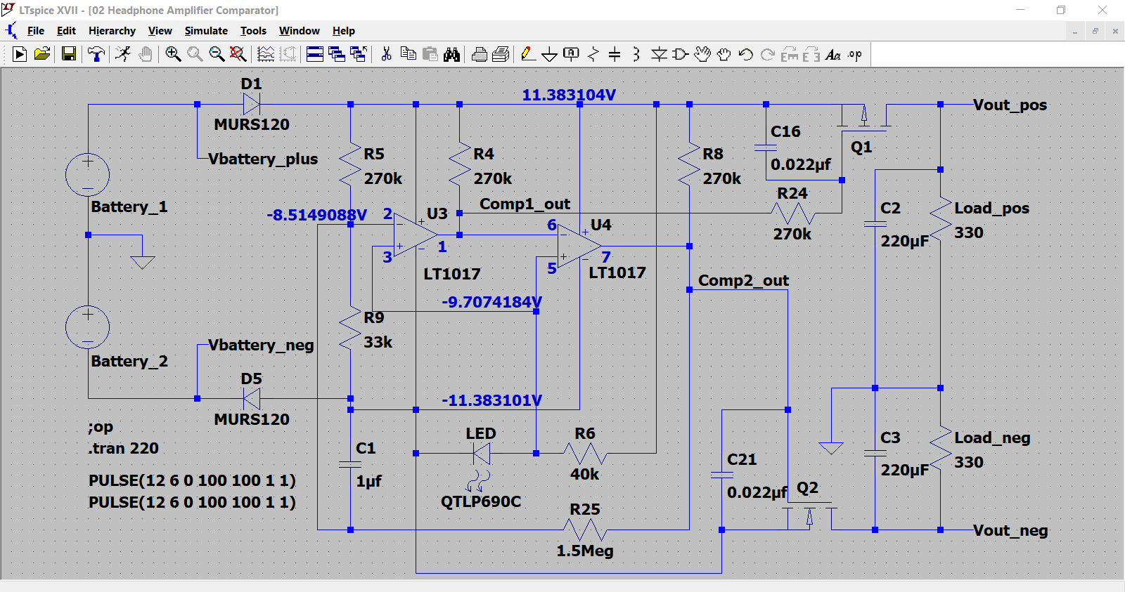

Don't replace parts 'on spec' hoping it will fix the issue... do some voltage measurements first. The resistors won't be faulty.
Pin 1 of U2 should be at minus 12 volts and pin 7 should be at plus 12.
Measure ALL the pins and post your results here and we'll see what is going on.
Pins 3 and 5 are critical and if you place your meter black lead on pin 4 and measure the voltage on pins 3 and 5 you should read around plus 1.7 volts DC which is the LED forward volt drop.
Everything depends on that LED voltage as to what the comparators do.

pins 1 and 7 which are comparator outputs are in the incorrect (rails off) state.
Pins 3 and 5 show a problem. These should be at approx minus 10 volts give or take as measured from ground. A reading of 0 volts suggests a short on those pins to ground somewhere as either the LED or resistor feeding the LED going faulty would not give 0V.
You need to look around pins 3 and 5. If you had 0V measuring from ground then you should be seeing something very different measuring from pin 4... yes 🙂 and you are not. Are those pins floating? such as with damaged print.
Look at the circuit. The LED goes to pin 4 and so you should see the same voltage on pin 4 as on one lead of the LED.
The other lead of the LED should be approx 1.7 volts more positive. In other words you should read approx 1.7 volts across the LED and the voltage you actually measure on the LED (whether from ground or pin 4) should be the same as you see on pins 3 and 5.
Look at the circuit and it will be clear what I mean.
I'll look in later but this might help.
These are the critical voltages and these are measured from ground in this simulation. Look how the LED voltage is applied to pins 3 and 5.
That voltage is a reference and is unchanging.

Well that was a fun troubleshooting experience. Cleaned up the board of flux and tidied up some solders. Studying the schematic i see your point about the LED voltage.
Found a broken trace from R6 to pin 3 on U2. Want to thank you immensely for your time in educating me! Not only saved me tonnes of time but also some cash.

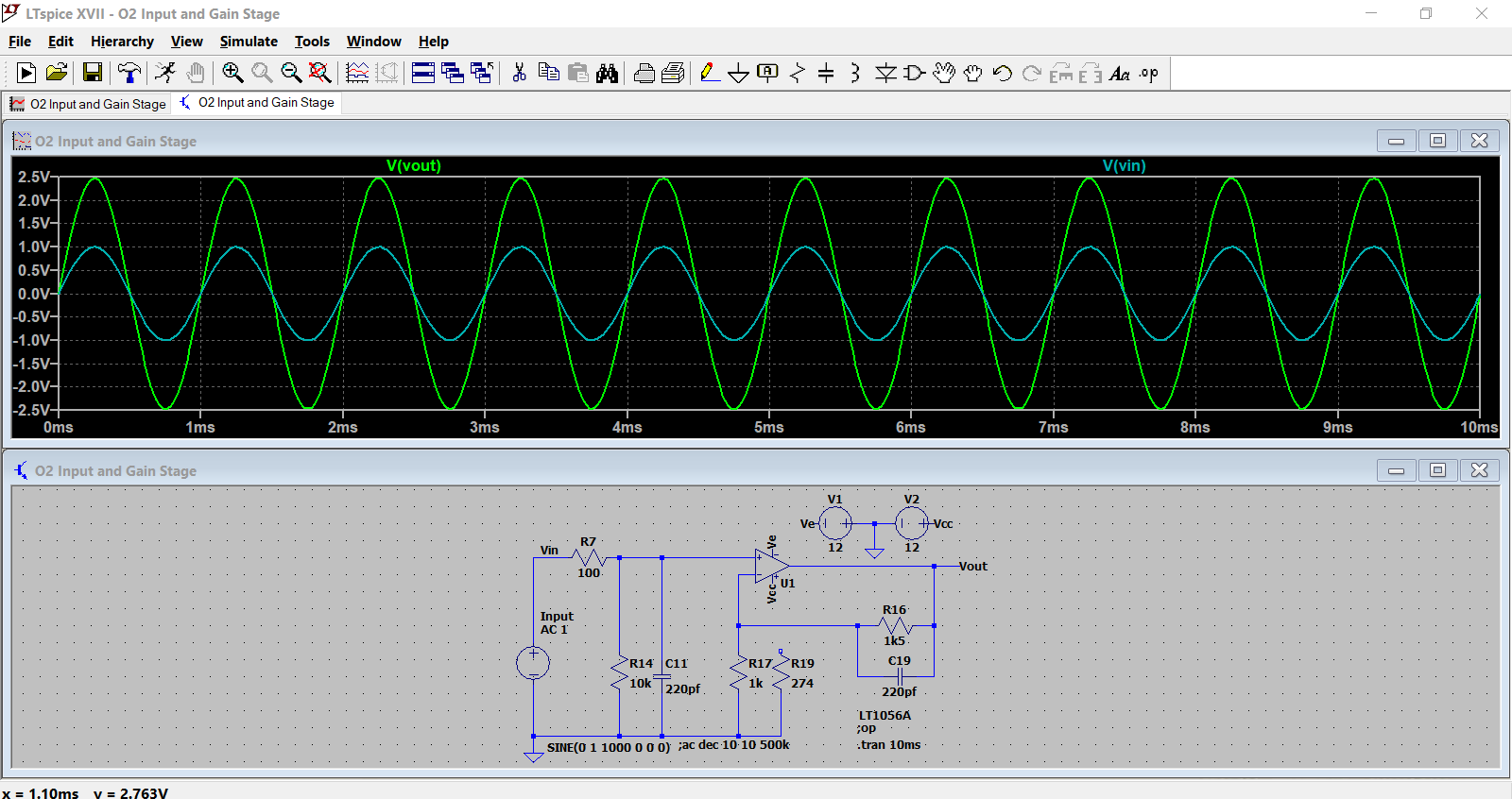

Using headphones with gain pushed in there seems to be a crackling crunch on piano notes even at very low levels. This seems to go away entirely with S2 out. Sorry i dont currently have resistor values used in my gain circuit.
Due to the O2's gain stage being up front, clipping is a function only of input level, gain setting and supply voltages - you as the user can do absolutely nothing on the amp itself that would improve matters. This is not intuitive.
If your high gain is 6.5X, input clipping level drops to little over 1 Vrms on AC and maybe 0.75 Vrms during battery operation.
Does the problem also occur at levels well below that? If so, either the feedback network resistors are badly misequipped (too low by at least an order of magnitude or more) or you might have a damaged gain stage opamp or another bad trace affecting one of its power pins (or the like).
If your O2 is equipped for gains of 2.5X/6.5X, I would generally advise scaling the feedback network resistors up by about a factor of 2 (while reducing the parallel capacitor by the same amount), as already suggested for the low-power version. So 3k32 instead of 1k5, 2k2/2k21 instead of 1k and 604 ohms instead of 274, with 220p being replaced by 100p of same type. Otherwise the NJM2068's output stage will break a bit of a sweat at high levels / high gain.
This is easily possible because as designed, the gain stage is insanely low noise without any good reason at all - how many sources can you name with output noise anywhere near either -122.7 dBV (20 kHz) or -121.1 dBV? (Typical DAC full-scale amplitude would be 2 Vrms = +6 dBV.) I mean, DACs with a dynamic range of 128 dB or even slightly higher do exist, but if you seriously need that, chances are your gain staging is thoroughly screwed up.
I bet you could even make the (notoriously wimpy) TL072 that failed so miserably on the master's tests work quite acceptably for the luls - with like 15k, 10k and 2k74. It still won't be perfect because even that (together with the 10k pot) provides an output stage load of about 6.4 kOhms, and you can see from measurements that it should really be around 10k, but it would be a great deal better than standard (1.5 kOhms) either way.

You can set whatever gain you want by choice of the feedback return resistor marked as R17 and R19 on the circuit. Leaving the resistor out gives a voltage gain of '1'. You can't go less than this.
Switch a resistor (lets say R17) into circuit and the gain follows the standard rules of:
Gain = (R16/R17) + 1
So 1k gives a voltage gain of (1500/1000) + 1 which is 2.5
Its trial and error to get the gain that suits your application best.
