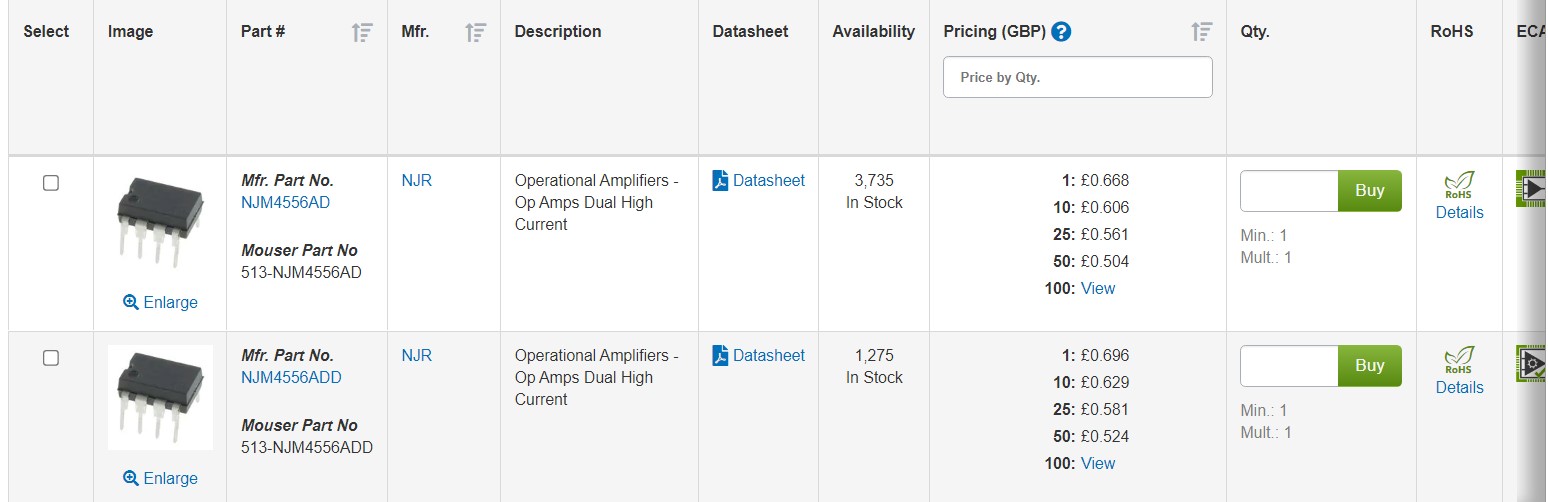

OK, so you are saying with the 2068 fitted that the voltages are now correct... very odd but it seems to prove the IC's are faulty.
The chips should be readily available all that will depend on your locality. You can fit other chips in order to get it all working.
4558's, NE5532's, 4560's even TL072's will all work in order to prove everything else is OK.
Look at the circuit... with the 2068 now fitted in place of a 4556 you could link either pins 5 and 7 or pins 3 and 1 of the original 2068 location (which is now empty) and you should hear music from whichever channel the 2068.
Mouser have them although I would suggest you prove it all good first by using something readily available such as the devices I mentioned:

I get +11 volts at pin 8, -11 volts at pin 4. All other pins are at 0V.
I could hardly call it music, more like very loud noise/popping and silently in the background some music coming through.
Are 4556's hard to get for replacement?
Yeah, it plays. Nice 🙂

I'll try to find alternatives in local stores, though I will need to ship the 4556's - i couldn't find any around.
So do you think that's what happened? Faulty opamps?

Opamps are pretty tough overall, so much so that its difficult to kill one unless you are very determined... so I don't know what has happened here tbh.
Could they be fakes? i.e. not even a dual opamp...
The only thing that bothers me is you mentioning the crackling when you moved things because whatever the problem is, it should be immune to physical inputs like that. I think all you can do is fit known good parts and see how it all plays out.

(and as to opamp indestructibility, the only things that will realistically kill an opamp are incorrect supply polarity and/or feeding supply voltage into any of the other pins when the main supply rails are missing. Even then you have to be very very determined to kill it off by ensuring lots of current is available and also that it has somewhere to go through the other pins... and once its supplies are present its all pretty much protected anyway)
