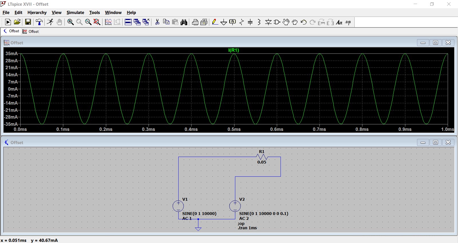

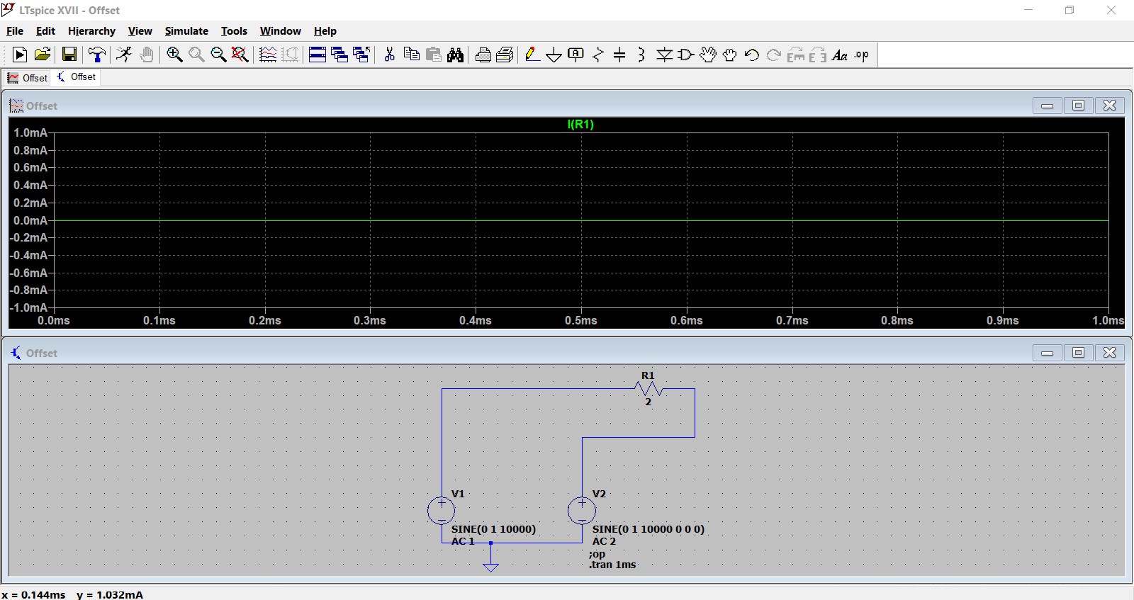

Look at these. Two voltage sources (they could be opamps) feeding a resistor between their outputs. The trace shows the current in the resistor.
Image 1 shows no current flow in a 2 ohm resistor. The signals are identical.

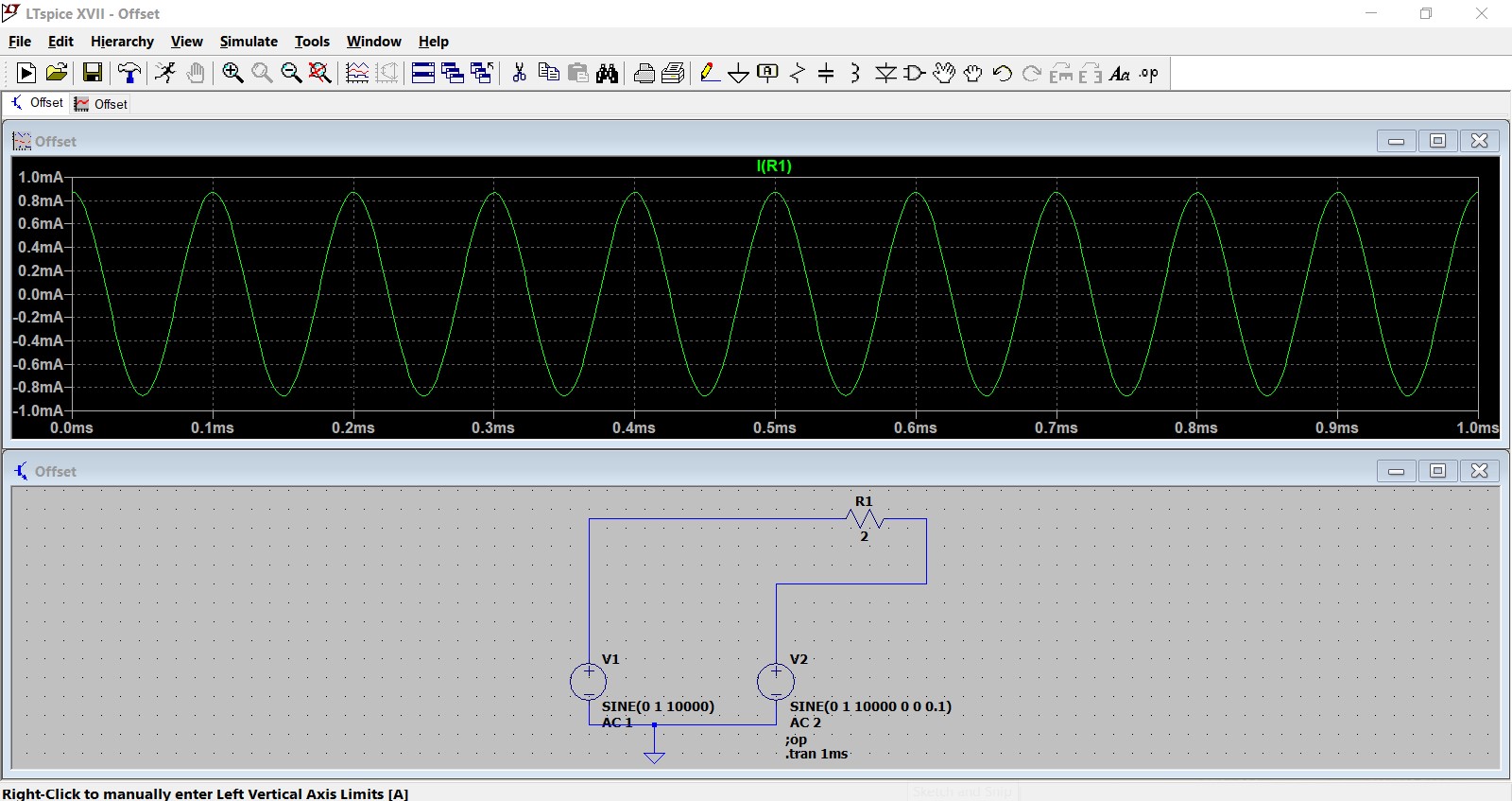

Image 2 shows a 0.1 or one tenth of one degree phase shift in the signal of one of the voltage sources. Look at the current now.
Image 3 shows the resistance now at 50 milliohms (that's a reasonable value for a bit of short thin print). Now look at the current.
In practice the higher the frequency and the more the opamps will differ. And remember this is showing just 0.1 degree difference in phase.

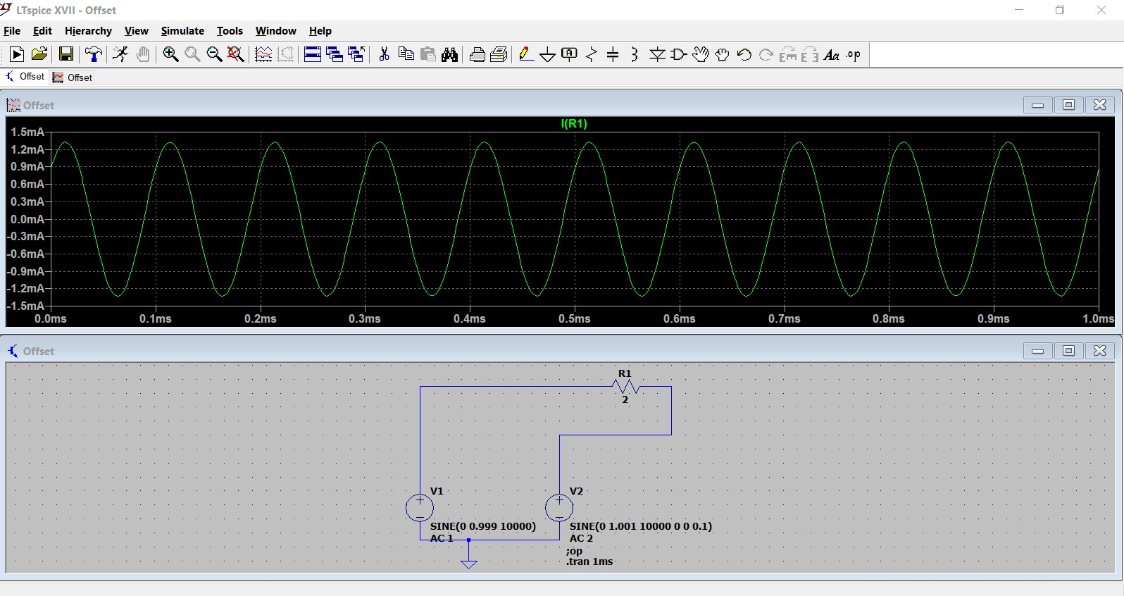

Image 4. If we add a 1 millivolt difference in amplitude per opamp from the 1 volt we used for the above images it gets even worse.
So the resistors are a vital component to even things out. They will also help with stability because even a couple of ohms is enough to tame any unpredictable HF oscillation that might occur.
Image 5. Same set up as image 4 but now back to 2 ohms resistance.

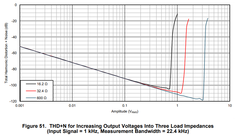

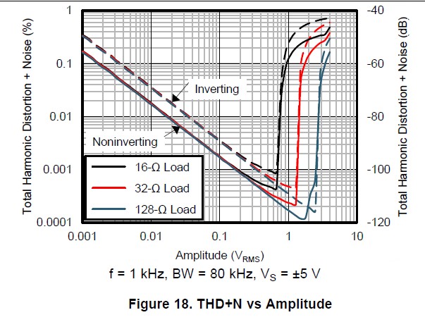

Mooly I noticed you did some tested a while back with LM4562 driving lower impedance loads.
Taking into account the lower output current, Do you think there is much reason the LM4562 would be any worse (THD+N) than the OPA1688 into 32 ohm loads?
It seems like the OPA1688 advantage is the increased output current compared to older generation of TI's audio op amps so it can drive down to 16ohm, in addition to being a low power CMOS device this makes it usable for driving low impedance, ultra high sensitivity IEM headphones in a portable application... but that is probably oversimplfying it.
While the LM4562 datasheet has no mention of low impedance loads, the OPA1688 still reflects dramatic increases in distortion into low impedance loads.
To clarifiy, any amplifier will distort more when delivering more power, but is there some reason the LM4562 or similar op amp intended by designer for ultra low distortion at high impedance would be worse?
This was about the closest anything came to answering that question, but still a long way off. OPA2134 already being slightly higher in distortion also shows almost double the distortion from a 2k to 600 ohm load in the DS. LM4562 shows no increase, same as OPA1688. From excessive heating of OPA2134 at 32 ohm in those tests its not even safe to say that is the true performance of the OPA2134.

The OPA is classed as 'rail to rail' which means it will ultimately deliver more voltage into a given load for a given supply... particularly when talking of low voltage rails anyway.
As to distortion comparisons into low impedance loads, well I would say the 4562 will distort well before the OPA as levels rise and again, particularly so on lower supply voltages. The data sheet shows the output set at 1vrms into 16 ohms which is a peak current of 88 milliamps. And all that on a supply of -/+5 volts. I'm pretty sure 4562 wouldn't achieve that.
are you sure you read that right? OPA1688 has short circuit output current 75mA , cant find where it says 1vrms into 16 ohm.
