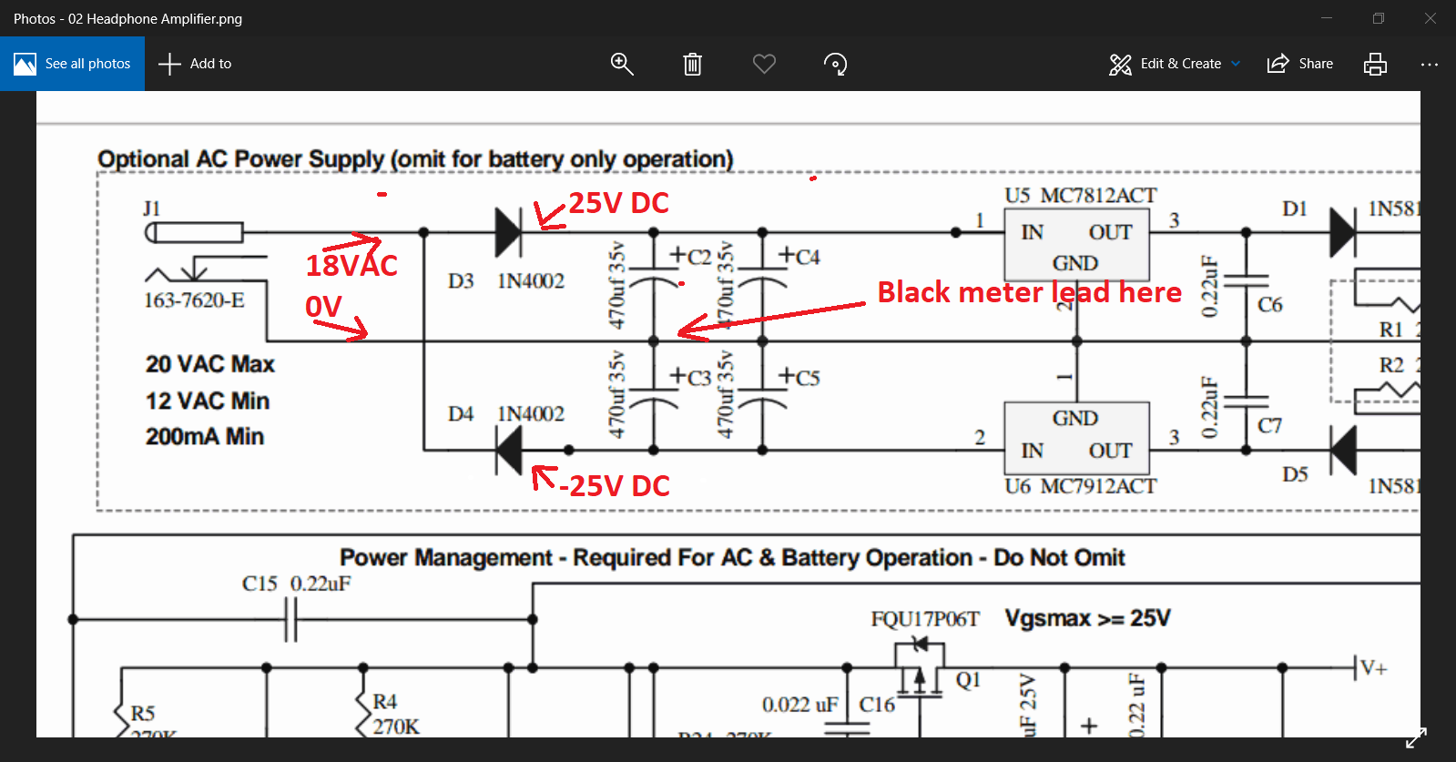

If you have 18 vac input on the board and no DC voltages on D3 and D4 outputs then there has to be a break somewhere.
If you put your meters black lead on the negative end of C2 and C4 (which is the main zero volt line) then you should be able to measure 18V AC arriving at both diodes and around +25 volts DC and -25 volts DC on the output of the diode.
You should also have continuity from C2/C4 (zero volt line) back to one lead of the incoming AC from the transformer.

Thanks Mooly. arriving at both diodes means non-striped end right?
Neg end of C2 and C4 to inlet (non-striped end) of D3 gives 18V AC, but neg of C2 and C4 to inlet of D4 gives virtually no voltage. Outlet of D3 has almost no voltage, outlet of D4 has 18V AC
The fact you haven't got those voltages means there has to be a break somewhere 🙂
You said there was 18V AC arriving at the board. That means each diode has to be producing DC at its output. If its not then the AC is getting there.
The inlet side of the diode is different for each rail. The positive rail has AC applied to the anode of D3, that's the non stripey end. The negative rail has it applied to the cathode of D4 which has the stripe.
Ok my fault entirely, I thought my Fluke 16 DMM was auto sensing. It wasn't.
Once I put it to DC it measured 24.2V DC at those points.

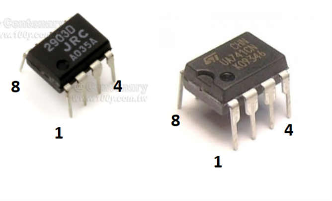

No DC at pin 4 or pin 8 (I'm guessing they're the pins opposite to the cutout).
So that's a U2 malfunction?

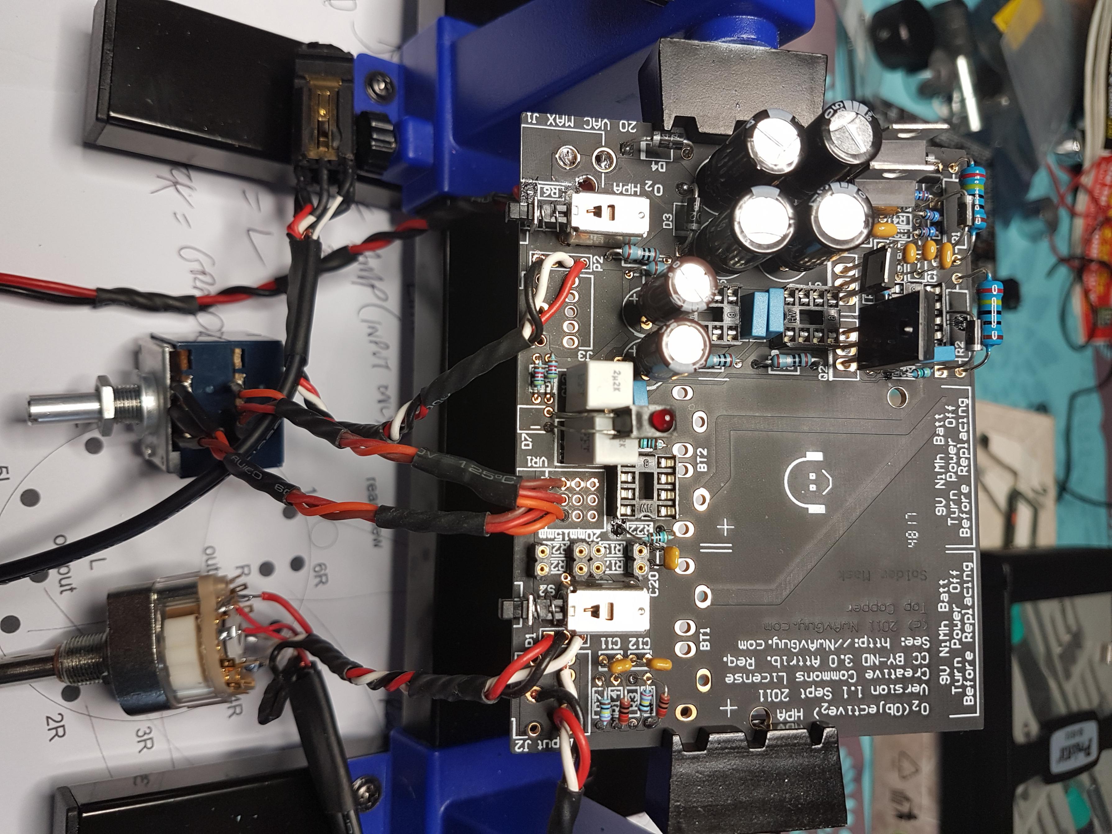

Here's a pic of the top of board in case anyone wants to pick apart my work
If you have the correct voltage on D1 and D5 then there are only 3 possibilities that I can see...
1/ Those two diodes are fitted wrong way around. If you have the correct voltage on both ends then they are correctly fitted. If you have voltage only on one end of each diode then they are wrong way around.
2/ Something wrong with switch S1
3/ You have break in both tracks carrying the supply to U2 etc.

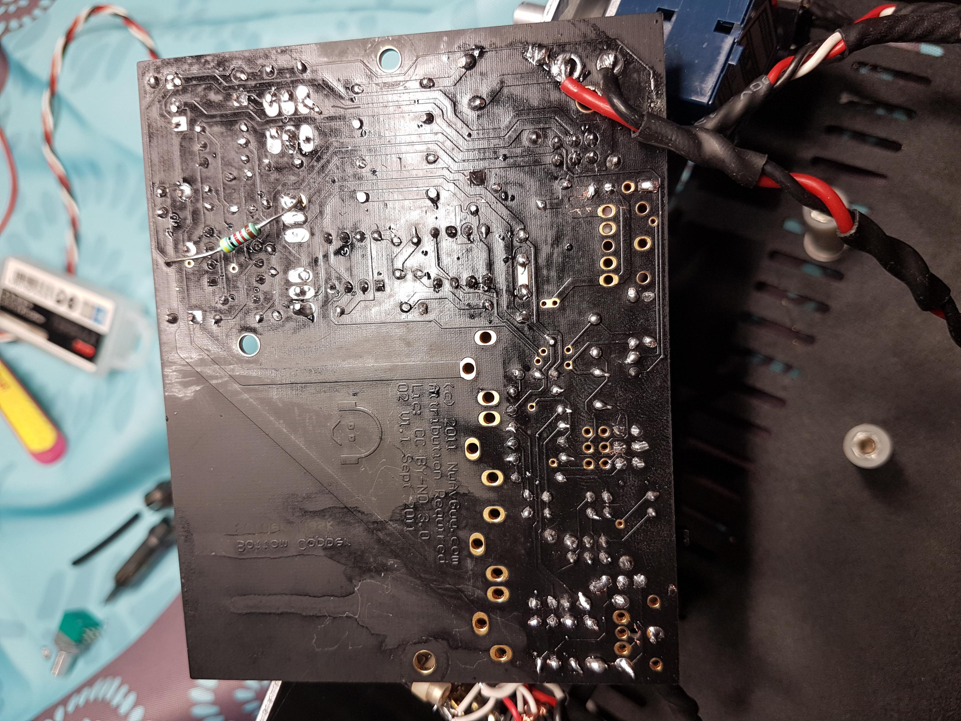

I may have found another fault.
Look at photo in #5384
Where I had messed up the placement of R6, I had followed the track around and replaced it on underside of the pcb. If you look closely at R6 top connection on my photo, you'll see a break in the track ( just past the black heat shrink of incoming power cables, visibly in the photo).
This connection goes to the small hole at the top of J3, which in turn goes to one connection of D7, which is not lit up.
Thank heaven I bought a second pcb as I can visually interrogate it for track runs.
I'll report back once I've done this repair, here's hoping....
I thought you were including U2 in the 'no voltages on pins 4 and 8'.
It sounds like you have made progress. There should +12 volts on pin 8 of all the IC's and -12 volts on pin 4 of all the IC's.
