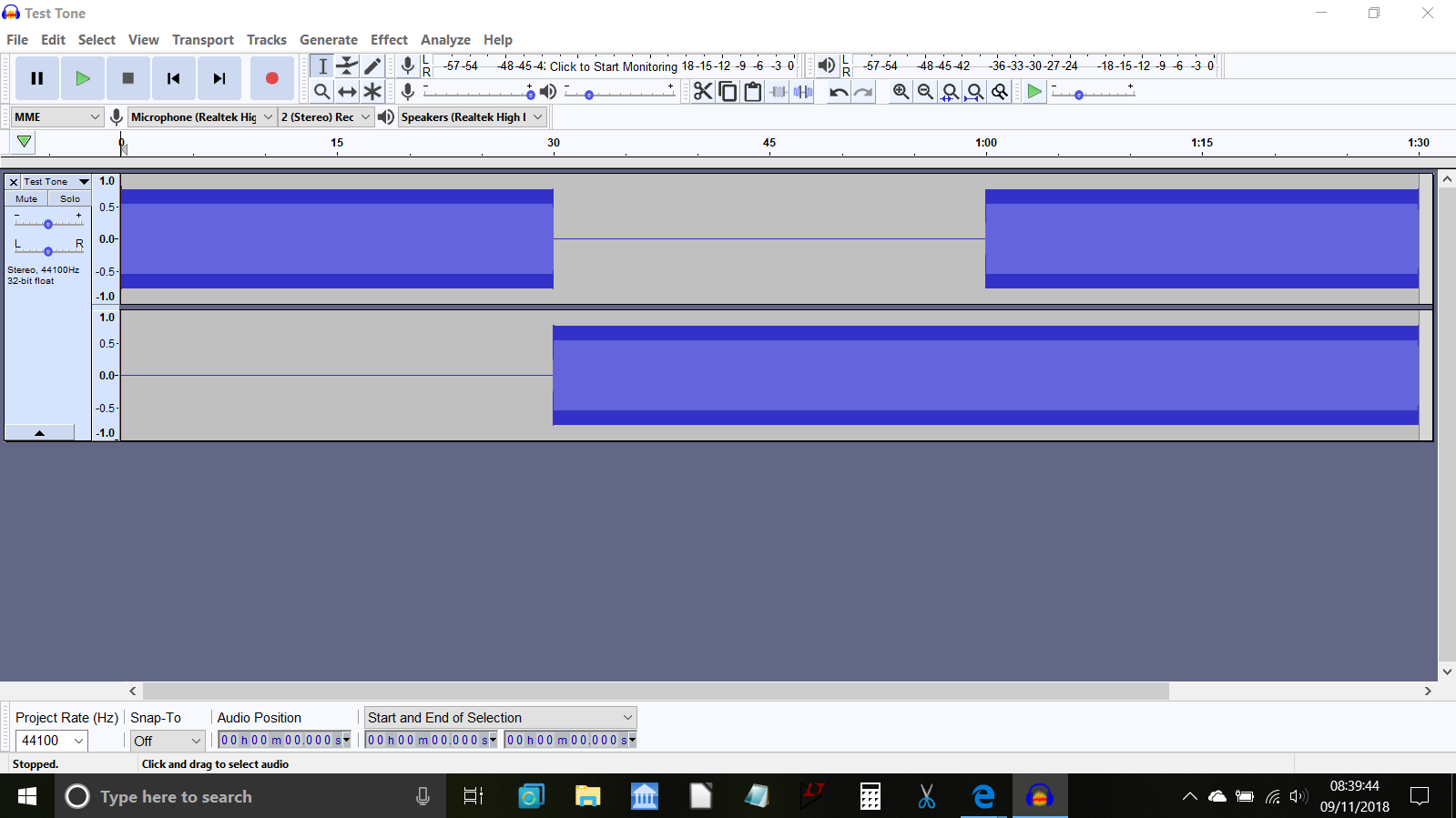

I did some testing, first I played used 500Hz Left then Right test tone. All the results came out symmetrical. Then I tested with a mono 440Hz; U3 and U4 gave no ACV. I checked if audio was coming through and it was. Now I am more confused 🙁
I'm not sure how you have this connected up but you need a stereo test track (tones) and not just to swap leads around.
Your test track should be say 30 seconds of left channel followed by 30 seconds of right channel followed by 30 seconds of L+R (mono).
You may be doing that already 🙂
No ACV ? Do you mean no measurable audio ?
Do you want an MP3 test track to use ?
I would like an MP3 test track thanks.
I played test tones via my phone connected to the 3.5mm input jack, I then tested the volts (P1, VR, U1/U3/U4/U2 and P2) in AC with my meter. When I tried playing a mono test tone I wasn't getting any volt readings from the U3/U4.
Forgive me I am a noob when it comes to this.
Yes, follow the signal through. You should see no L and R mixing anywhere in the signal path.
Just ran the test; couldn't find anything incorrect, can't see any L/R mixing not even at the P2 output. Testing with AC Volts on a basic multimeter probably doesn't help (0.1 AC Volts being the smallest measurement).
I wonder if connecting the headphones is creating a grounding loop.
N.B. Listening with the headphones - left is fine, right is mixed and mono is mostly right.
