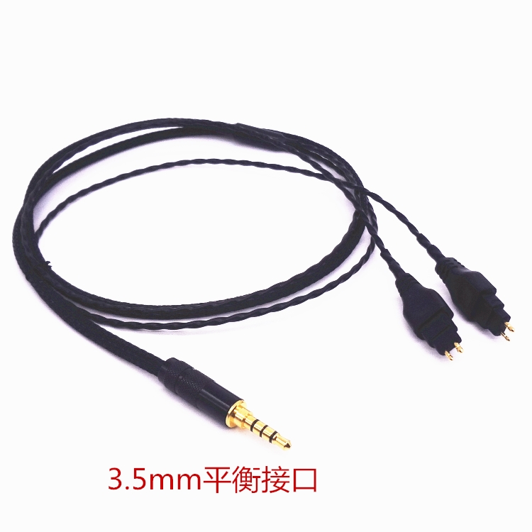

4 pole 3.5mm socket, using 2 ground pin for lower impedance. Will benefit the most if headphone jack was modified for 4-pole too. See picture.
