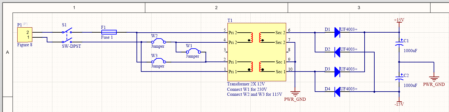

P1 - Figure 8 AC inlet
https://sg.element14.com/multicomp/jr-201s-pcb/inlet-iec-class2-fig-8-pcb/dp/9248161
S1 - DPST switch
2Pin 3Pin SPST SPDT Car Rocker Boat Switch ON/OFF ON/ON 2 Positions Red Blue Black Green 12V 6A/10A 250V/125VAC 19x13mm Mount -in Switches from Lights & Lighting on Aliexpress.com | Alibaba Group
F1 - Fuse holder and fuse 0.2A
10pcs/lot 5*20mm 5x20mm fuse holder with transparent cover free shipping-in Fuses from Home Improvement on Aliexpress.com | Alibaba Group
5x20mm 250V Glass tube fuse Fuse cutout 0.1A0.2A0.3A0.4A0.5A0.63A0.75A0.8A1A1.5A2A2.5A3A3.15A4A5A6A6.3A7A8A10A12A15A20A25A30A -in Fuses from Home Improvement on Aliexpress.com | Alibaba Group
T1 - 115V/230V to 2X 12V transformer
https://sg.element14.com/vigortronix/vtx-121-3023-412/2-3va-encaps-transformer-2-x-115v/dp/2817631
D1 to D4 - Ultra Fast Diode
https://sg.element14.com/multicomp/uf4003/rectifier-single-1a-200v-do-204al/dp/2675014

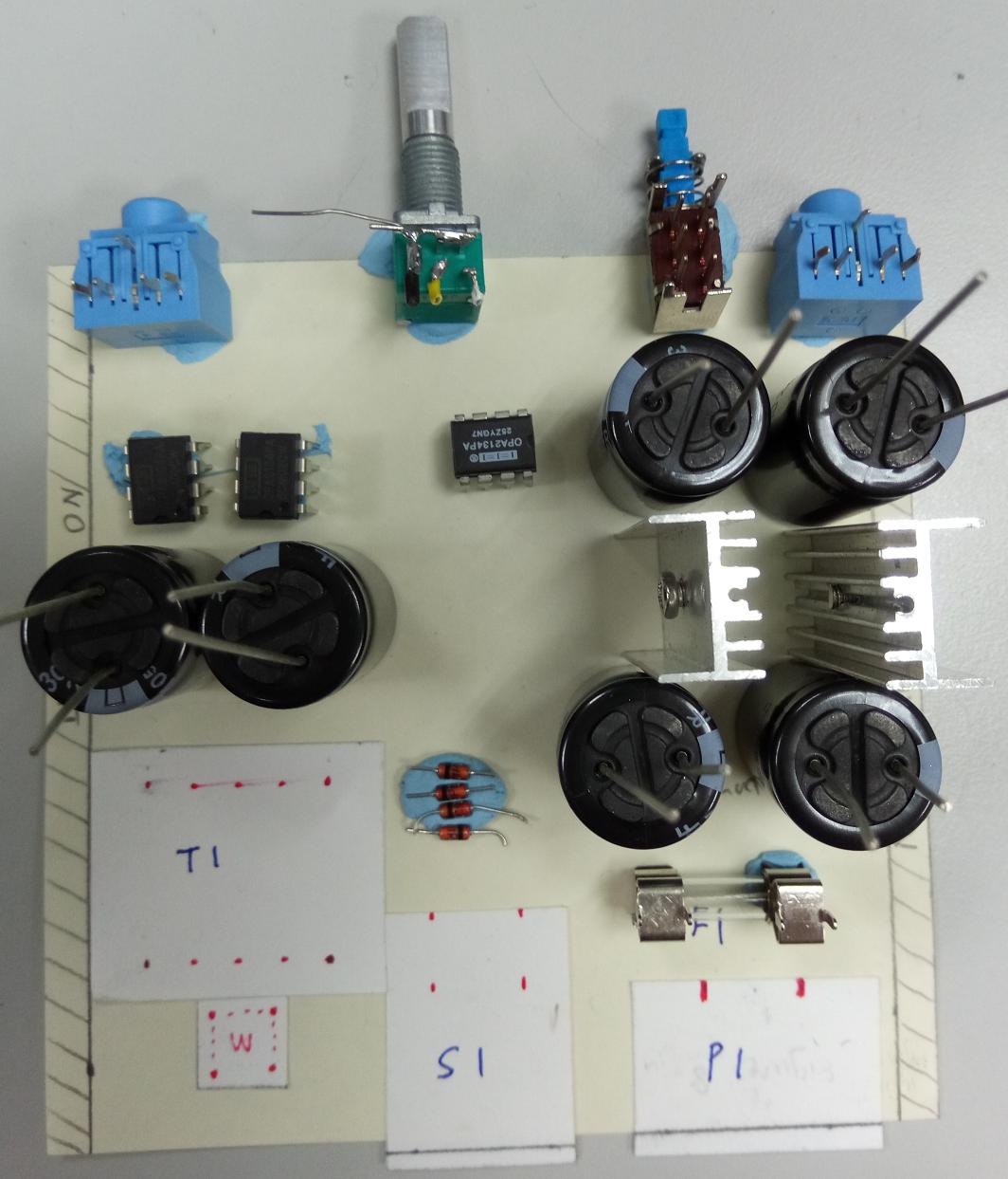

Tomorrow will try paper cut out to see the fitting of the above components.
According to the paper cut out, all should fit in this case.
YGS 010 106*55 100mm (WxH D) design case box electronic extrusion aluminum metal electrical enclosures-in Connectors from Lights & Lighting on Aliexpress.com | Alibaba Group
Only 90mm width of the PCB is able to use when using the above enclosure.

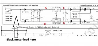

I'm also not sure if when I did the measurements I used a correct ground, since I did not understand what you meant by the collective ground of all the caps (where should my black lead be touching?)
Like this. The black meter lead goes on the main ground connection that runs throughout the amp.
Point A should be > +15 volts DC
Point B should be > - 15 volts DC
Point C should be approx +12 volts DC
Point D should be approx - 12 volts DC
Thank you very much.
So I got +11.1V DC on point C and -11.7V on point D.
On the points after that (the opamps 1 and 8) I got 10.5V on the positive point and -11.1V on the negative. What would be your suggestion (since it is lower than 12V)
