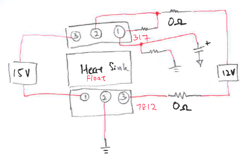

Jason, sounds perfect, but what would be the schematic, please? Caps will have a better ripple and voltage, also what case will be used? A different power transformer as well, right?
From personal experience, JRC/NJM 7815/7915 are having a lower noise and better ripple rejection than LM317/337 and it would also be easier to implement.
I think agdr did this mod in a previous post, I think it was +/-15V with different caps on rails and RC filter (he cut the PCB on the back), but having a new PCB might be a good idea, especially if it can fit inside original O2’s case (of possible).
Hi Raoul.
I'm still building from scratch using Altium so won't be so quick in outing the sch. The caps I'll be using low impedance version, rated 25V for the 15V supply and rated 16V for the 12V supply. I will implement 2 footprint in my design to cater either 317/337 or 7812/7912, see attachment.
The case I'll be using is meant for 100mm x 100mm PCB, which is plentiful in China. Since it's meant for desktop, I would not want too low of the height on the case which I prefer to put bigger cap. O2 original PCB is 100mm x 80mm, case 100x80x30mm.
The +-15V supplies will be from 2 15V SMPS, connect them in series to get +-15V. Which I believe should be much easier to get nowadays. Or choose 2 wall outlet that output 13.5V ac, will build a rectifier circuit inside. Still thinking should I put a safety relay when both adapter is not plug in.
