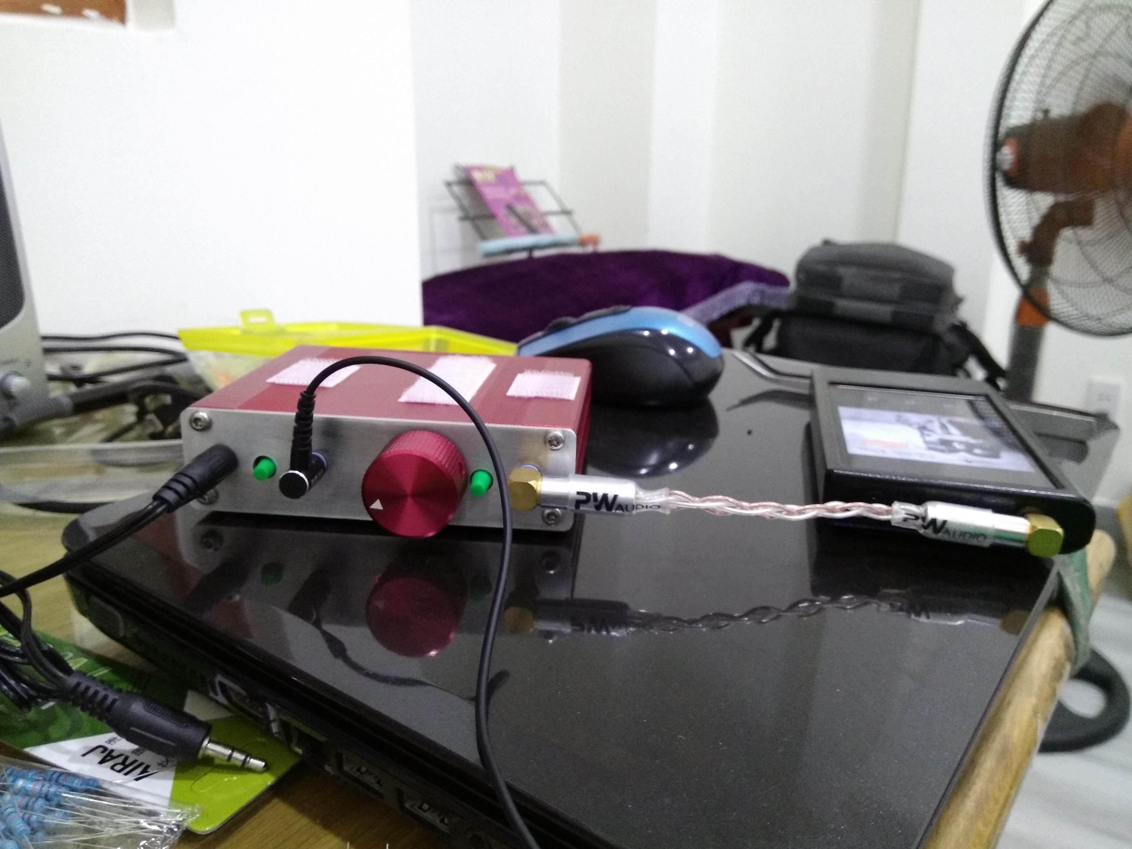

Thanks so much for the help, but after struggling to find the problem. I gave up and just rebuild a new one, and some how this pops up

Just as you thought, the negative channel FET is dead. I replaced it with a new one and it sings okay now. Thanks again 😃
