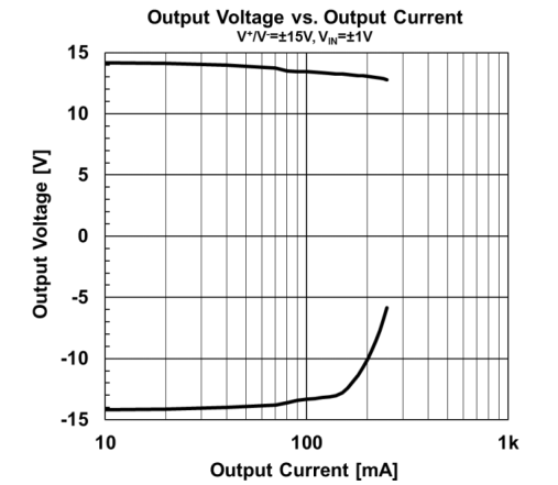

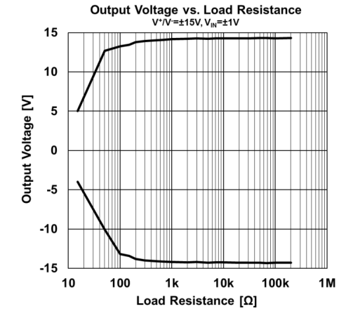

Having a look today over the new MUSES03 and just realised that could be a good candidate for output buffer against the 4652. Has a max. output current of 250mA, dissipated power of 875mA; if 2 x MUSES03 can get along when paralleled then the max. output current would be 0.5A, so a theoretical 6-7V RMS/32 ohms might be achieved...of course with some small heatsinks on top of the opamps. I would be more than happy with a clean 5V RMS/32 ohms if there's no overheating from the output buffers; that would give me about 850mW/channel, quite OK I'd say. 🙂

Now I wonder who's going to pay for 4 of such opamps and have a test. 🙂
