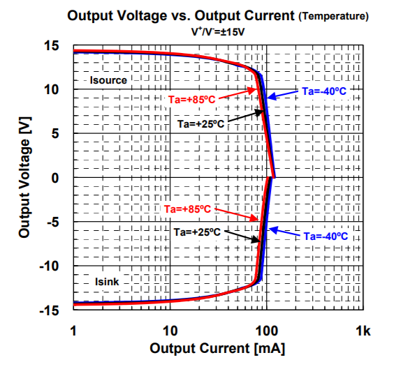

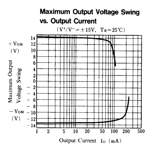

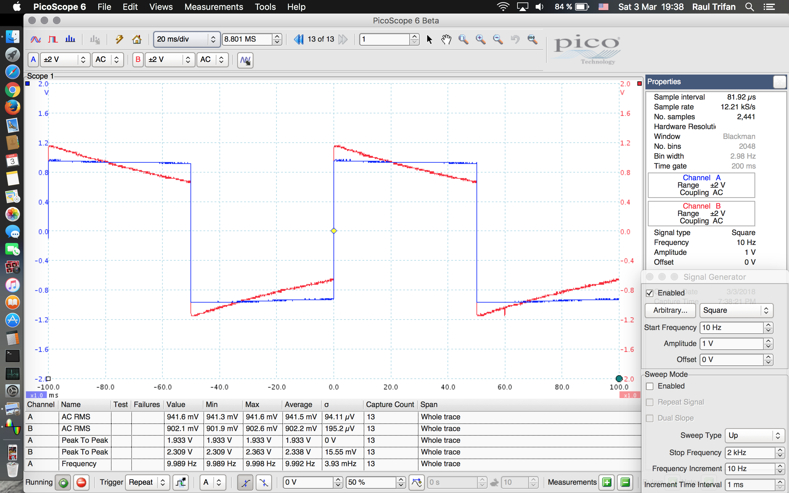

BTW, just replaced this weekend the NJM4556 with MUSES8920. I know, a bit lees of output current, but not much actually...feel free to check the below pics:
NJM4556 vs.
MUSES8920

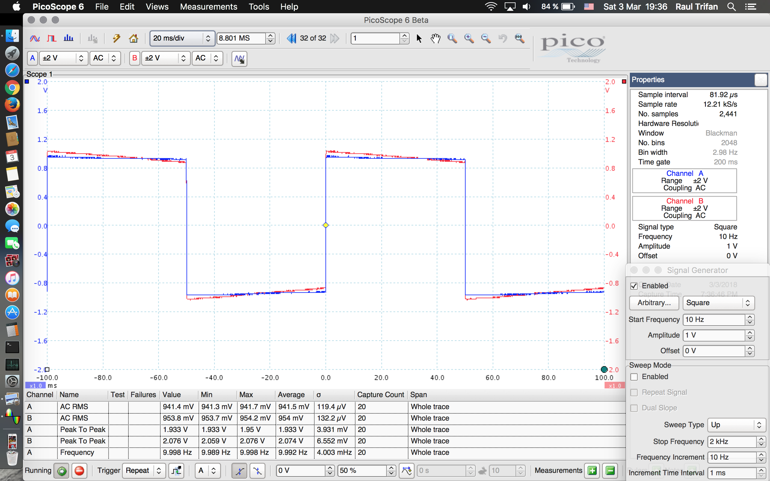

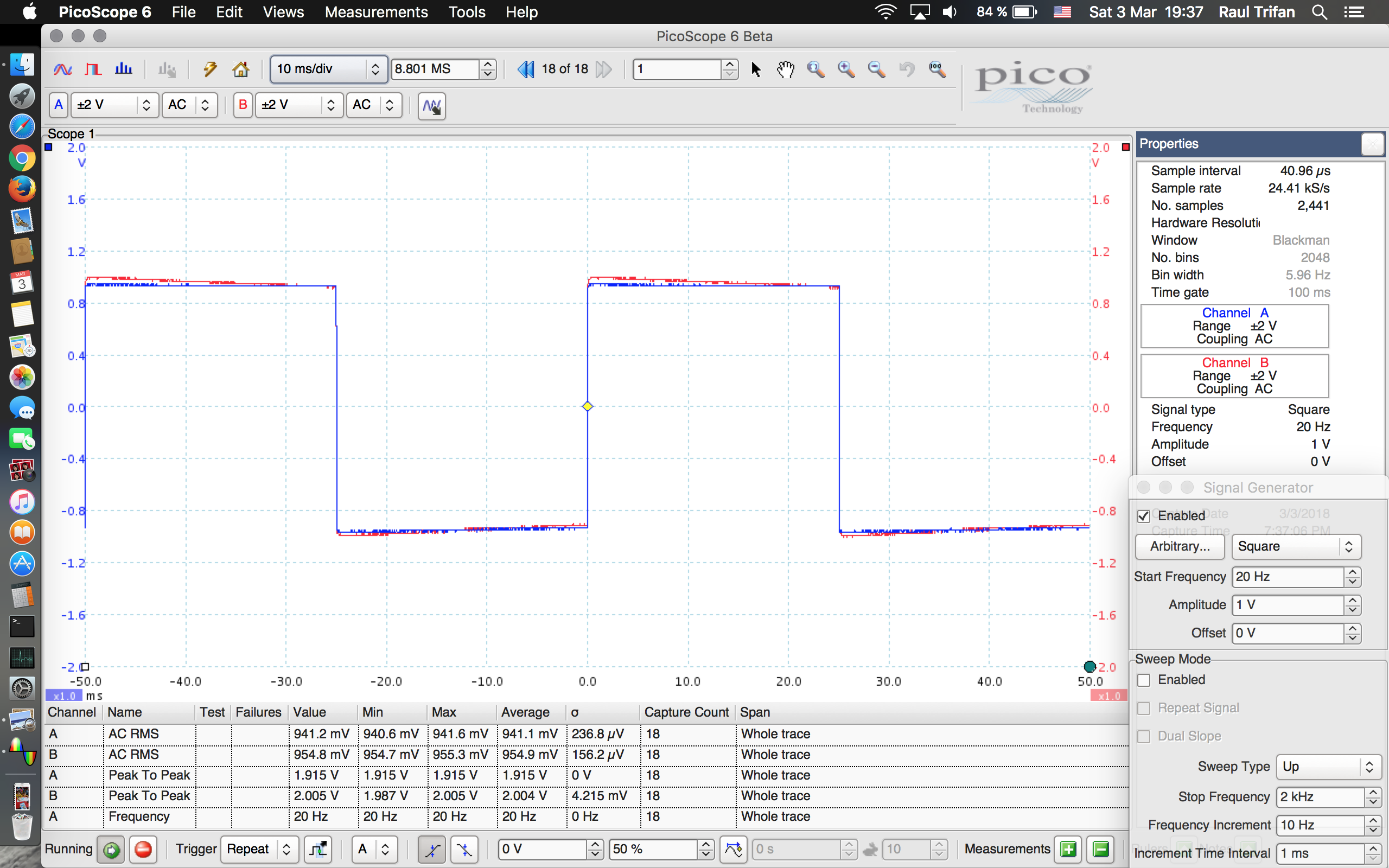

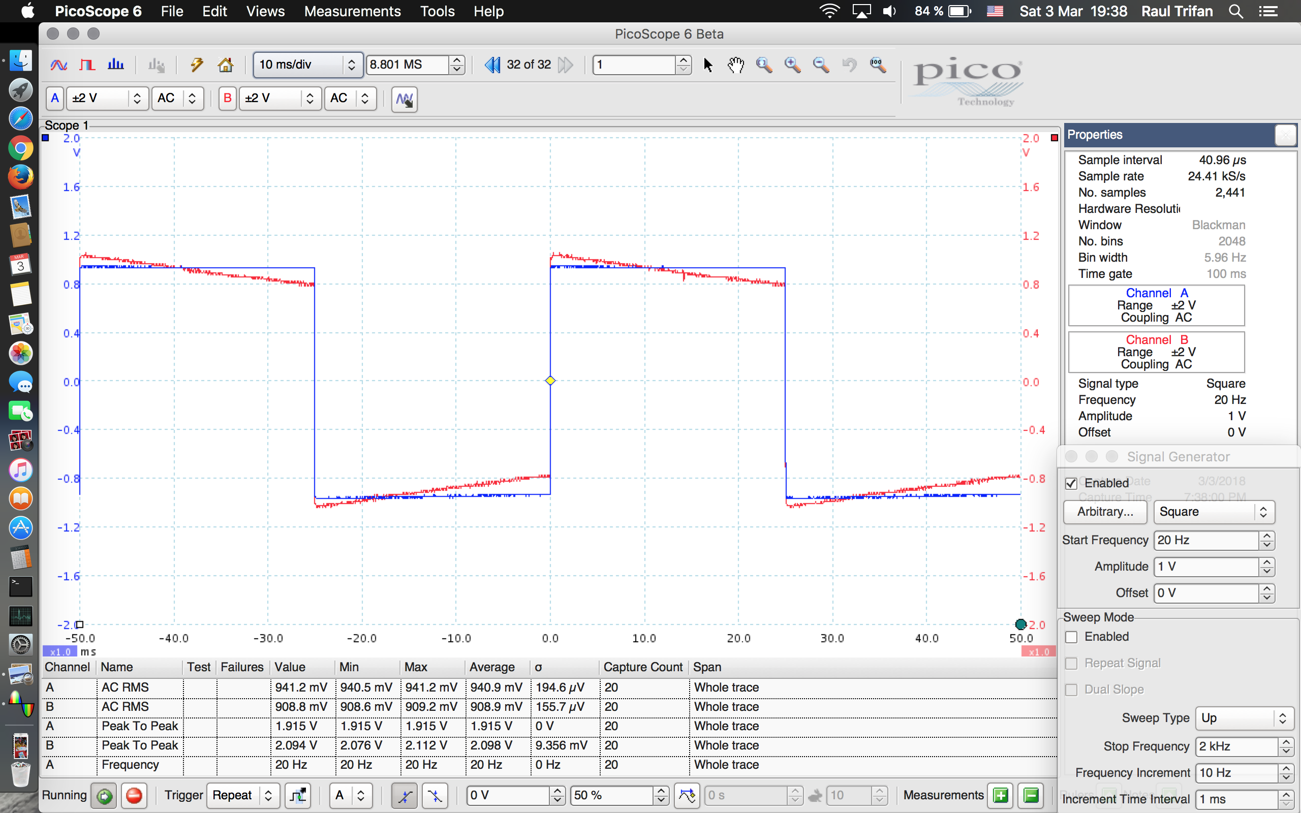

However, I've also changed the R12 & R13 resistors from 43 kOhm to 192 kOhm (by adding 150 kOhm)
NJM4556 @20Hz
MUSES8920 @20Hz
NJM4556 @10Hz
MUSES8920 @10Hz
MUSES8920
NJM4556 @20Hz
MUSES8920 @20Hz
NJM4556 @10Hz
MUSES8920 @10Hz

The difference in LF response is due to the 2.2uF cap and differing R12/13 values, not the opamp.
Yes, of course is from the Low-Pass filter created by the 2.2uF and the resistors.
Sorry for not being clear: changing the R12/R13 resistors may increase the output DC voltage, which actually happened to me. It got increased from 3mV to 12.5mV per each channel. So, I replaced the opamps from the output buffers to decrease the DC-output voltage from 12.5mV to 0.2-0.3mV.

Need to mention that with NJM4556 I was able to get @30-ohms resistive load a clean sinewave of 3.8V RMS (after that it starts to clip because of distortions), instead with MUSES8920 I can get a clear 3-3.1V RMS, then starts to get a noisy-shaped top of the sinewave, then around 3.7-3.8V RMS it starts clipping. I would say that @30-ohms resistive load the MUSES8920 can deliver a perfectly clean 3V RMS per channel, so about 300mW instead of 481mW with the NJM4556.
