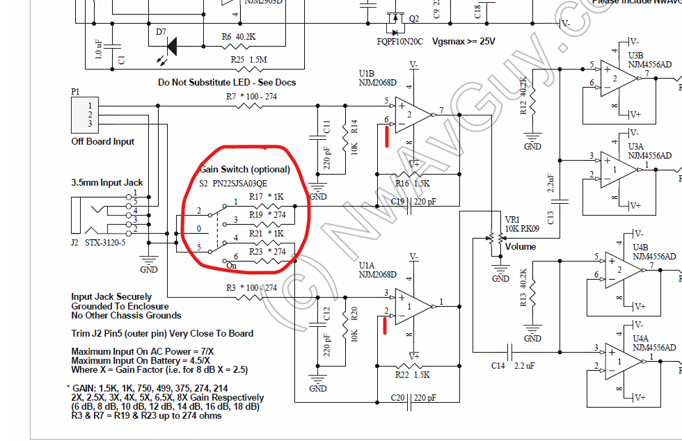

Hi all, I notice in the kit that came from Head'n'Hifi that there are some pins that presumably one solders into place and then the gain resistors push in place and can allow one to experiment with different gain values.
So: across which resistors do these pins get installed, and is there a list somewhere where the combinations of resistors show the gains?

All you are doing to change the gain is connecting a resistor from pin 2 and pin 6 of that front end opamp to ground.

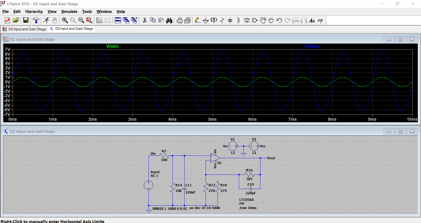

The formula is easy, divide the value of R16 by the value of the resistor you add to ground and then add 1 to the result. So with R16 fixed at 1.5k and lets say we pick 270 ohms for our resistor to ground we get 1500/270 which is 5.55. Add 1 and we 6.55.
Does it work... lets see. Here we have 1 volt peak applied, and the output is 6.55 volts. It works

Thanks Mooly, whats the front end op amp, where is it and how and where do I attach the resistor, and where are pins 2 and 6?All you are doing to change the gain is connecting a resistor from pin 2 and pin 6 of that front end opamp to ground.

Many thanks again Mooly, that shows me that the kit as supplied already has those components laid out and marked to give 2.5x and 6.5x.These are the gain setting resistors (circled). You can fit whatever values suit your needs. Here the switch selects either 1k or 274 ohms giving gains of 2.5 or 6.47

Optional Gain Resistor Pin Sockets – There’s an optional part in the BOM for allowing the gain resistors (R17, R21, R19, R23) to be replaced without soldering. These “SIP” pin sockets are bit tricky to align correctly and can be installed in pairs.
THE GAIN RESISTORS: Before you solder in the four gain resistors by the gain switch, you might want to consider different gains than the approximately 2.5X and 6.5X default values. You want just enough gain so typical music plays loudly enough with your headphones and source and not much more. Extra gain means using less of the volume control’s range, more noise, more distortion, and makes accidental headphone damage more likely. Here’s what you need to know about calculating gain:
- Lower Is Safer - Lower gain settings make the amp less likely to damage headphones by limiting the maximum output voltage to only approximately what’s needed.
- Lower is Cleaner – As shown in the first article, there’s a slight increase in distortion, especially at high frequencies at higher gain settings. Lower gains also result in lower noise.
- Resistor Values – The O2’s gain (for one channel) is:
Low Gain Ratio = 1 + R16/R17
High Gain Ratio = 1 + R16/R19
Voltage Gain in dB = 20 * Log(Gain Ratio) - Example – The standard amp has R16=1500 and R17= 1K so 1 + 1500/1000 = 2.5X. And 20*Log(2.5) = ~ 8 dB.
- Feedback Impedance – For many reasons it’s generally best to leave R16 and R22 at 1500 ohms unless U1 is replaced with a weak op amp that can’t handle a 1.5K load.
- See The BOM - Gain resistors are pre-calculated in the BOM parts list for gains of 2X – 12X. For 1X gain just leave out the gain resistors (or clip one end if they’re already installed)

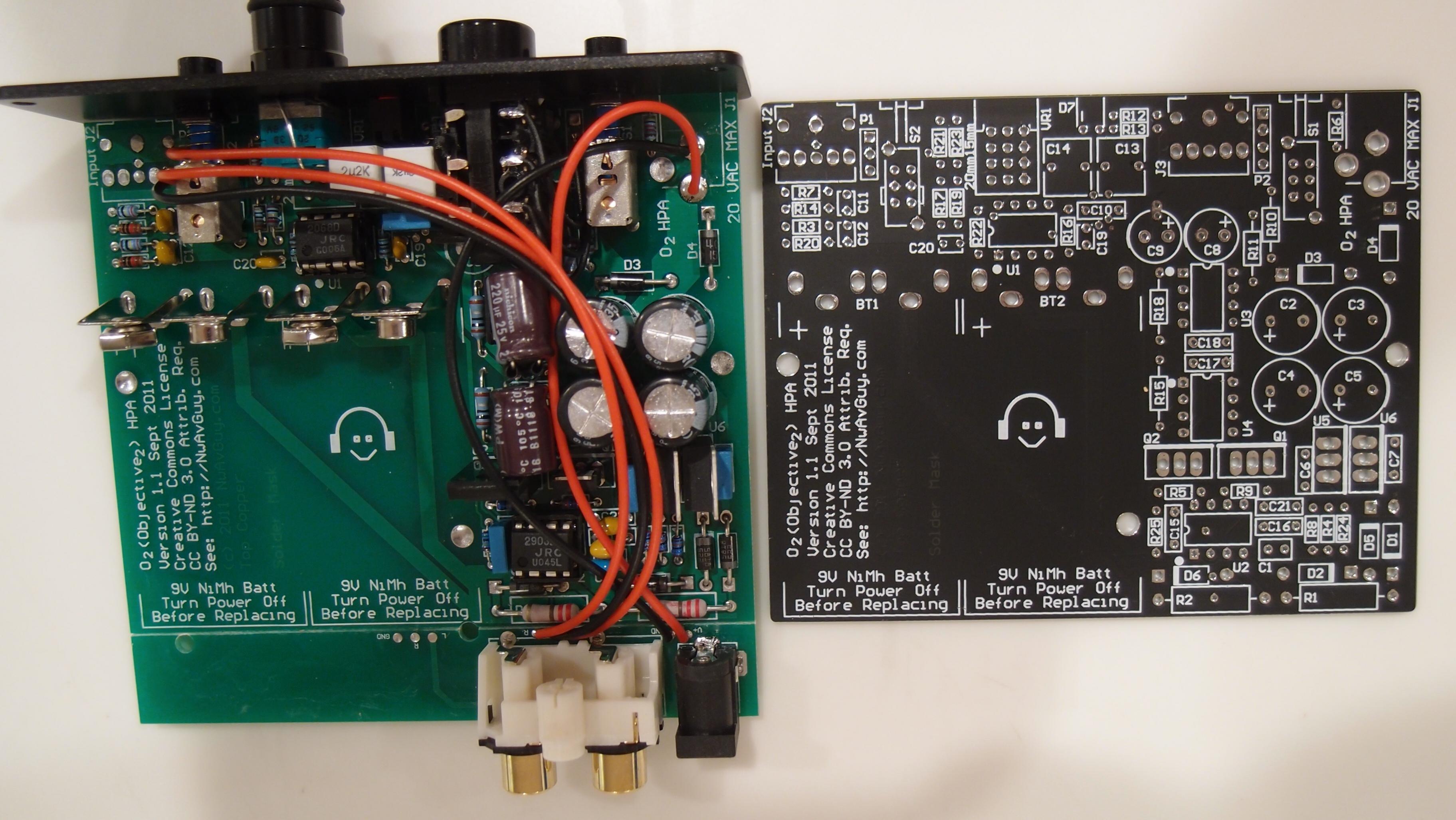

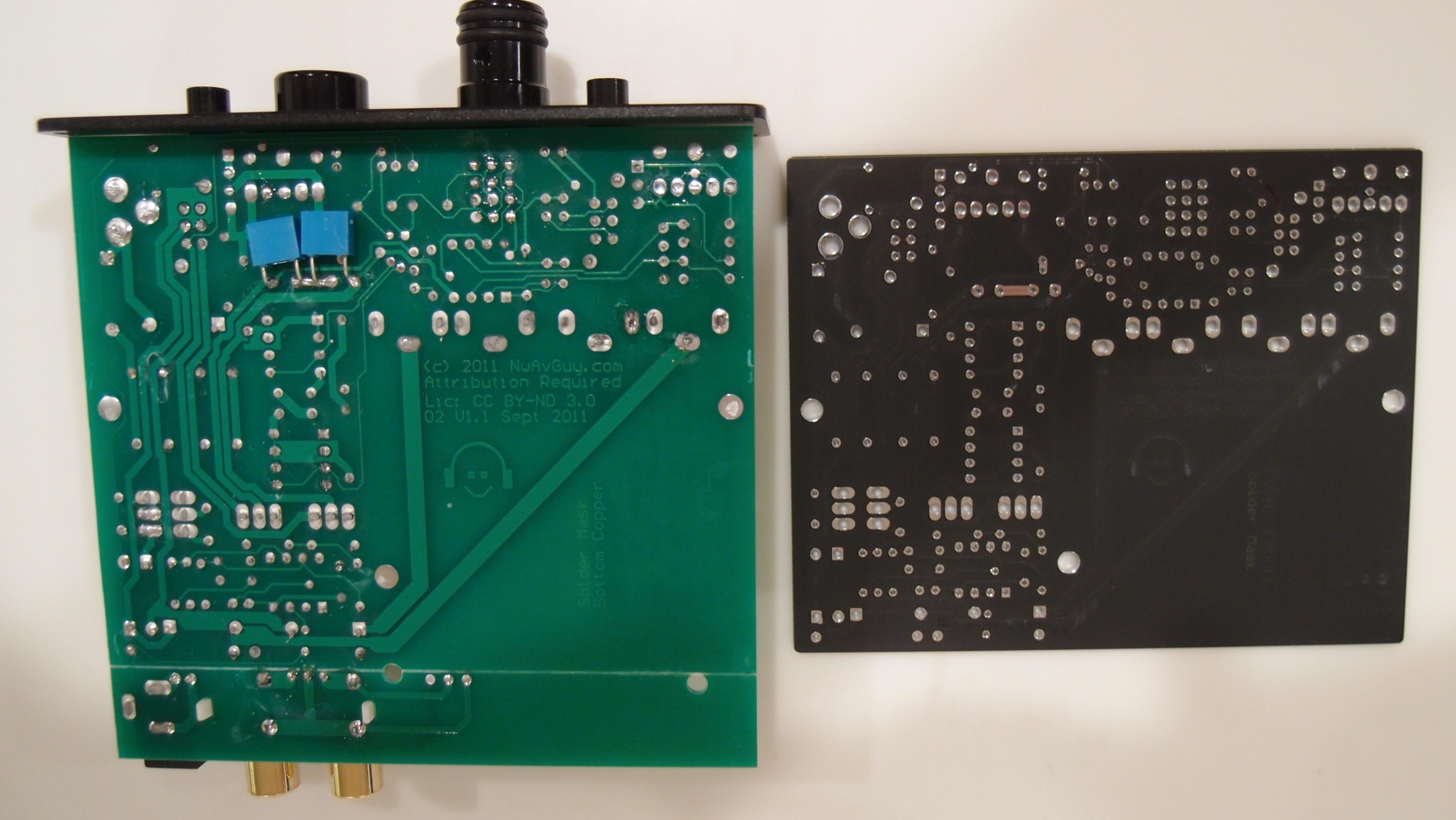

I opened up my massdrop O2 and have attached some pics. Looks to be identical with an add-on to the board for the rear connections. I was surprised to see the battery connectors on it, massdrop does not advertise these as portable. I did not test to see if there was any voltage there, but I don't see why there would not be. Nichicon caps throughout. I like this amp, dead quiet, though I have occasionally experienced some distortion, but that may very well be from other components in the chain.
Very interesting!
First time I've seen such a variation. The protuding added PCB estate at the back is actually quite clever. Looks like it has got input connections as well.
Looks also like C8/9 and the 4556's decoupling caps swapped places to accommodate the output jack.
Actually they do!
(PS. Well... to be fair, they do not advertise them as portable, but as battery powered)
