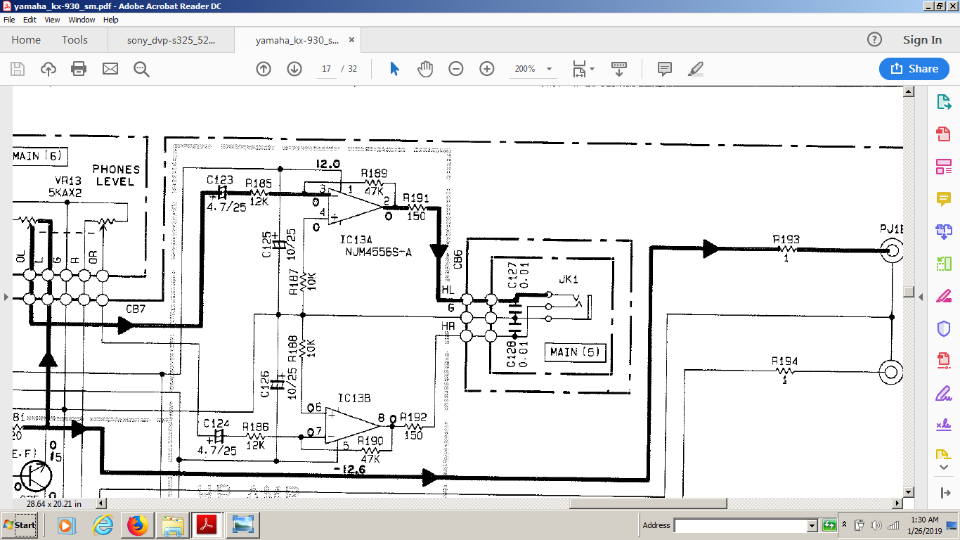

Please build the headphones amplifier as it is built in the Yamaha kx-930:
https://elektrotanya.com/yamaha_kx-930_sm.pdf/download.html
You have it also in a printscreen attached.You don't need to use the S-chip version, just the dd through hole version is ok.
Using the njm4556 in unity gain is a structural error .Nakamichi knew it when they used it with a 100k feedback resistor in the CR4 cassette deck to cancel the common mode distortions as much as they could.
I'm not sure I fully understand your statement, I see the same output buffer as the O2 and the same paralleled opamps, but with a much worse damping factor becsause of the output resistors.
Where did you see the same thing?
There's no paralleled op-amps, it's just an op-amp for both channels in the inverting topology.
If you don't believe me , just build it.It's just a f...op-amp and a few resistor and capacitors.By the way...you need no regulator at all! just a pi filter like 470uf-20 ohms resistor and another 220uf, any quality you need if you can't afford some good caps.
I used even lower feedback resistors 27k and 10k(approx 3x total gain)

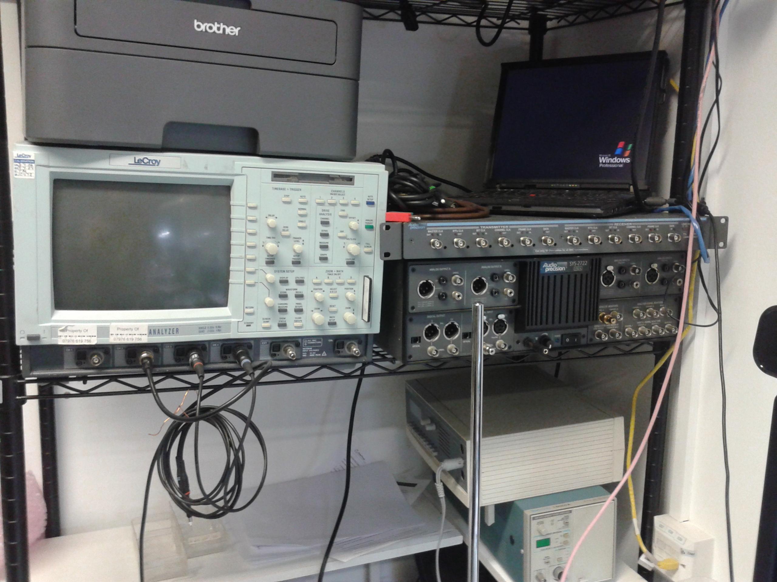

I also had the chance to use Audio Precision system one and two to prototype an amplifier for some electrostatic headphones launched at CES in 2016 , so i kinda know what are those measurement for...but analyzing the distortion pattern and its impact on human brains is a bit more than just measuring it and aiming for lowest figures on Earth.

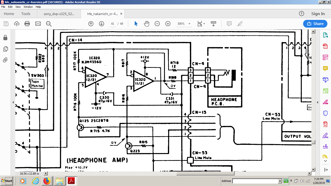

Look closely to the Nakamichi CR4 headphones preamp and try to figure out why does this thing need 2x 100kohm resistor 😉 That was one of the best cassette players out there, that sounds a lot better than most of the cd players sold in between 1983...2000.Fortunately the tape noise allowed the engineers to use 100k resistors to cancel the common mode distortions.If you need any help to understand that...read starting with page 105 the Small signal audio design by Douglas Self...He's really after the cheapest technology that deliver the best sound as he showed in some of the Soundcraft products.
Nobody was better than Nakamichi in anything analogue or digital for a very long time.If you think they just added those resistors for nothing, then i have nothing to add on this subject.

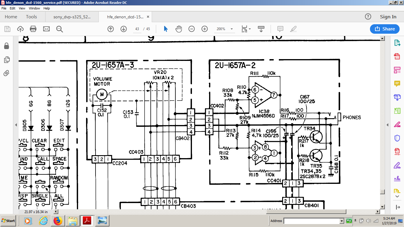

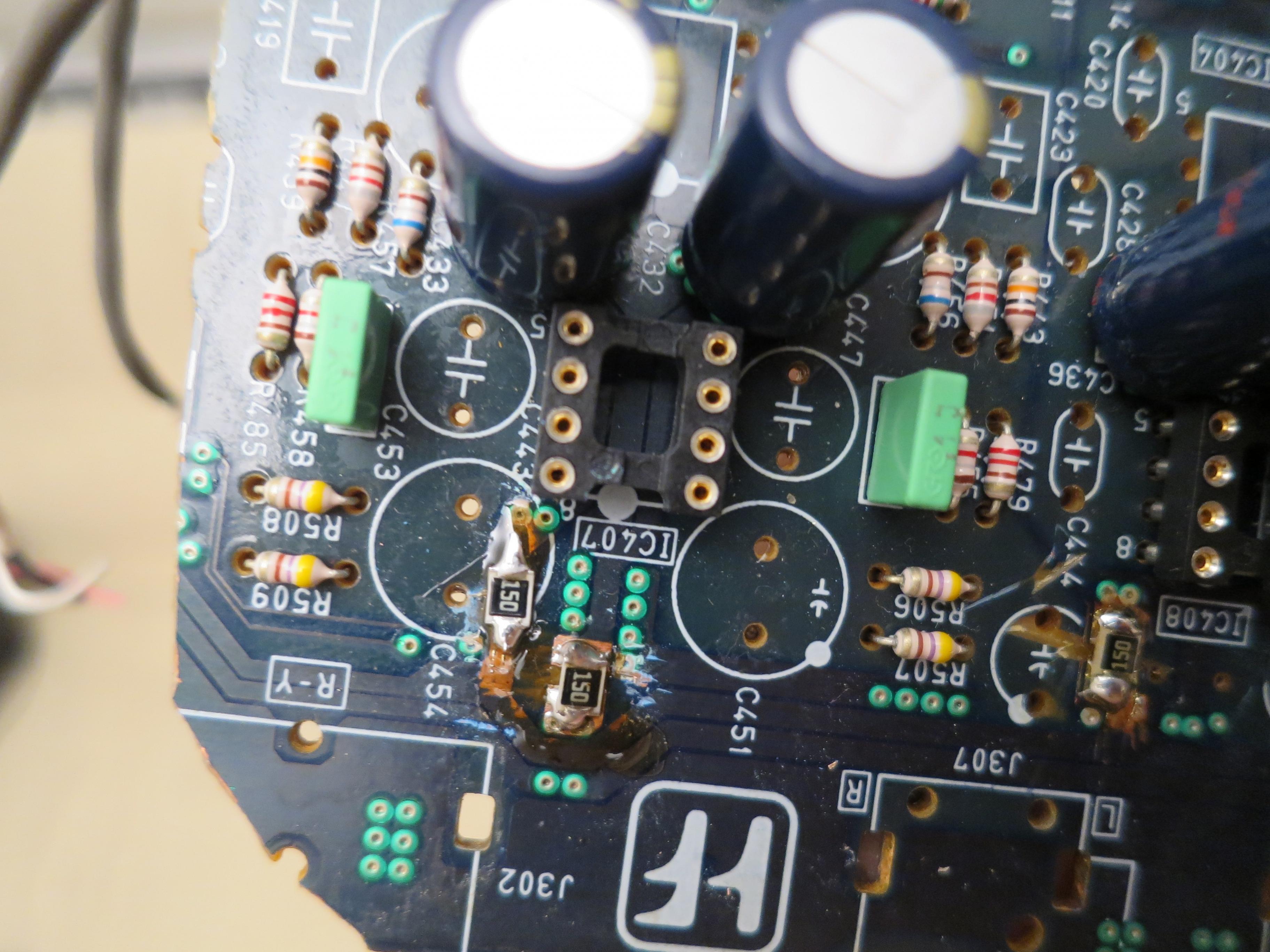

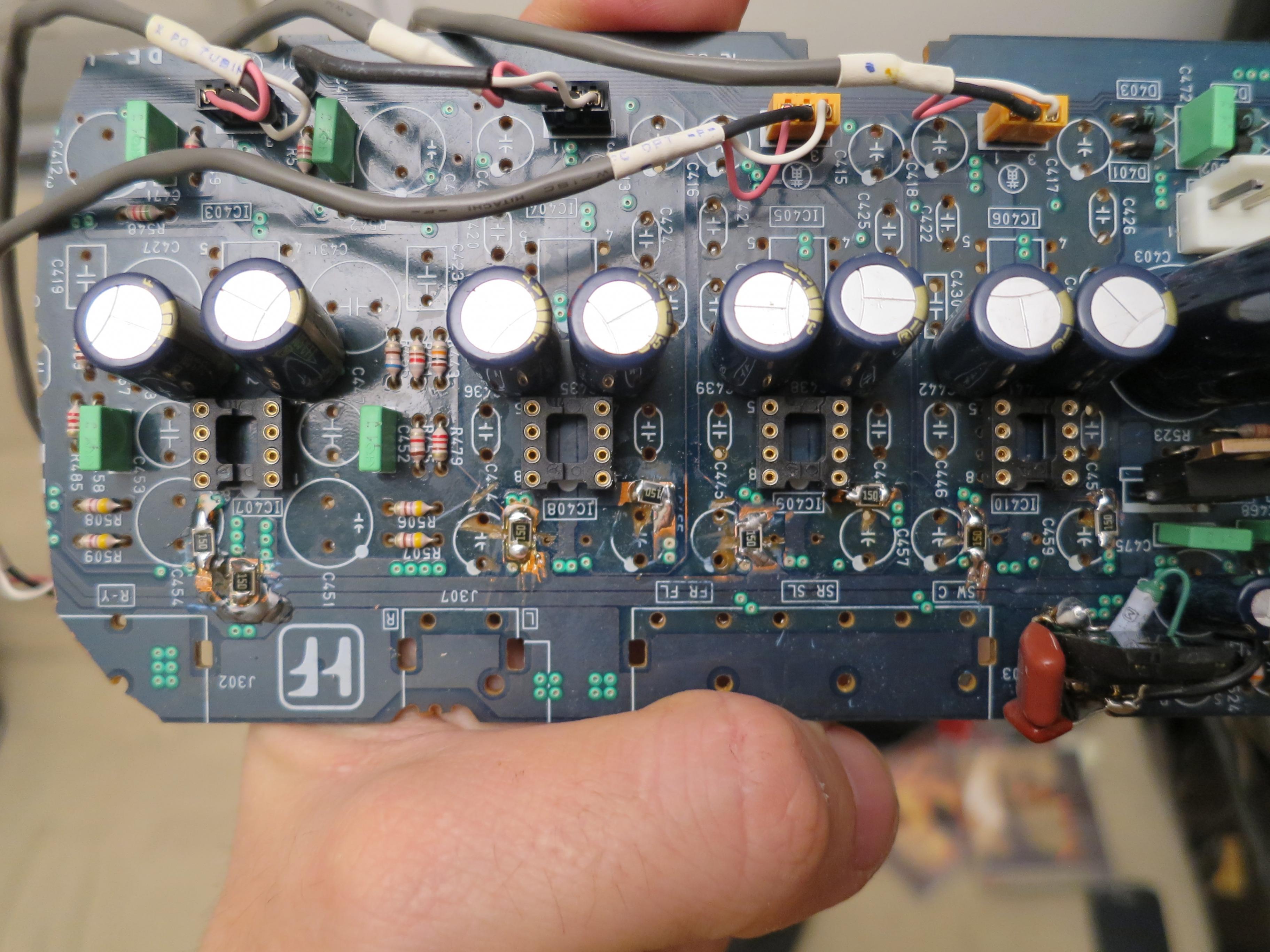

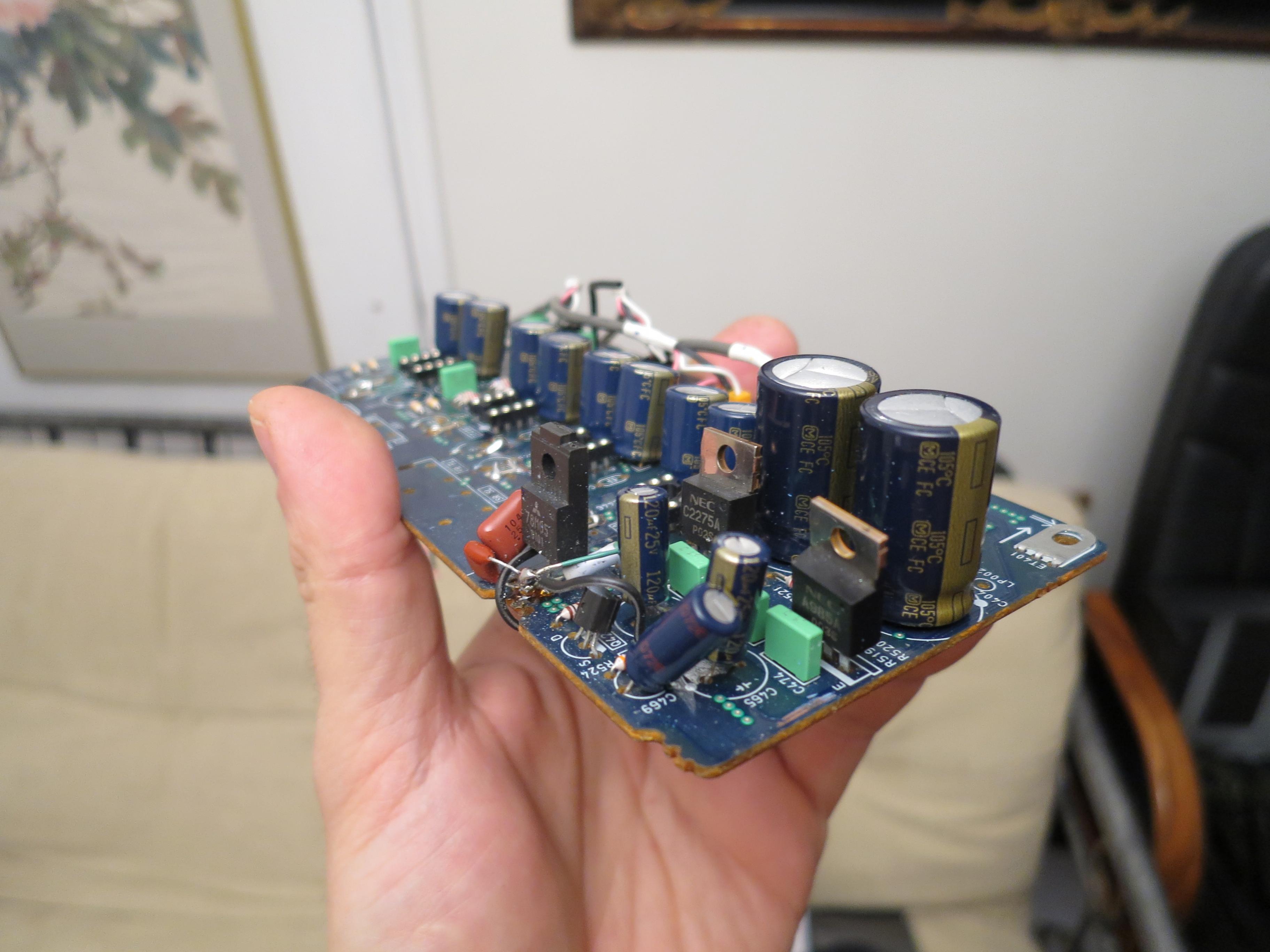

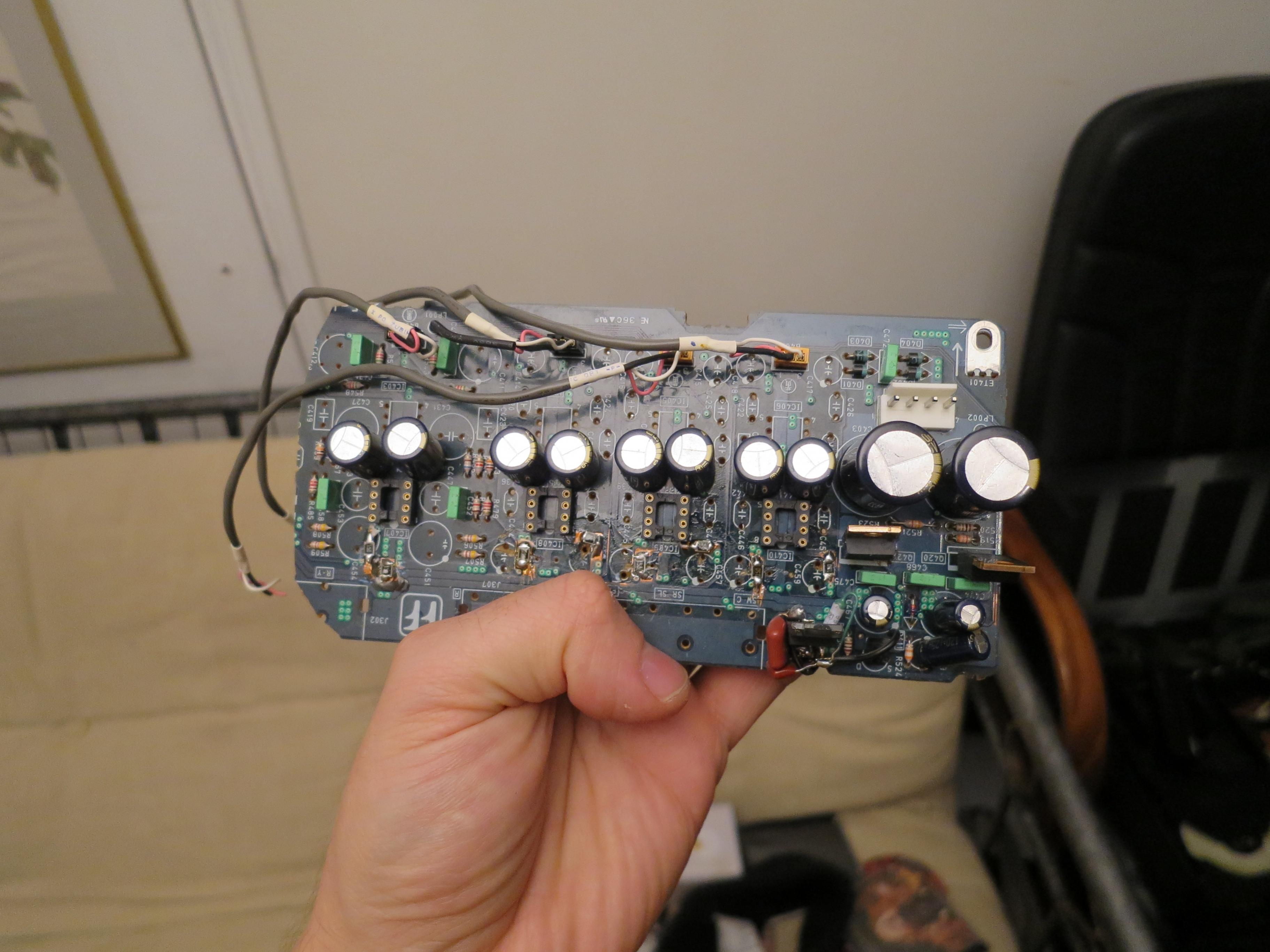

3.You can see the last board(stripped from a sony dvd player) i'm reworking on.I usually use 470uf...4700uf Panasonic fc-20...47ohm-100...220uF as a pi filter but this time i have 2700uF, a regulator (there's an op amp on the back) and another 120uF-15ohm-470uF filter Panasonic FC and that is just because I've read your article and you have convinced me....No, I'm kidding , actually i just need my op-amps to run with 2x gain instead of 20x gain as Denon dcd1560 is using the njm4556.Even more , they actually lower the signal before the njm4556 with a resistor divider , to be able to use the njm4556 at higher gain! What a coincidence ! They actually know how to get the datasheet PSRR, while others just wonder how come that you don't get the datasheet PSRR at unity gain...The 7805 is there just for the on voltage for the regulator...the regulator is described in the sony dvp 725 service manual .

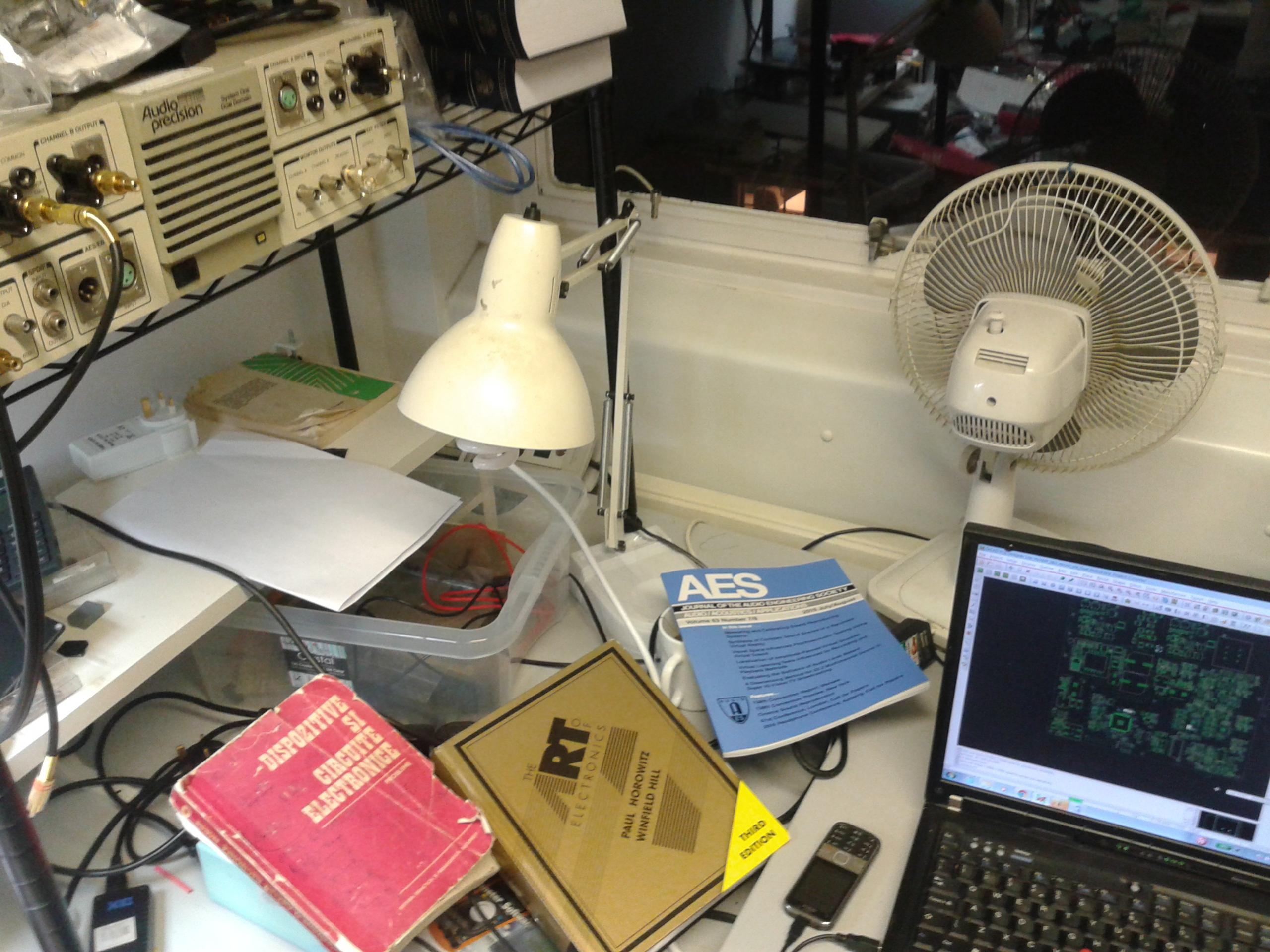

Well Raul, do the last photos tell anything to you?Well i needed to measure 5 ess32 bit Sabres kits on those AP's , plus a handful of the most modern op-amps, plus an electrostatic headphones amplifier .It was the only chance i had in my life to work on AP analyzers , but at least i've seen them in action .

[...]I didn't build the input stage with opa2068 as i used the lm4562 variable output of my Denon player . I just hope you won't tell me that the njm2068 is better than lm4562 now or that the njm4556 would prefer a lower im pedance signal source when used in unity gain noninverted...I won't buy such things. I think that I've seen the original review of the creator 3 years ago for the first time.[...]
Well, LM4562 is much better opamp but it is known for not being stable in O2. Thats why it's probably sounded not soo good.

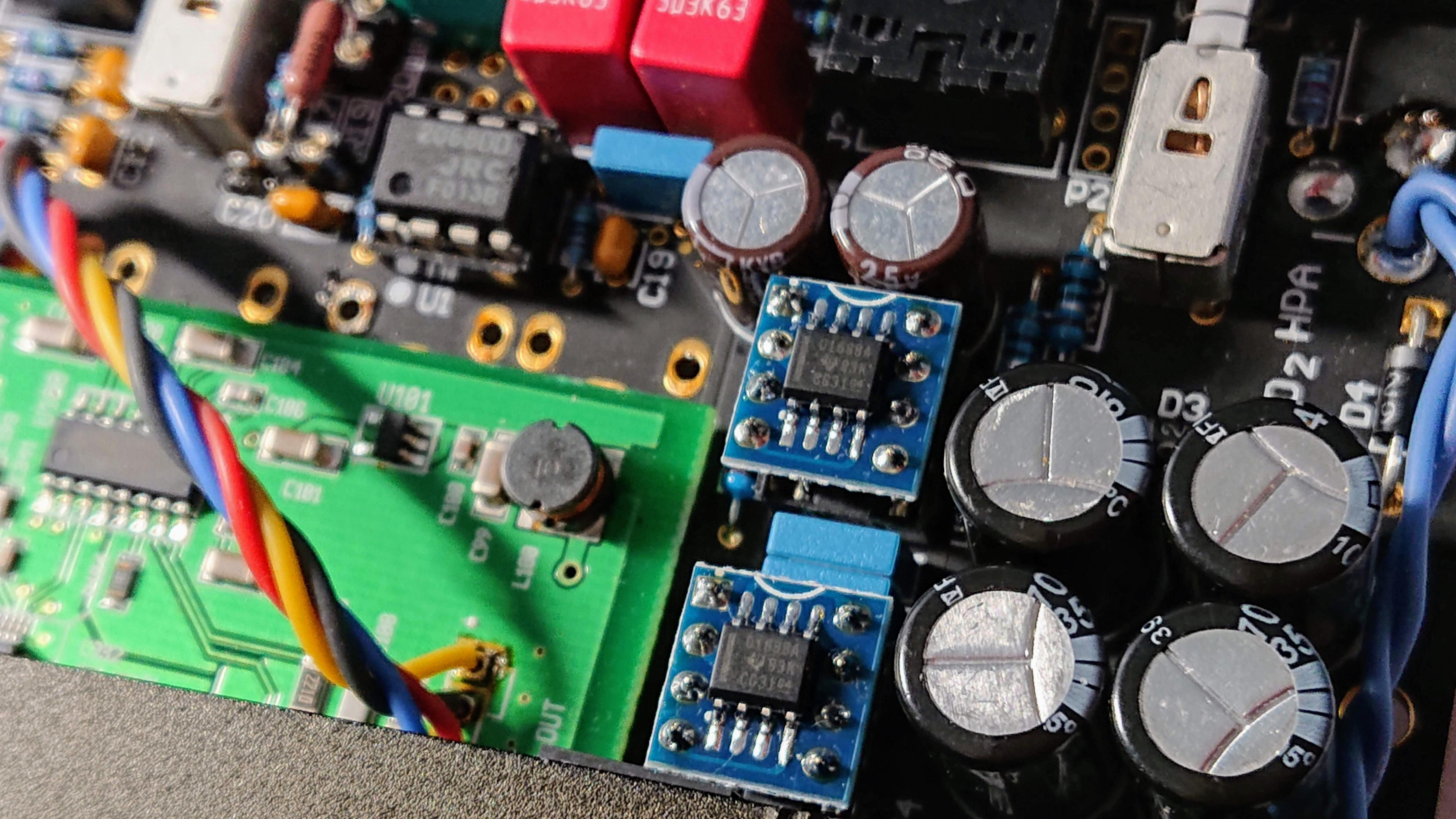

replaced 4556 with OPA1688
Hi!
Just got hold of OPA1688s on adapters, and installed them in place of the 4556s.
I am using Beyers 250 ohms DT770 pro, and I was thinking I might want to swap the output resistors to higher value ones, as a precaution to isolate the capacitive load from the cord, or so... Something between 47 and 150 ohm. But so far so good with the 1 ohm resistors, the opamps measured around 36-38°C at idle and while playing music. Would that indicate that they are pretty happy and not oscillating? 🙂
