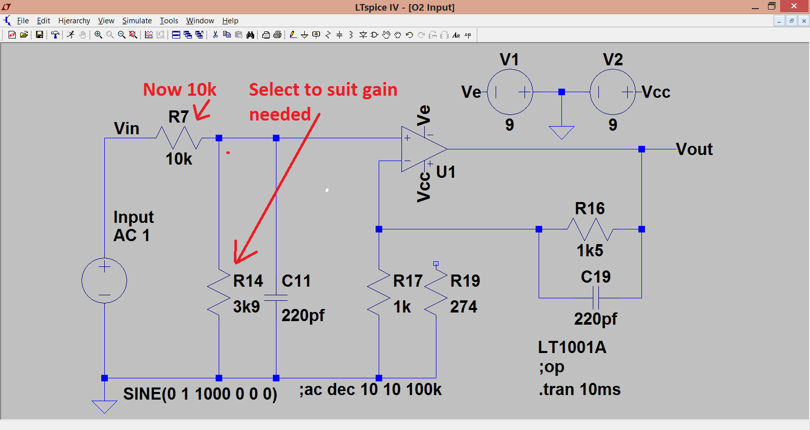

I might post a bit more on the subject of gain on the 02. There are different ways to reduce the gain, and some may give a much better result than others. Many opamps, although 'unity gain stable', offer better subjective performance when not used in this way. That is why I suggested increasing the input resistor as another possible solution.
Please do, that would be very interesting!I might post a bit more on the subject of gain on the 02. There are different ways to reduce the gain, and some may give a much better result than others. Many opamps, although 'unity gain stable', offer better subjective performance when not used in this way. That is why I suggested increasing the input resistor as another possible solution.

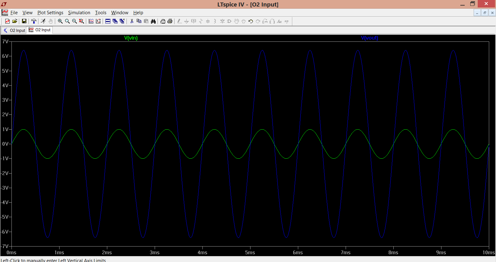

The 02 Input Circuit and Gain Settings.
This shows the O2 input circuit and the two switchable gain setting resistors.
Input Circuit

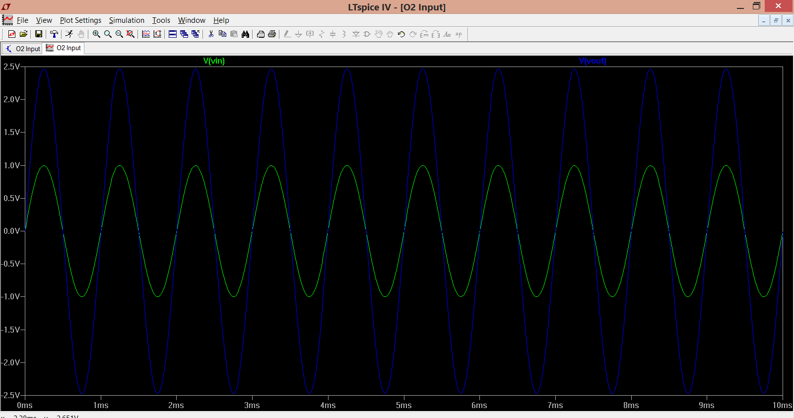

With an applied voltage of 1 volt peak we can see that the output agrees with the calculated 2.5 or 6.5 gain. Note the input voltage and the output voltage marks at the top of the trace and the corresponding scale at the left.
Low gain setting with the 1k in switched into circuit.
High gain setting with the 274 ohm switched into circuit

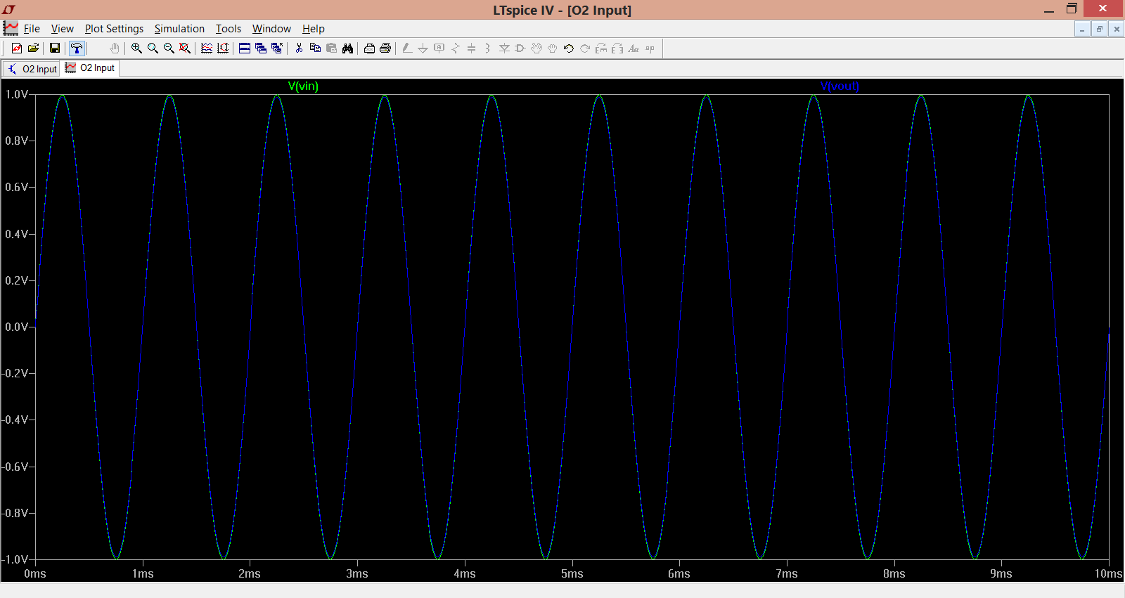

The simplest unity gain configuration is this which simply removes the lower feedback resistor from the network leaving R16 and C19 in circuit.
Simple Unity Gain Configuration
And the corresponding input and output levels.

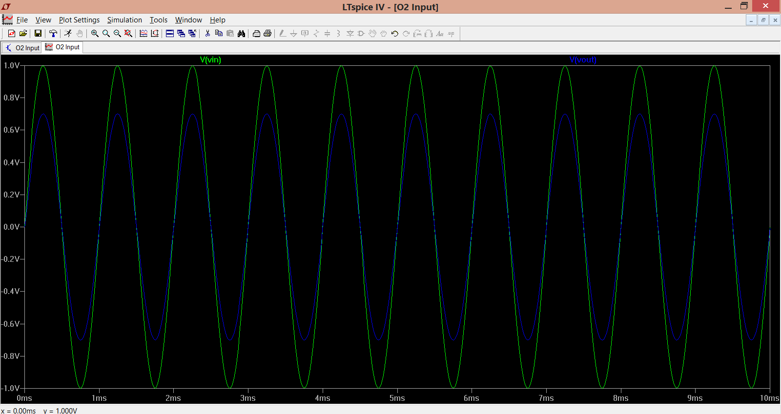

For best performance and sonics this could be a preferred configuration. We retain the feedback network and alter the input resistors.
Possible preferred configuration
This shows the output voltage now lower than the input (less than unity gain). Although this breaks the rule of 'attenuate and then amplify', the advantages overcome the downsides. The noise penalty for this approach is absolutely minimal and it keeps the opamp working at a reasonable closed loop gain. In my opinion that is best for sonics.

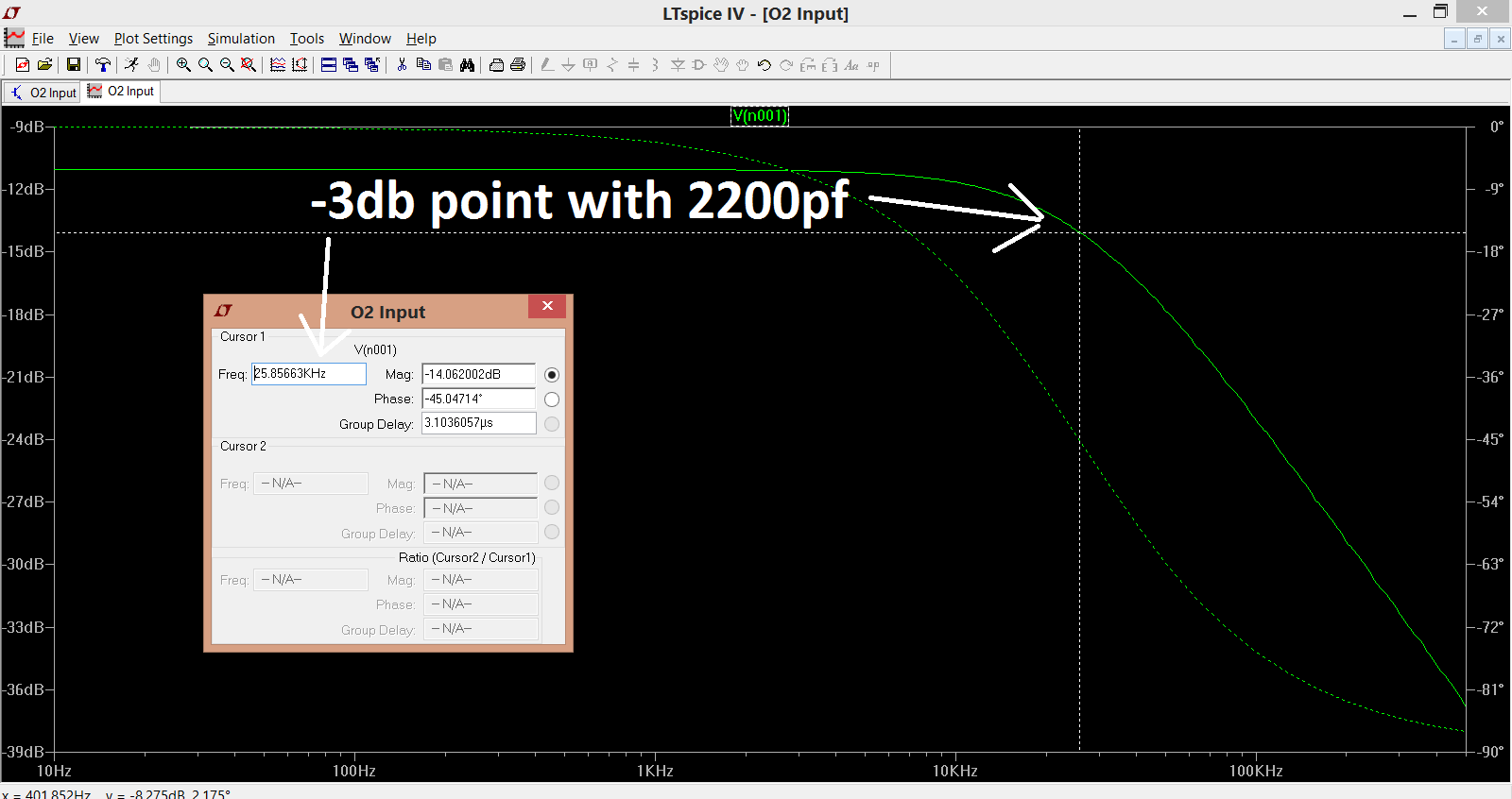

Agdr suggests changing C11/12 as well.
Yes, the problem is opamp specific. Making the input resistor higher than the minimum load the source can drive would alleviate the issue. As would a different opamp... but which ones would be immune to this I wouldn't like to say. Perhaps some FET devices.
C11 and C12 form a 1st order filter and stop HF hash and RF entering the amp. 10k and 220pf is still within the bounds of 'acceptable' but you could reduce C11/12 if you wish. I'll post some plots of their effect later.

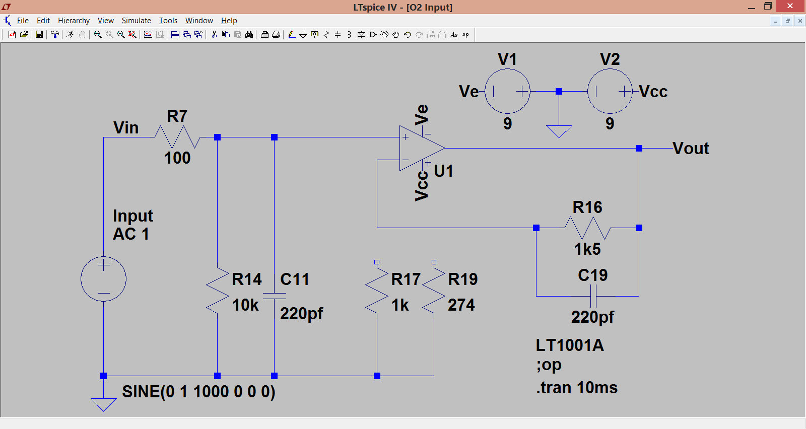

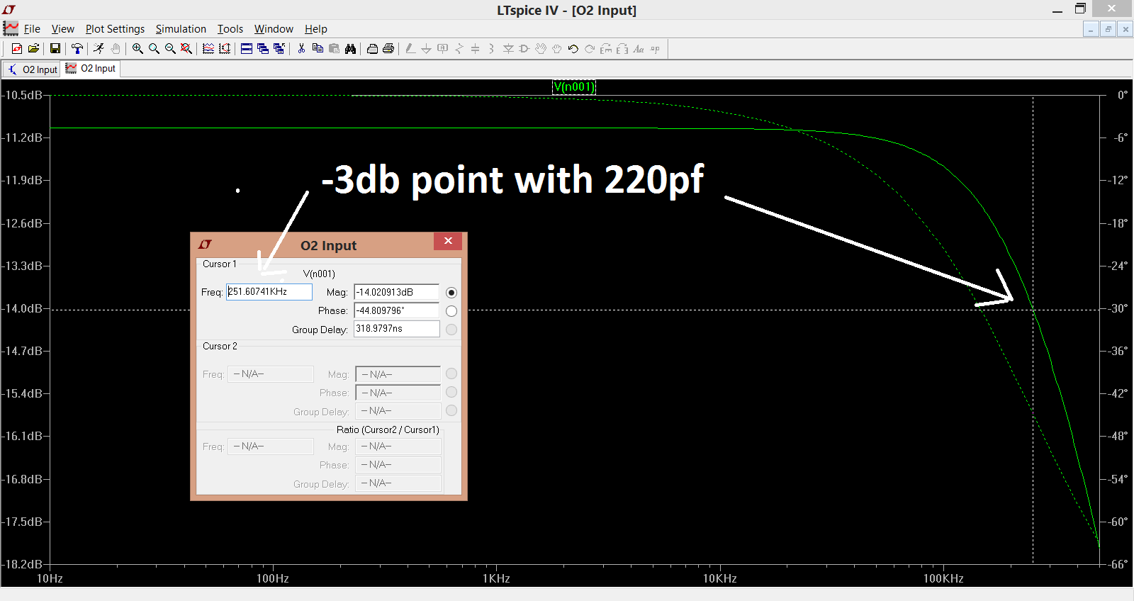

These show the effect of just the input filter on bandwidth with a 10k for R7. You can see that increasing the cap to even as high as 2200pf still has the -3db point above the audio band. So 10k and 220pf is fine.
