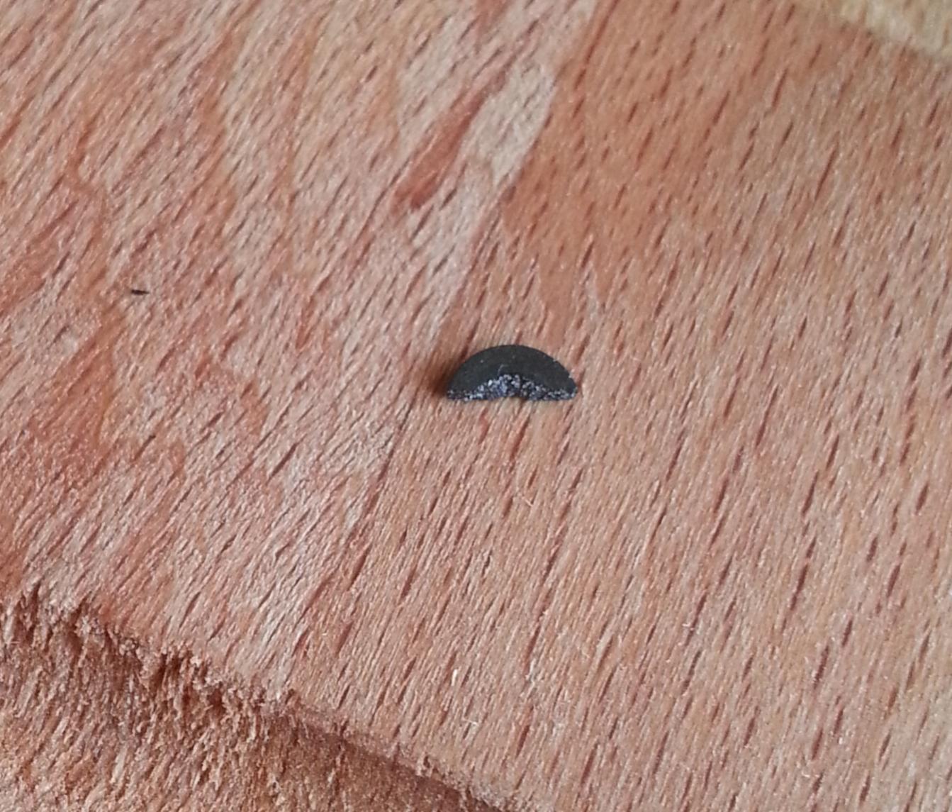

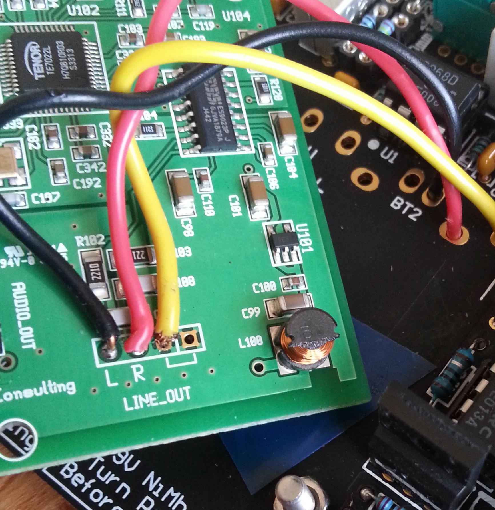

Hello,
I just assembled my O2 + ODAC and when i was about to install everything into the case my thumb touched the "coil" on the ODAC and the top of the coil broke in two. Everything still works but I'm wondering if there might be some consequences?
See attached pictures.
