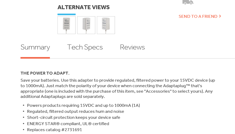

I am taking voltage readings from my Objective 2 kit. On D4 I am only seeing -15.2v on the banded side, -14.6v on the non-banded side. Then on D3 I am seeing only -.3v on the banded side and -15.2v on the non-banded side. After following the troubleshooting guide I thought this sounded like a serious offense. But everything seems fine all components are in the right place and soldered well. Also I should note I am not sure about the power supply I am using. I bought a 15V 1000ma wall ac adapter from radioshack. I originally had the polarity backwards is that going to cause problems? I'm hoping not everything is fried. Any clues as to where I should start are appreciated. Thanks.

Are you certain it is a 15V 1000mA ac adapter?
If it is ac, you couldn't have had the polarity backwards.
Yes, those readings suggest your adapter is DC and not AC (it must be AC for the O2).

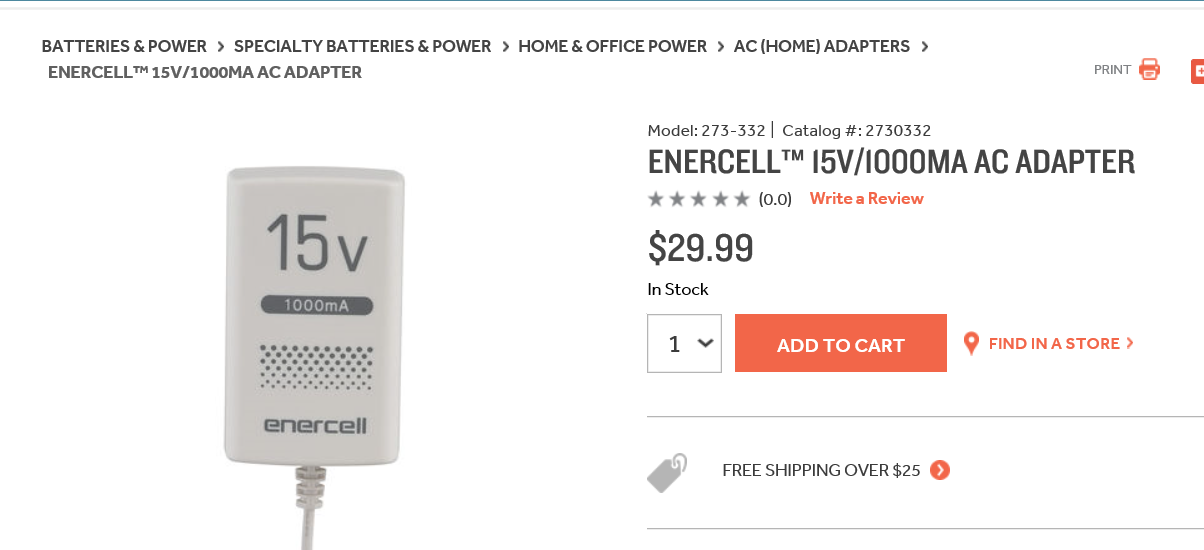

It is the model I have linked. It has a reversible tip for polarity.
Enercell 15V/1000mA AC Adapter : AC Adapters | RadioShack.com
The link doesn't work, but a reversible tip indicates DC output for sure. They're calling it an AC adapter because it's mains AC input.
Is it model 273-332? That one clearly states
As mentioned, you need an AC/AC supply, i.e. nothing more than a dumb transformer inside. NwAvGuy's recommendations for 120V territory included Triad WAU12-200 (minimum), WAU16-400 and Xicon 412-218054.

Use this adapter to provide regulated, filtered power to your 15VDC device (up to 1000mA).
Yes, you should be able to get a refund from Radio Shack. That adapter won't work without some 'just not worth the trouble' modifications. And it doesn't appear that they carry an AC-AC wall wart you can use.It is the model I have linked. It has a reversible tip for polarity.
