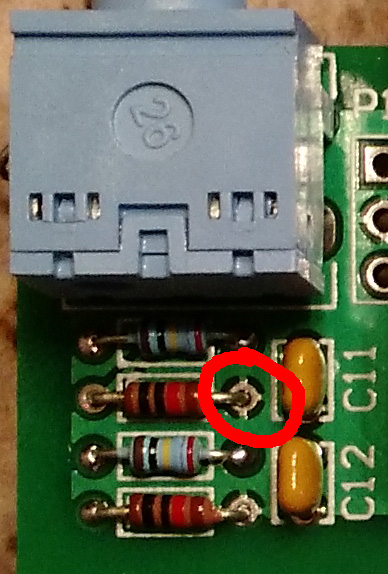

I took a few snapshots of my o2 and noticed that some of the solder didn't flow to the other side. I'm guessing I should add solder to the top side? There is a few that need it, here is an example of one circled in red.
I'd solder them for correctness but if the holes/vias are plated through then it should make a difference.
