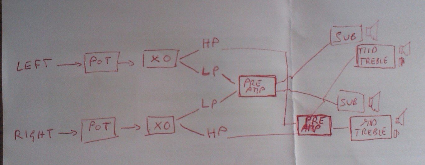

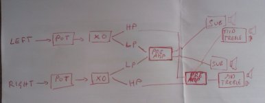

I'm considering a bi-amp with 2 My-ref and reading many threads here in DIY and elsewhere, may I ask you just if this plot is right ? I need some gain to match speakers:

that does not look right.
Left >> vol pot >> HP filter >> power amp >> mid/treble
Right >> vol pot >> HP filter >> power amp >> mid/treble
That's your stereo channels.
For the bass only single channel ( the .1 of a 2.1)
Left >> input 1 of summing circuit
Right >> input 2 of summing circuit
output of summing circuit >> LP filter >> bass only Power Amp >> bass only speaker.
The summing circuit ADDS the two input signals to give double the VOLTAGE as an output.
You then filter that to remove mid and treble and you end up with double the voltage to feed into the bass only amplifier.
You should not need any extra gain. You are more likely to need some attenuation. For this attenuation I'll show a modified version of the above:
output of summing circuit >> LP filter >> lin law pot >> Buffer >> bass only Power Amp >> bass only speaker.

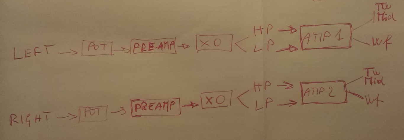

Bi-amp means two amplifiers.
Why is your diagram showing one amplifier in each channel?
In my diagram, AMP 1 and AMP 2 are two stereo amplifiers, one for each channel (left and right) to avoid ground loop as Mark said.

amp1 = two amplifiers.
OK.
I consider it better to use one stereo amplifier to drive one 2way speaker with very short speaker cables and a longer pair of interconnects coming from a conveniently located volume controller.
The alternative of having a centrally located stereo amplifier driving two similar drivers with long speaker cables is not as good in my opinion.
Look at your diagram.
The two Sources left and right will have a common signal return at their outputs.
Now look at the routes leading to the final power amplifiers. There are a return/grounds all the way through. If these get commoned again anywhere along those routes you will have a ground loop.

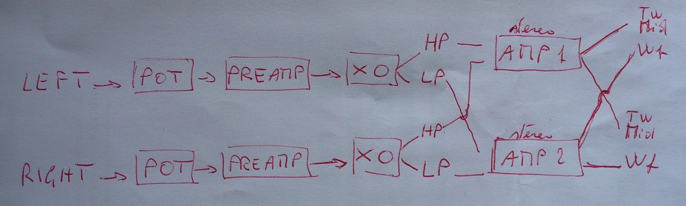

I consider this one as a "vertical" bi-amp and if am not wrong, there is no ground loop here:

The MyRef was designed with 1 Ohm resistors between the input grounds (AGND) and the power ground (GND).
Here they are shown as R9 and R50.
http://www.diyaudio.com/forums/chip-amps/54571-my-audiophile-lm3886-approach.html#post609507
Ok Mark, this resistor seems to be (if I am not wrong) in the right place to break the ground loop so ... maybe not too much noise problem with My-ref design.
