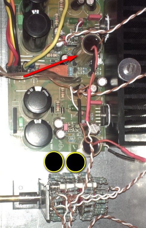

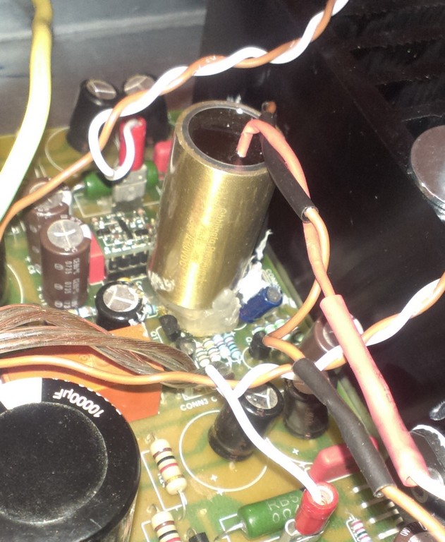

Hello !
I'm trying to end my My-ref C but I have a problem with Obbligato cap, they're to big. So I've placed one of them on a wood socket + glue, but it becames to hot. After 2 hours playing there is quite a heat difference between the two capacitors :( One is warm, the other is to hot.
One way would be trying to use something different from wood+thermic glue, maybe a glass tube would better dissipate heat.
The second way is to place both caps between pot and PCB, in a little separate PCB. But I don't know if it a good idea :confused:
Or what else ???
thank you for your help !
marco

A signal capacitor should never become hot, not even warm.
The power dissipation in a signal capacitor is below micro watts (<µW)
... of course you are right :)
So maybe it depends from the heat coming from other components and radiator ?
The cap in the right, the colder one, is more distant from others components, maybe this is the cause of different heating. I don't know...
The amp works well.
Ok, no issue with cap heat, it works ;)
