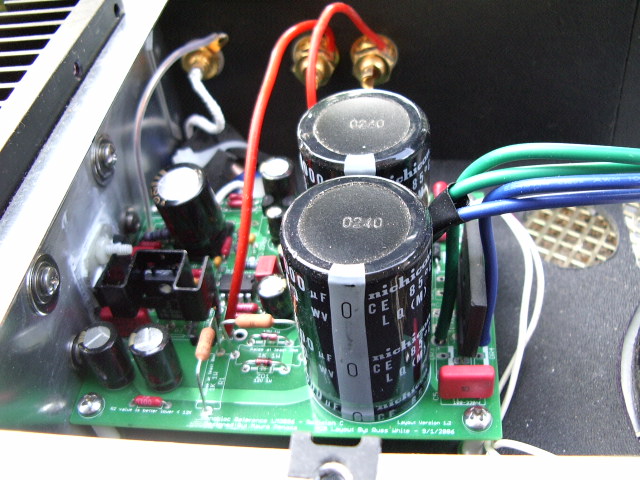

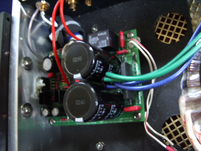

Many builders of the "Ultimate BOM," including me, used large input caps off the board. As much as I can remember, no one took extraordinary precautions about twisting the pair of leads, and all the amps ran quietly. This is too much excitement about what is most likely an unimportant issue. It's best to put at least one lead of the cap directly into its pad on the PCB, with the other end soldered to the input lead (or even the RCA jack itself, if it will reach), and keep the cap as close as possible to the board. Two inches may be too far away. The negative pole input lead can go directly to its proper place on the pcb. Chances are very good there will not be significant interference or noise. If there is, then you will need to refine your wiring. Until then, don't worry about it.
In fact, I would say it's more important to secure the input cap against a solid surface to reduce vibration as much as possible than it is to obsess over an inch or two of untwisted lead wire.
Here are bad pics of very good amps that ran perfectly silent with off-board caps and untwisted input leads.
