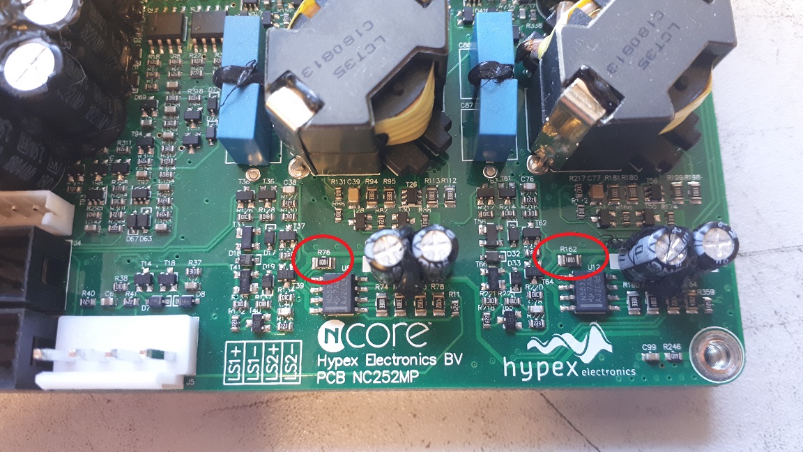

Dear all,
Hypex is ok with sharing the data, so hereby. First the disclaimer: you are on your own if you destroy your PCB by modding, so your warrenty will be gone.
You can change the resistors with circles on the attached image on the NC252MP board. The resistor (Rg) is part of the differential input buffer stage. For the Fusion 253, the resistor values are:
Rf = 3k3, Rg = 1.8k (Rg = R76 and R162)
See manual posted above how to calculate the gain. If you want to lower the gain, you need to raise Rg.
On the NC100HF tweeter board, you need to look for R76. The resistor values are the same there...
Have fun! :D
Fedde
