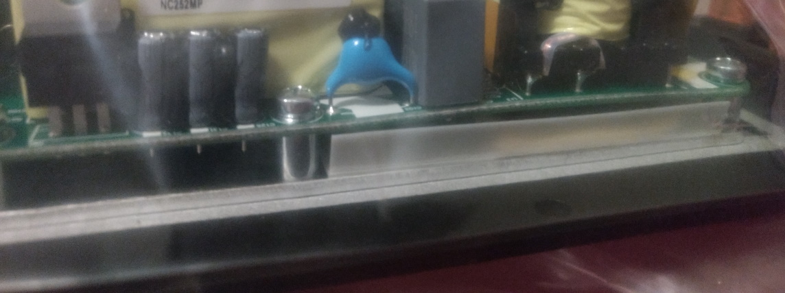

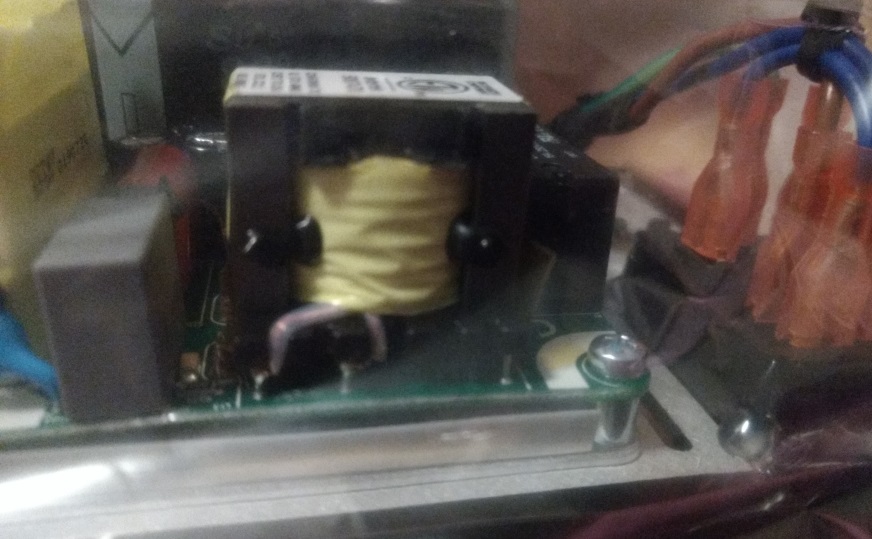

The good news: my Fusion plate amps arrived. The bad news: the PCBs are curved around the transformer. 🙁
Does anyone has this issue as well? Should I be concerned about it and return them?

According to Hypex, the bend in the PCB is expected. All Fusion amps have this. Indeed the root cause is FETs that pushing the PCB up due to an isolation layer. So far they have not experienced issues with this...
Still not so happy about this though... I think it is a design issue...
Fedde
Would you be happy if the PCB was flat? I am happy because it works great, even if it's not straight.
Are you sure it's an isolation layer and not a thermal conductor layer? If it's the latter, then a slight bend is even preferable than a flat but weak contact.
