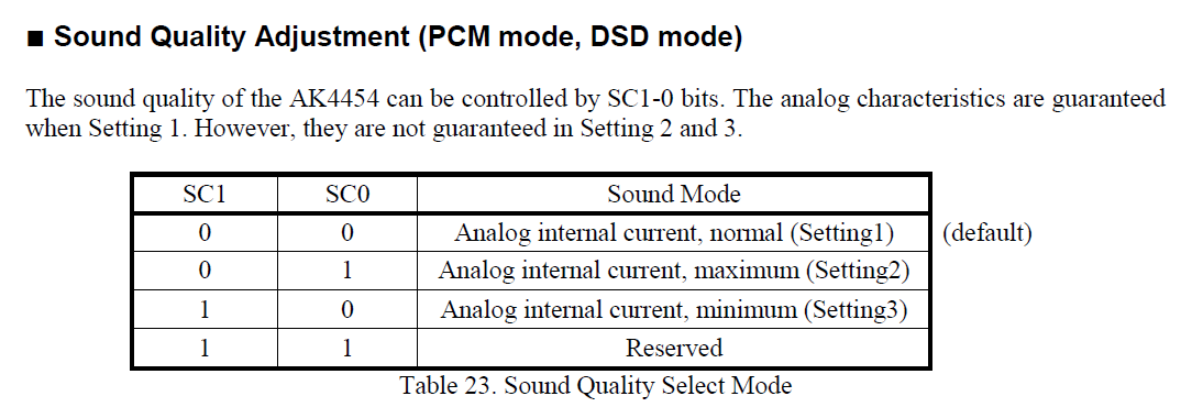

You now have access to the DAC settings and I wonder what the „sound quality“ tab and it‘s numbers 1 to 3 are there for...
Don't know what it does exactly, but the amp's noise floor increased significantly with settings other than 1.
I found this in the DAC chip's datasheet:

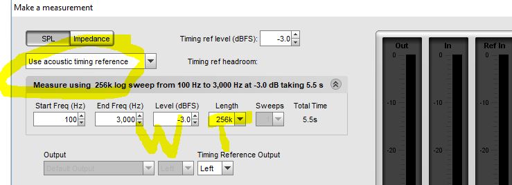

First, we need to find particular driver delays. I place a mic in my listening position and measure every driver with a tweeter as an acoustic timing reference:
attachment.php
This gives me how many milliseconds are woofers behind the tweeter or vice-versa. I setup delays for every driver.

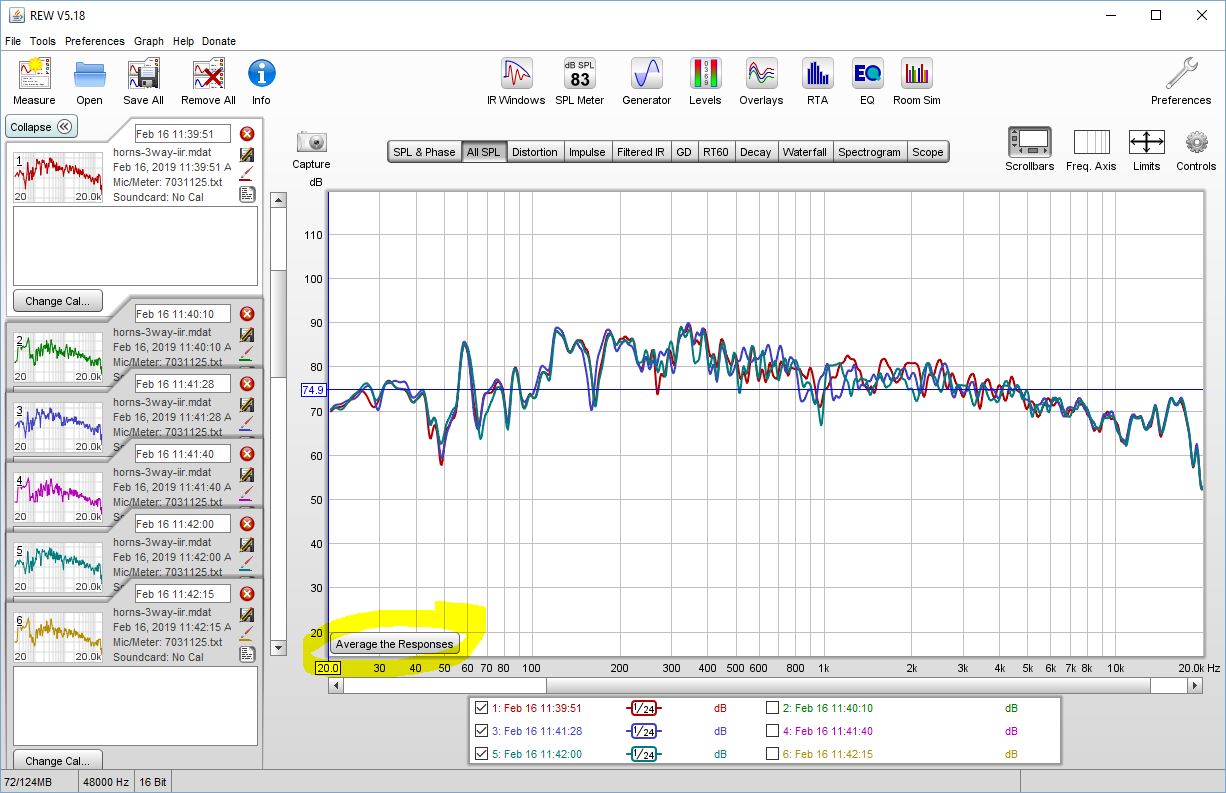

When crossovers are ready, perform swipes acrosso the listening position. I adhere to structure recommended at avsforums for configuring Odyssey. First measurement is in the best position at ear level. You measured delays from that position. I measure both speakers from that position.

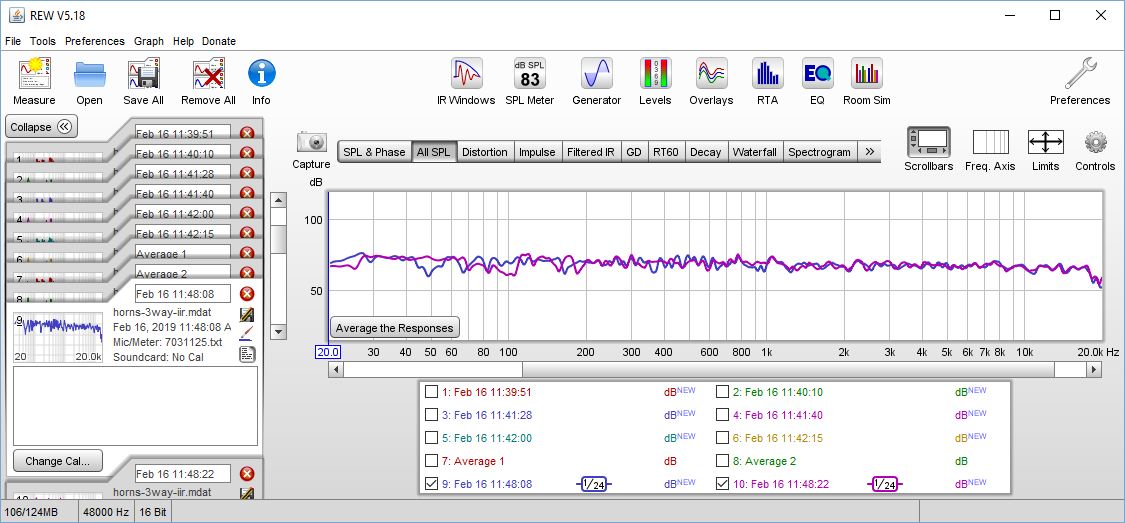

Then I move the mic about 10 cm closer to the speakers. Measure both. I lift the mic about 10 cm and measure again. Move the lifted mic back to the first position and measure from there. You will get 8 measurements in total.
Always measure left channel first, right second. Keeping this order you will be able to easily distingiush left and right measurements within these 8 measurements you will make. Left measurements will be odd, right measurements will be even.
Do not use gating when making measurements. Leave standard 500ms gate window. You're correcting for the in-room response, so you don't have to try to remove the room from the equation.
Select only left measurements and average them:
attachment.php
Do the same for the right measurements. You will get left and right measurements averaged by 4 positions.
* On the screenshot above I have enabled 1/24 smoothing. You may do as well. Please click Graph - Apply 1/24 smoothing.

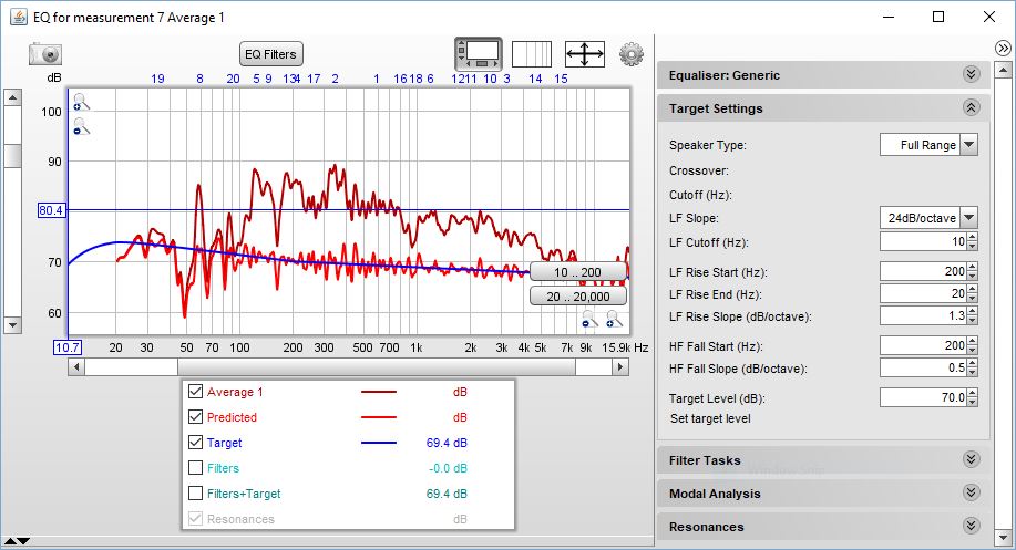

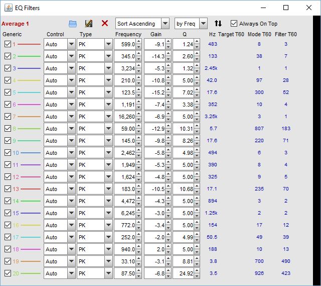

After I got two new frequency charts, I use the Eq feature to generate a set of filters for my equalizer. There you will need to set target level and how much high-frequencies will decrease.
attachment.php
Then I export these filters into my equalizer. I'm using Equalizer APO and it accepts text files right from the REW. You may need to copy filters manually into the Hypex software. You can get a list of filters by clicking on "EQ Filters" button.

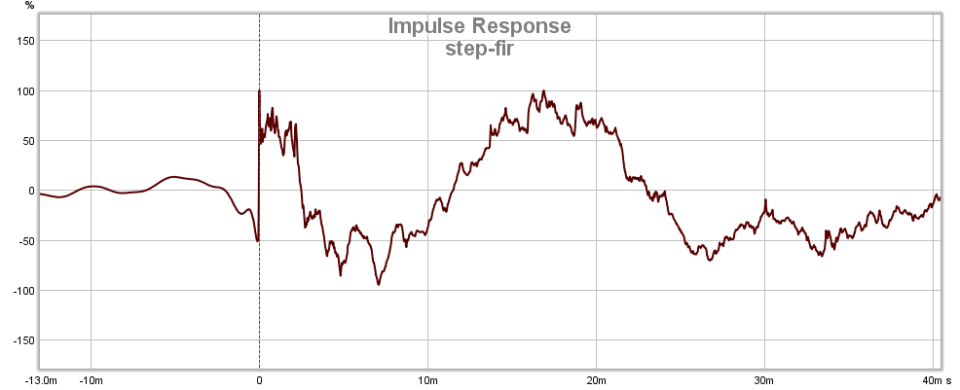

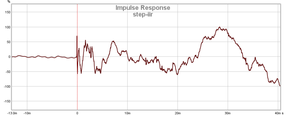

If you used linear-phase crossover, the step response should look like that:
attachment.php
with minimum phase filters, it will look like that:
attachment.php
Since FusionAmps use BiQuads for correction, you're likely to get a chart similar to the second one.

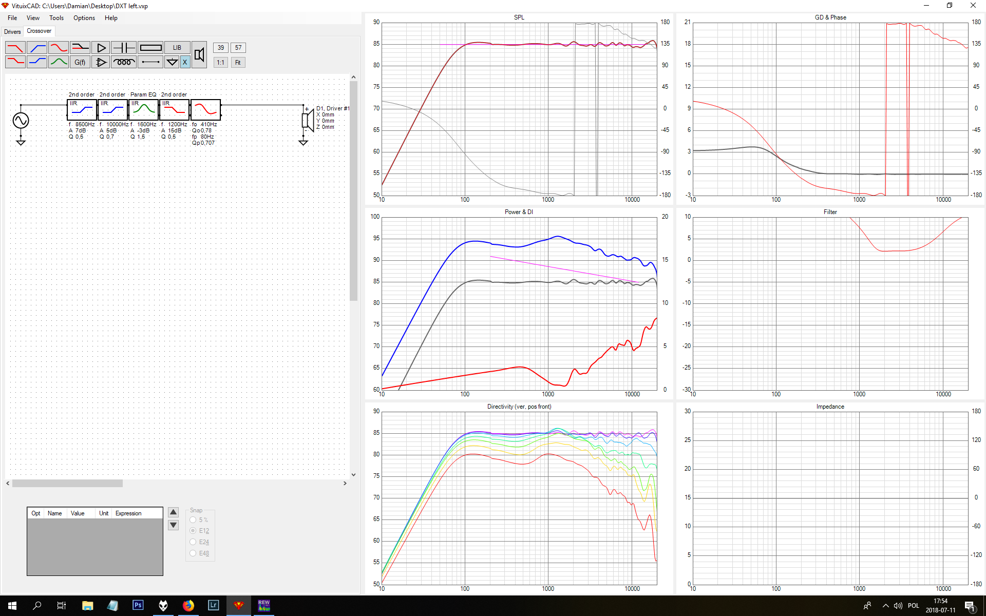

Thanks pos! I'm certain everything will be OK he is little man, but strong one! I did play a bit with rePhase but I must admit not to that level, so in fact I have not familiar with this method. If I understand it correctly, it looks very similar in its principles becouse it leads to acoustical slopes which must closely resemble its mathematical equivalents - this is basically all what is needed in end result.
I tend not to agree about excessive amount of filters usage. Importatnt thing is to learn using them efficiently. In 90% cases I operate on shelves / assymetrical shelves only. It is very effective way of targetting SPL nonlinearities. I've made W22EX001 ruler-flat till 10 kHz using just 6 filters. I managed break-up peak and its surrounding completely just using one HP and one LP shelf. If I remember correctly, I used only 4 filters for equalizing DXT tweeter from 250 Hz right to the top.
I also moved away from 'one proper' method a bit. 😉 Rather than stick to on-axis response only, I gather +/-60 degree horizontal measurements bundle and operate on simulated power-response inside of VituixCAD. Its directivity plots are a real weapon. I can precisely target directivity and diffraction issues and judge what to correct and to what extent. I use minimum amount of filters possible and aim for overall balance rather than going to the war with all those wrinkles. Simulations are very accourate becose corrected loudspeaker behaves nearly idetically in reality. Sonically, these filters are superior to on-axis measurement methodology from simple reasons.
I managed to find DXT tweeter data, actually it was 5 filters and it was uncertain below 1kHz becouse I was testing various things... 🙂
In attachment:
Simulation based on raw response measurements and... the measurements (watch 2dB grid):
