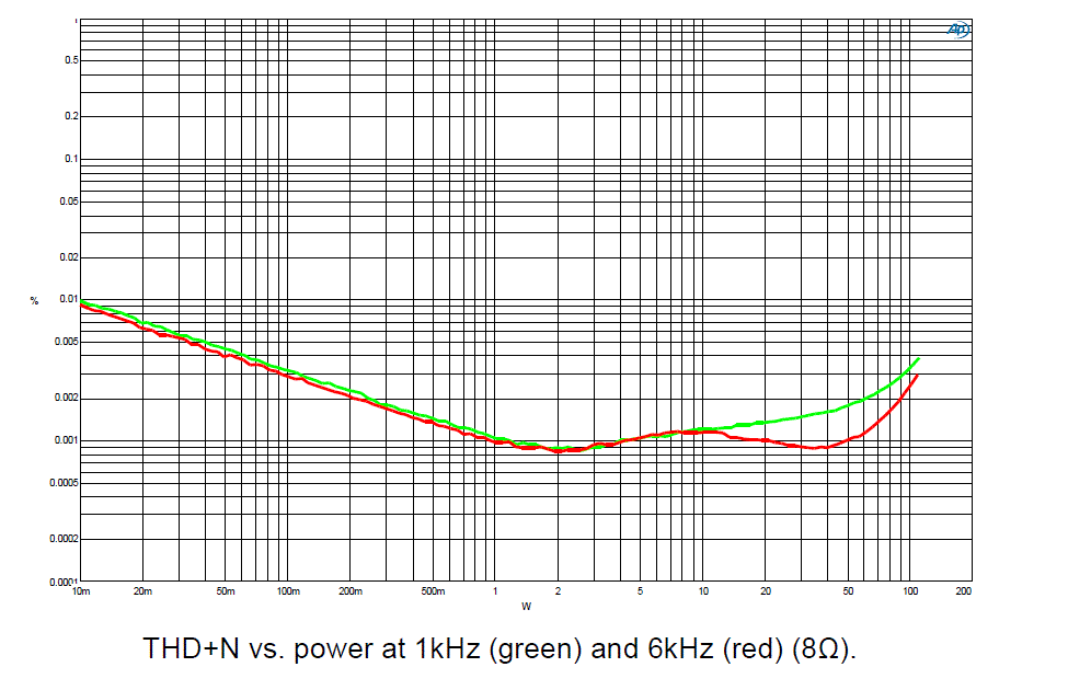

Power levels in high frequencies are low and much lower with high efficiency drivers. The problem is that amps tend to have higher distortion at low levels. Hypex does provide the data:
attachment.php
In a loudspeaker with a passive crossover padding down a high efficiency driver keeps the amp in "normal" operating range. If you do this padding in the dsp tends to operating levels with higher distortion levels!

An lpad will burn power, so that is only an option if you have power to spare
With high sensitive tweeters l-pad may reduce harmonic distortion. Most amps have lower distortion at 2W than at 0.3W. With an l-pad you will effectively make the amp produce more power and this reduce amp-related distortion.

They indeed show THD/N at 4 Ω and 8 Ω, but not THD as a function of load impedance. It is possible that THD ges up again at 16 Ω as the amplifier runs out of voltage swing.
Max power goes down, and distortion climbs when it is reached (be it voltage or current limited), but within this limit a higher load always result in lower distortion from an amp.
Look at headphone amps for example, which are often tested with loads ranging from 8 or 16 ohms to 300 or even 600 ohms. Distortion always goes down with impedance.
That is my point - with a higher impedance load you hit the voltage limit sooner, so you won't stay within that limit.
Well of course, you loose 3dB each time you double the impedance once current is not the limiting factor.
