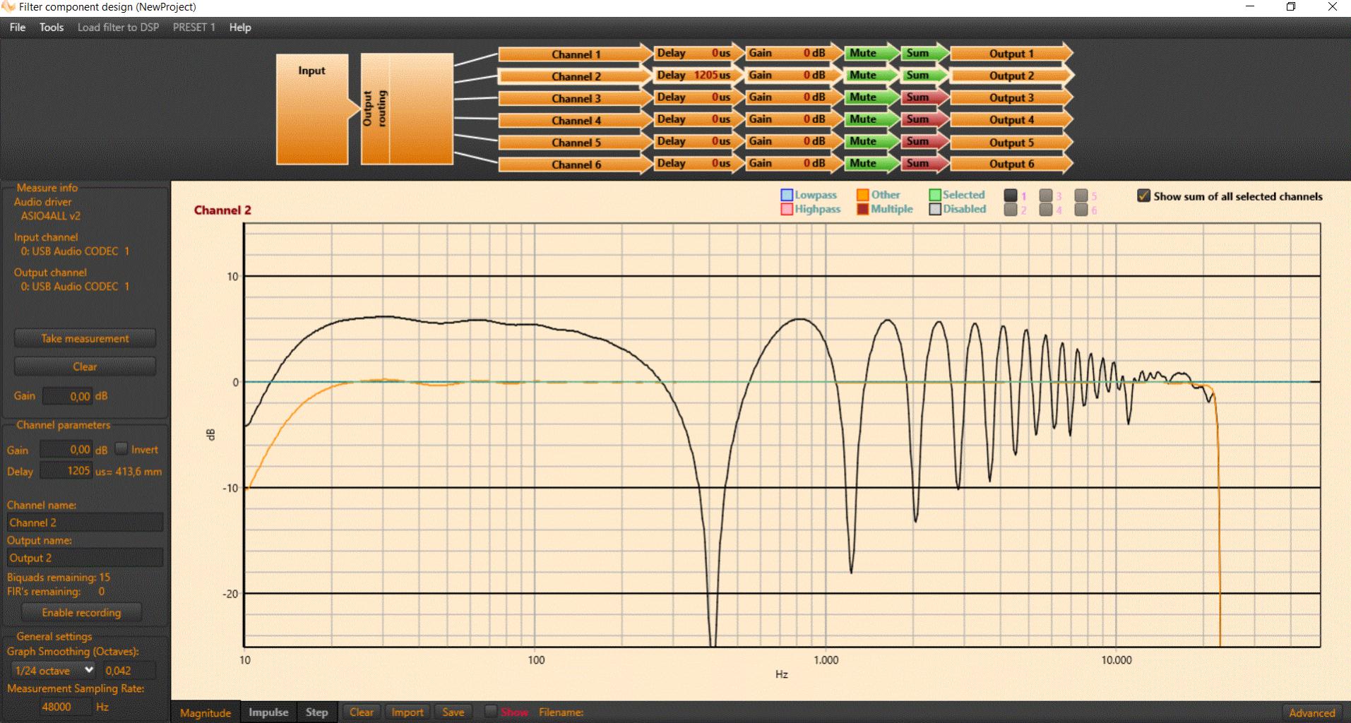

To be frank, you can't ignore this. A simulation of two drivers delayed with 1.2 ms:
The main dip is at 400Hz but starts already below 100Hz.
I don't see any issues up to the frequency the LX521 woofer is supposed to work (120 Hz LR4).
Woofer output will about zero at 400 Hz.
Your model is a typical example of a (freefield?) simulation; real behavior will be different and largely room dependent.

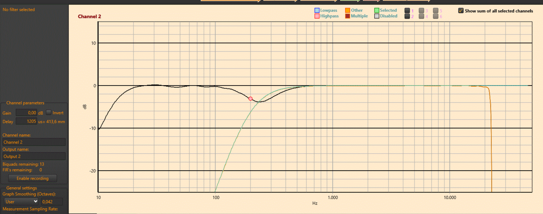

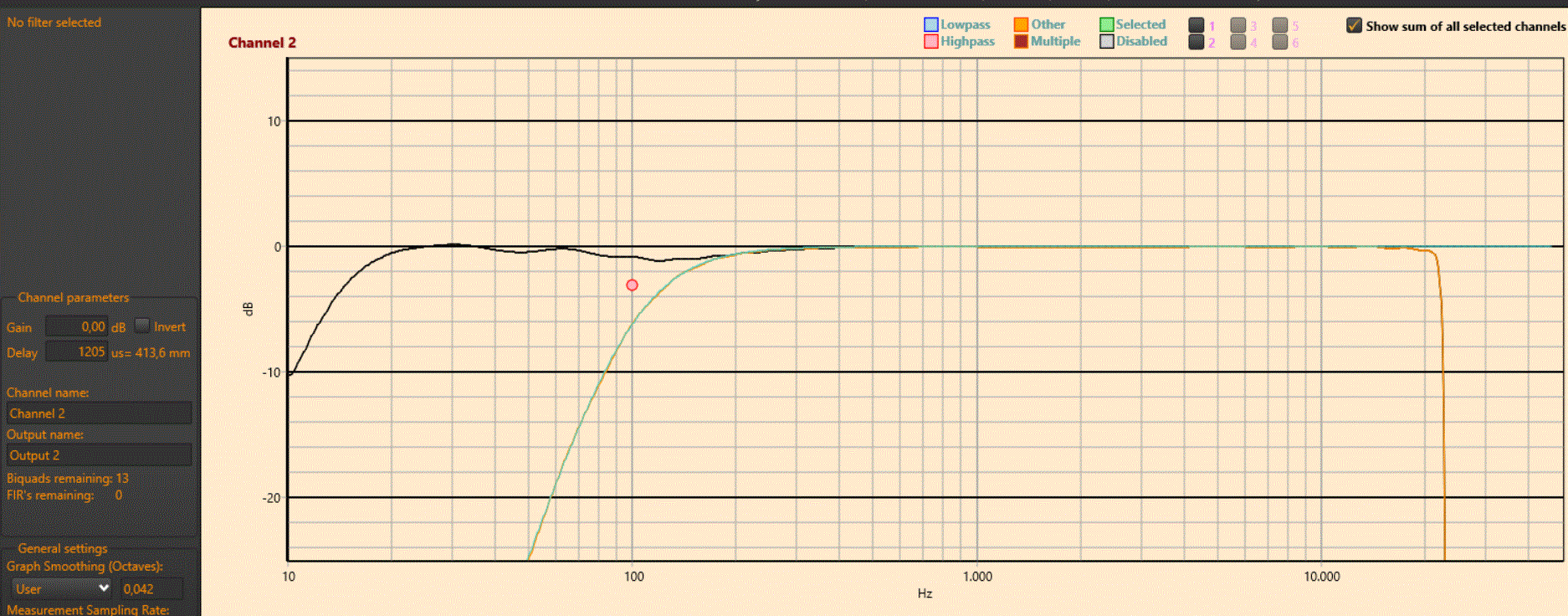

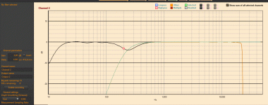

An example: Two ideal flat drivers crossed at 100 and 200Hz LR4 with the upper driver delayed 1.2 mS
Again: freefield "ideal" model?
I suggest to read about the audibility of group delay in loudspeakers.
This is a start with good references:
Discussion of Group Delay in Loudspeakers
Your presumptions are based on modelling which is so easy with today's software and DSP; however, to create good loudspeakers these are mere tools.
To get the best results they are not sufficient.

My simulation examples have nothing to do with group delay. Driver offsets can cause a dip at the xover point. In a setup with only a dsp at the upper channels this will result in a woofer moved forward. With a 1.2mS latency in the dsp this is 41 cm + the front to voice coil offset. At very low x-over points it's not a big issue but in the given example it will be starting at 200Hz and is worst at 400Hz.
It is just plain, simple physics:
A LR xover will sum flat if the drivers have a flat responce up and below the xover point AND do not have an offset in time.
