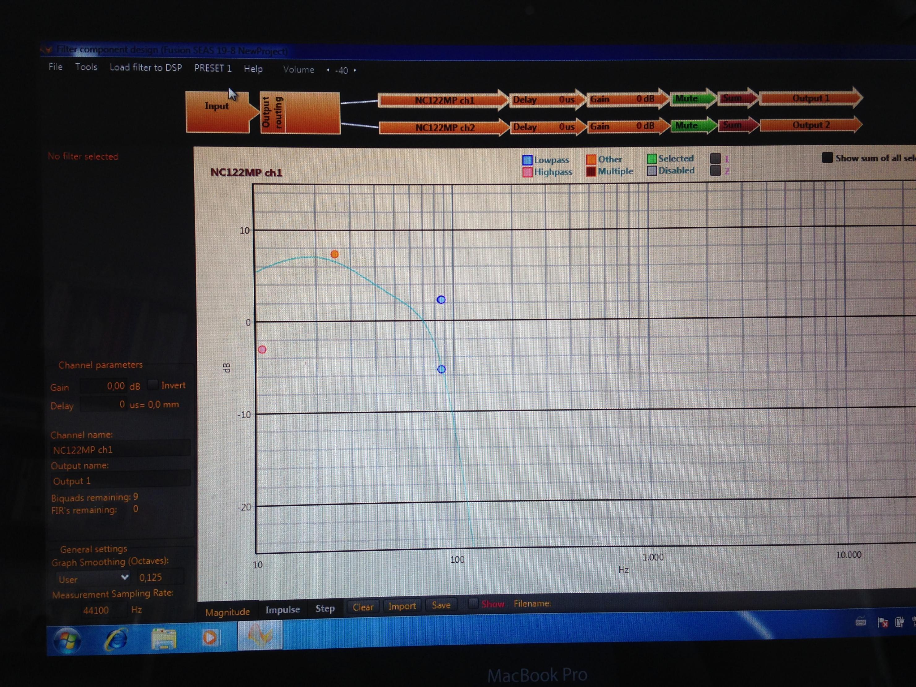

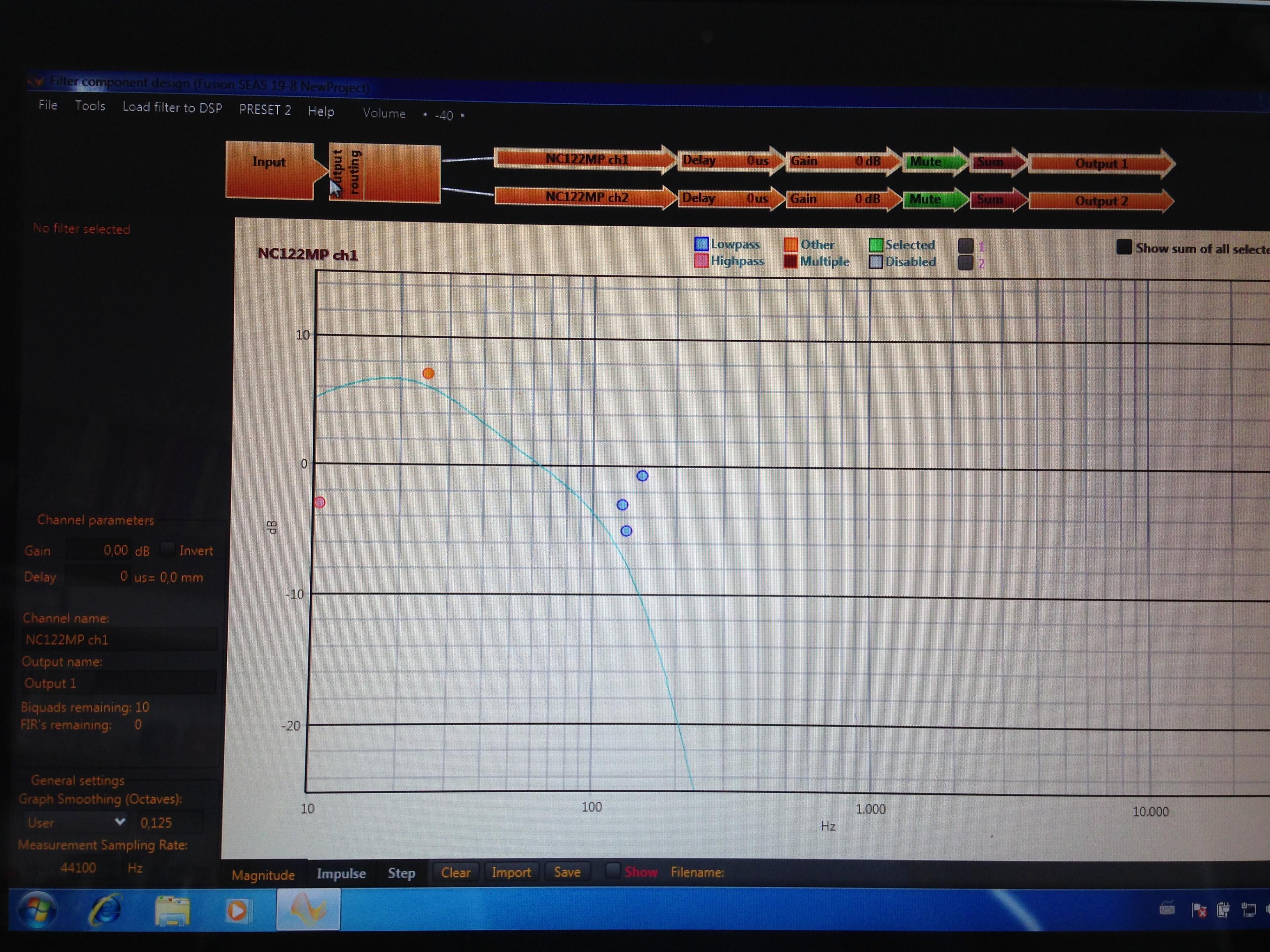

Made two presets for my subwoofer project.
Some remarks:
- A filter made without a unit is always 3 ch; this will not load when the FA122 is connected. So you have to start your project with the actual unit in place.
- Sometimes my newest project could not be found again, even after it was loaded into the FA122 with success and tested for compliance. (A new file entry was found in file browsing, but did not show up in the project selection. Remade the filter, loaded this new version to the FA122 and saved it. Now it could be reopened.) The saving might be improved with better safeguards against fools like me. Is the sequence important?
- With a Linkwitz-Riley 48 low pass
- with a Bessel fifth order
