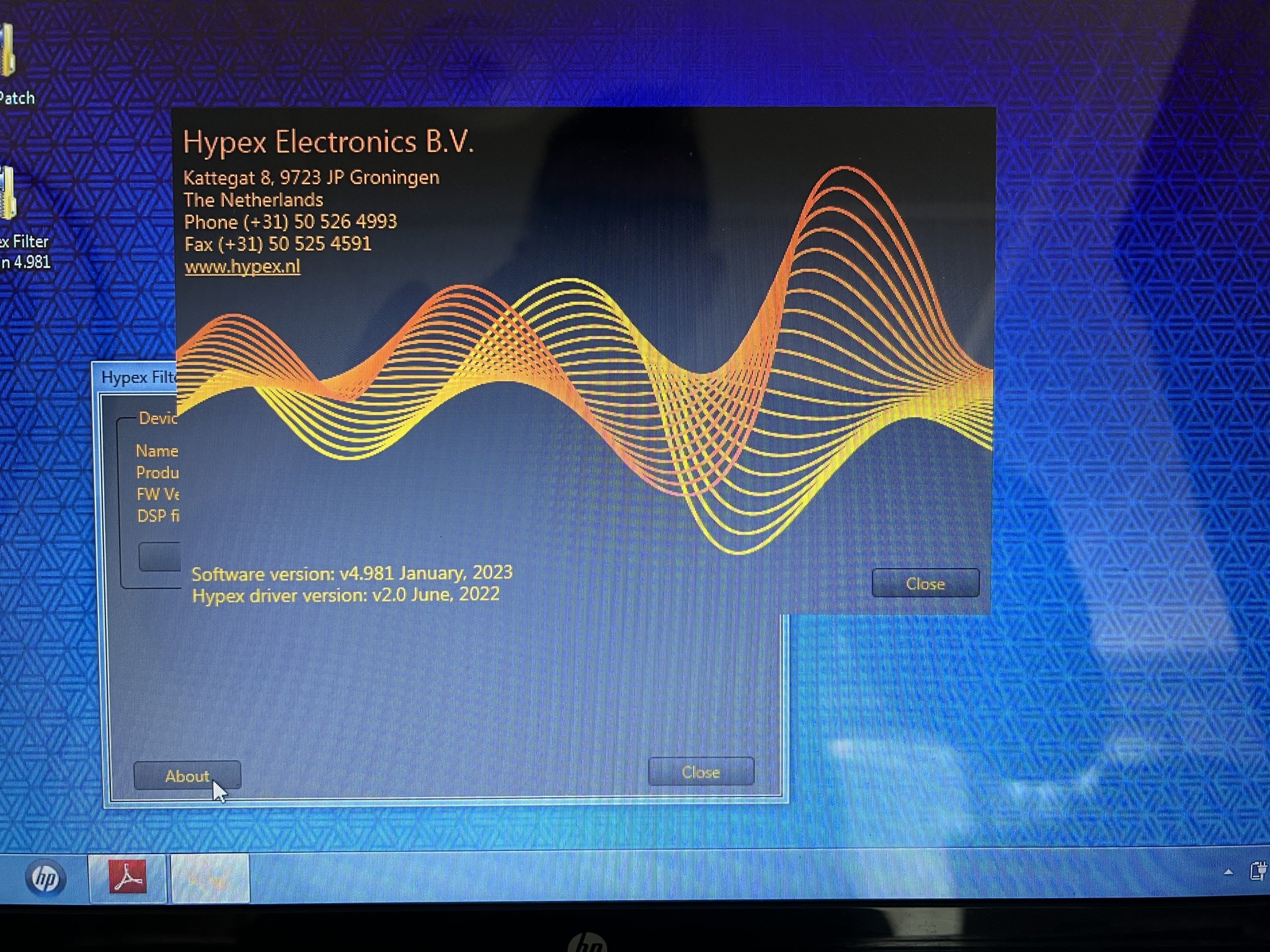

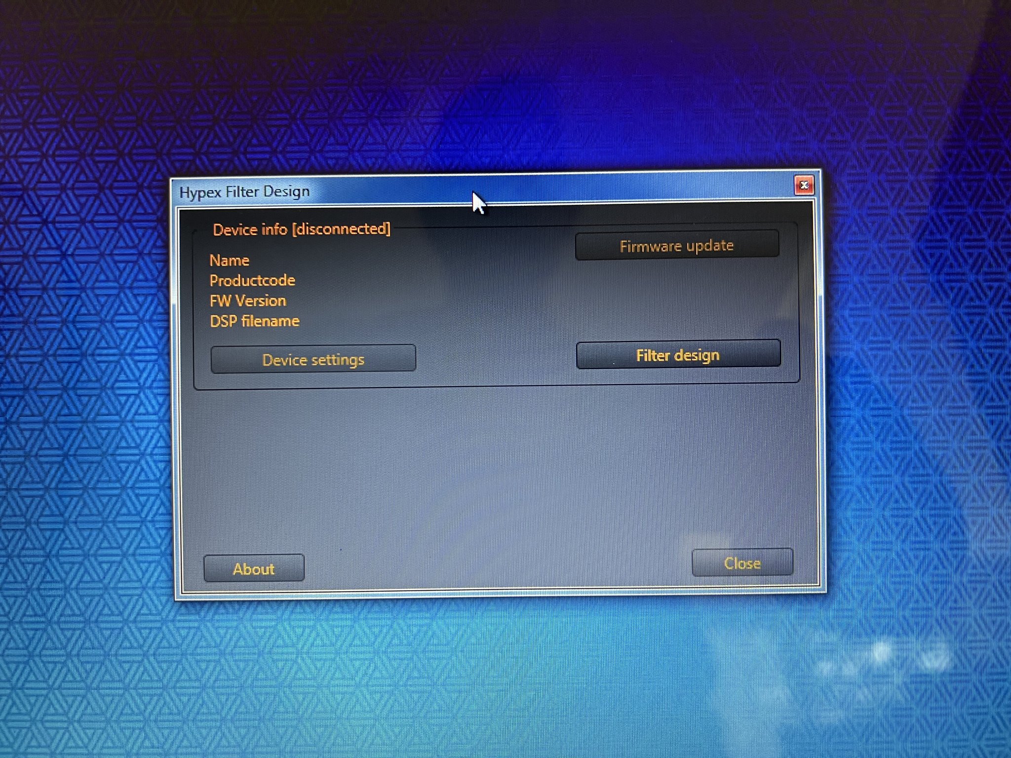

I recently came across a pair of PSC2.400 at a nice price. I always seem to have more than one project dragging out at a time, so I picked them up.
I’m having a somewhat similar issue that I encountered with one of my FA502 amps when I was setting those up.
HFD won’t recognize that either of the PSC2.400 are connected to my computer at all. I can’t change any settings or do any programming…dead in the water.
As I said, I had previously had an issue with one of my FA502. But I believe that it was just related to the fact that HFD couldn’t identify the specific model amp being programmed. I was able to change its settings and program it if I recall correctly. I ended up reaching out to Hypex and they sent me a file of some sort to fix the issue.
I was trying to change the PSC2.400 settings so they are not bridged (previous owner used them this way) so each amp module can be sound checked separately. I would have also reset the filters etc…maybe just set a high pass at 30Hz to get a signal through all the modules and do a sound test.
Any idea why HFD won’t recognize these amps when I plug them in and turn them on?
I have HFD version 4.981 installed on an older HP laptop running Windows 7 Home Premium which I have used successfully with the other pair of Hypex amps I own (FA502).

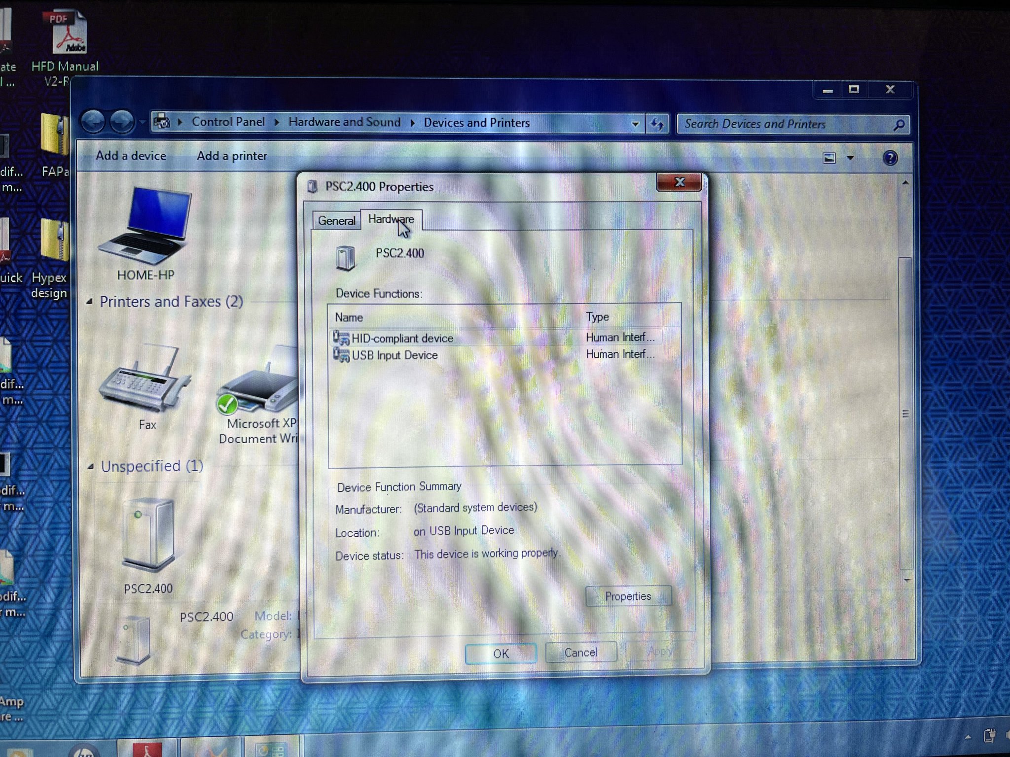

Windows installs drivers successfully when I connect and power on both PSC2.400 amps. I confirmed that the amp is listed in Devices and that it is functioning properly according to Windows.
I did some Google…Troels Gravesen had a “how to” page relating to these amps. He said don’t plug them into the computer until after they are powered up and HFD is running.
I tried powering the amp on with the USB cable disconnected…starting HFD prior to connecting the USB cable.
It makes no difference, HFD doesn’t display any information about the amp or allow me to access and change any settings.
I’m not sure if I need to try updating HFD to version 5.0?…or if this problem requires other action.
The seller told me that both of these PSC2.400 have the latest firmware installed. I was glad to hear that, I had a problem with another unit I tried to buy locking up after I updated firmware.
I decided to just hook them up to a test speaker in bridged configuration to see if I could get sound. They both worked. However it sounds like the gain is really dialed back.
I attached some screen shots showing HFD and what I see in Windows under devices.

Disregard…figured it out
Tried an old version of HFD.
Got a prompt that there was a newer version of HFD available on install. Updates listed stated legacy support for PSC was discontinued for version 5.0…evidently the same applies for the 4.98 version I was running.
Managed to get 4.97 installed and working with the older amps.
